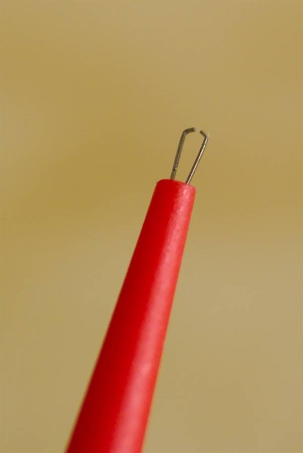

Review of probes
Before properly diving into the review, it is worth pointing out the probes that come with this multimeter. Agilent describes the 34461A as coming with a test lead set, which is essentially two probes with some very nice accessories. The probes are fairly standard, with nice sharp tips and silicone cables, but have a nice high quality feel to them. However, it is the accessories that really stand out for me. Included are two fine tip probes, two SMT grabbers and a single mini-grabber, with all of these fitting over the end of the main probes. The fine tip probes
are primarily meant to be used for use on PCBs, due to their length and small contact size, with them being ideal for SMDs (such as measuring the value of a surface mount resistor). Their length make them a little tricky to use at first, but you get used to them quite quickly. The SMT grabbers are what I find myself using the most.
Despite their name, they are ideal for clipping onto the ends of wires and component legs. The mini-grabber,
only comes in black and so I believe it is meant to hook onto the ground of a system. Unlike the SMT grabbers, it has a right angled contact, which doesn't always clip securely onto things, such as cases and shields.

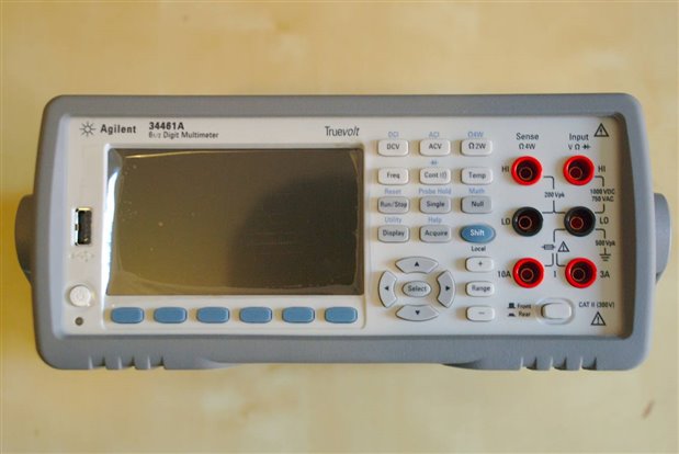

Build quality
The multimeter has a very high build quality and feels like it can take quite a high level of abuse. The buttons on the front panel are made from rubber and have a nice feel to them. Additionally, the connectors, on both the front and back, feel like they will last a long time with frequent plug insertion and removal. Overall, I cannot fault the build quality of the 34461A.
Layout and interface
The layout of the multimeter is logical with the probe connections being in the typical orientation format (sense inputs on the right of the main inputs). The mode buttons are logically grouped, although I would have prefered a separate voltage and current button, rather than an AC and DC button.

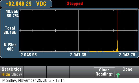

Histogram
The histogram view is incredibly useful and I like how it is not dependant on the reading memory, with it instead using 400 bins internally. This means that it is not limited to 10,000 readings and instead can go significantly higher (although I don’t know the exact limit). This is particularly useful if you want to see how a measurement varies over time, as you could leave the device on for many days collecting data. The histogram works very well and I have three issues with it. The first can be seen in the following image.
When there is a sharp peak in the histogram, the rest of the histogram tends to zero and so becomes very difficult to see. To help in these cases, it would be nice if a log scale button was introduced, so the histogram could be redrawn with a logarithmic frequency. The second issue is that you can not change the number of bins used without it clearing the data. Whilst I understand that changing the range of the histogram requires it to be cleared, choosing between using 400 or a 100 bins shouldn’t, especially when the data is stored as 400 bins internally. This can be seen through using SCPI commands, as ‘CALC:TRAN:HIST:ALL?’ returns 400 bins despite how many bins are specified on the multimeter or the number of measurements. And the third issue is that you cannot get the histogram data from the multimeter without using USB, LAN or GPIB. Which seems, to me, to be a very odd omission as you can use the front panel to save the reading memory to a flash disk, but not the histogram data.
There is currently a bug with the histogram view, that hopefully Agilent will fix quickly, where the histogram does not update when the multimeter is not triggering. Unfortunately for me, I found this out whilst characterising a pack of resistors (see this blog article Practical use of the Agilent 34461A). Whilst the data had been correctly placed into the bins, the display instead showed the following.
The histogram incorrectly displays the data from a previous set of current measurements, whereas the numerical display and the statistics are for the resistance measurements. This was a little disappointing, as I am surprised that no one had come across this before, however, Agilent did confirm that this was a bug in the firmware within a day, or so, of me reporting it to them. So I can only hope that a firmware update will be available in the near future.
Update : Agilent have given a date for the next firmware release. As this isn't a critical bug and the development teams are busy with new products, they have said that a new firmware version will be released in December 2014. Whilst I appreciate the work involved in fixing the bug and testing the firmware, I am a little disappointed that this date is so far off (the rep informed me of this date in February) and that fixing a bug takes almost a year. After the initial quick response and acknowledgement of the issue, I was expecting a new firmware version to be released considerably faster.
