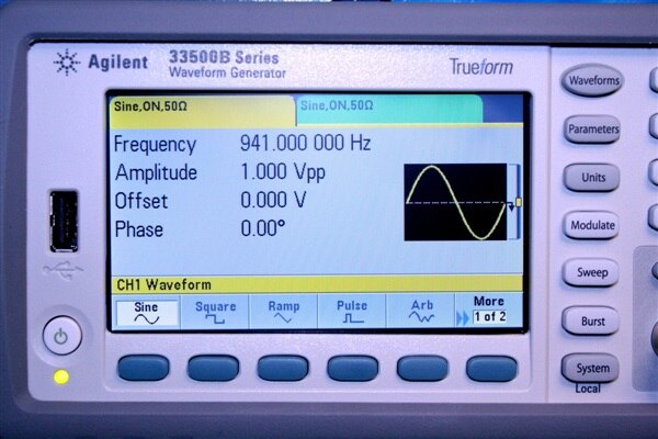

The LCDs used on contemporary Agilent test equipment like the 33522B, and on the 53230A Frequency Counter are bright, colourful and crisp.  To my eye they use highly readable fonts (that can be changed to a larger point size if desired).  Unfortunately, my first minor disappointment with this instrument occurred just after the LCD was illuminated.  As can be seen in the photograph below, the LCD is mounted every so slightly crooked, with a small, but annoying tilt to the left.  The image below shows the large point font.  The faint vertical lines that may be evident in the photograph are strictly an artifact of digital photography.  Visually the display is free of artifacts and appears pleasantly smooth and evenly illuminated.
Figure 3  LCD screen.  Notice slight left tilt to the display.image
