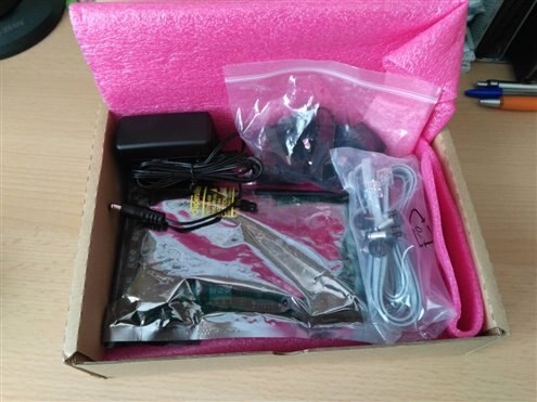

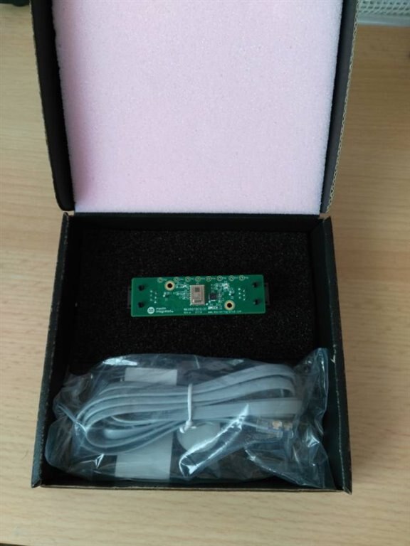

The 2 kits arrived in an element14 box, nicely protected in bubble-wrap. Inside, each kit had its own box.The small black box was for the MAXREFDES131#, and had the Sensor Board and a RJ11 6P6C 2m long cable, while in the bigger one for the MAXREFDES130# there was: the Building Automation Shield, another RJ11 6P6C 2m long cable and the 24V power supply, complete with interchangeable plugs (EU, UK, USA, AU).
MAXREFDES131#:  The board is based on the Panasonic AMG8833 GridEYE Infrared 8x8 Array Sensor (I2C slave device). This sensor is the 3.3V High performance type – High Gain model and, according to the datasheet, should give us a 0 °C to 80 °C temperature range for the measurement, with accuracy of +/- 2.5 °C,  resolution of 0.25 °C and a human detection distance of 7m or less. The view angle of the sensor is 60°, both vertically and horizontally. This view angle, at the max detection distance, offers a whopping max coverage area of 49m2 for human detection, which is rather good, especially for industrial application, where it is more common to find high ceilings (the max coverage area is a square of 7m x 7m, and can be fully exploited if you can install the sensor on a 6m high ceiling, facing the floor). Nevertheless, even in a non-industrial installation, like office blocks, shops or domestic areas, where the detection areas needed are typically smaller, the GridEYE still has plenty of uses.

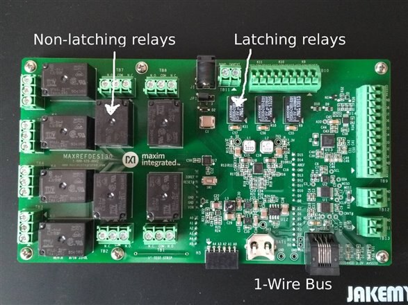

MAXREFDES130#: At the heart of this rather big Arduino-compatible shield, there is the versatile MAX11300 programmable mixed-signal I/O device (PIXI),  which allows the board to deliver eight 0VDC-10VDC analog outputs, one 4-20mA output, one 4-20mA input, eight non-latching relays (controlled via the MAX4822 8-channel driver), three latching relays. There is also a Real Time Clock, provided by the DS3231 (optionally can be powered with a CR1220 3V battery), and 1-Wire master, provided by the DS2484. Both ICs are I2C slave devices, controllable by the Arduino host.

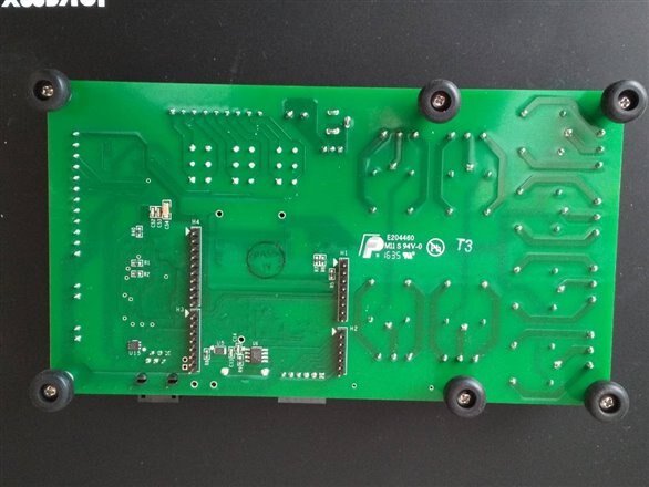

Looking at the back of the board, it is clear that the kit, although Arduino-compatible, has not been designed to be used as a shield for Arduino Uno itself. Infact, when you plug in the Uno, the USB port shorts some of the latching relay's soldered pins. Good job I had some double-sided tape laying around: just stuck some on top of the USB port and problem solved!imageimage

Unlike for the GridEYE, the demo for the Building Automation Shield requires a bit more work for the setup. For the testing, I am using 2 digital multimeters, a breadboard, 8 green LEDs, 3 yellow LEDs, a 5V power supply and a few wires.
First, lets compile the demo firmware. Detailed information on setting up the demo are provided in the Quick Start section of the online documentation. To be able to compile the demo sketch, the following libraries need to be installed as .ZIP files (they can all be found on GitHub - links provided):
  • OneWire: APIs to manage the 1-Wire master. This library should be already installed (used for the GridEYE demo)
  • Max11300: APIs to manage the PIXI device, which controls all the I/O ports and the latching relays
  • MAX4822: APIs to manage the non-latching relays
  • RTClib: API to manage the DS3231 Real Time Clock
Once uploaded the freshly built firmware, opening the serial monitor (setting the speed to 57600 baud/sec) will start the demo. The first task is to calibrate the current source/sink, by connecting the current source port to the current sink port, with the digital multimiter in series, to measure the current flowing. The calibration process needs to be repeated both for the lower current (4mA) and the higher one (20mA).
The video shows the result of a sequence of commands sent from the demo, to set some non-latching relays (the green LEDs), then set all, unset all and finally set/unset of the latching relays (the yellow LEDs).
I will skip the test of the RTC and move onto testing one of the eight analog output voltage ports and the analog output current port. Setting the port AO8 to 3.3V and port AIO to 10mA via demo causes the digital multimiter to read the following from the ports (as shown in the photo):
