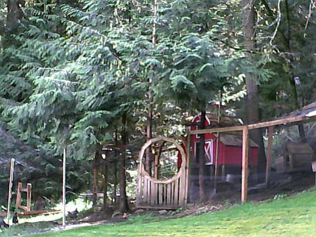

The location for this road test is a small homestead on the side of Tiger Mountain in Washington State USA.
The place is wooded with many predators. So the coop is outfitted with a Raspberry PI and cameras.
The Raspberry Pi sends data to a MySQL database and the data is available on a web page
As you may see, the Raspberry Pi controls exterior lights and the coop door.  The lights come on for
5 minutes if the PIR detectors see something.

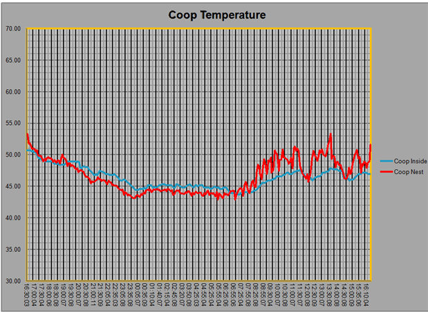

Also available are daily and weekly graphs of the temperatures recorded by a DHT22.
The intent of the road test was to compare these temperatures with the temperature of a nest box to see if a hen is brooding.  With a brooding hen
on the nest, that temperature will rise while she is on the nest.
I wrote a Python3 program to record the temperature and humidity and call it as a cron job on the Raspberry.
The deadline for submitting the report was coming up and fate and chicken temperament stepped in and they tore up the
nesting boxes for rebuilding of the nests which they do every now and then so the following comparison chart is ambient
temperature. The DHT22 as I have it in the coop has a large thermal mass while the TI is much more sensitive to fluctuation
as this comparison chart shows:
