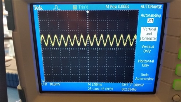

Sine wave generator
Since I'm reviewing the board, and not specifically the chip or environment, I thought I'd look into ease of use a bit more. I started with this example: http://www.cypress.com/?docID=54184
It wasn't set up for the newest version of PSoC creator. That's good in a way, it gave me a chance to see how much trouble it would be to update it. Fist I replaced all the outdated components with the new ones:
Then I found it neccesary to go to Project>Update components, in order to update the CY_BOOT device that was still giving me trouble. Perhaps doing this before swapping components would have accomplished the same thing
Having done that I was able to upload it and get this sine wave
It was such a weak signal that I decided to replace the pattern and see if it changed and thus wasn't just some kind of RF noise.
So I commented out the sine wave and replaced it with more of a square wave like so
//    uint8 sineTable[32] =  {127,152,176,198,217,233,245,252,254,252,245,233,217,198,
//                    176,152,127,103,79,57,38,22,10,3,0,3,10,22,38,57,79,103};
    uint8 sineTable[32] =  {0,0,0,0,0,0,0,0,0,0,0,0,0,0,0,0,254,254,254,254,254,254,254,254,254,254,254,254,254,254,254,254};
And got this
It did change, but it seems I'm running too fast for the DAC to change, so I got a triangle wave. [Edit, I've just realized that I had the timer period set too long it was 256, not 12 because when I replaced the timer I didn't set this]
Here's what the sine wave looked like after I set the timer correctly
The frequency checks out; 4.8MHz / 12 (counts) / 32 (samples per wave) = 12.5 KHz
