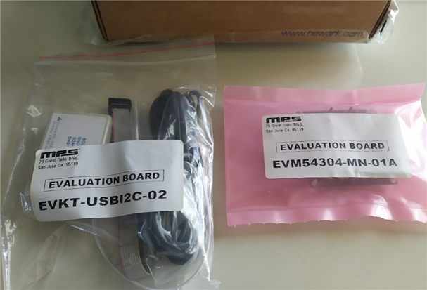

Shipped Package, Unboxing:
The package came decently-packed and contained everything as promised. The package came under DDP (Delivered-Duty-Paid) terms so I did not have to do anything in the process other than receiving the package at the gate. Since the package shipped from Element14, I'd say credit for this excellent execution goes to Randy et al image.

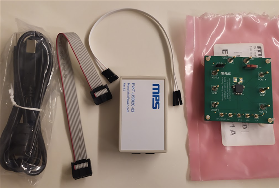

The package included the following parts:
- Evaluation board EVM54304-MN-01A
- USB-I2C device kit (EVKT-USBI2C-02) including:
   - USB to I2C communication device
   - USB cable
   - Ribbon and jumper cables
The kit did not come with a printed quick-start guide.

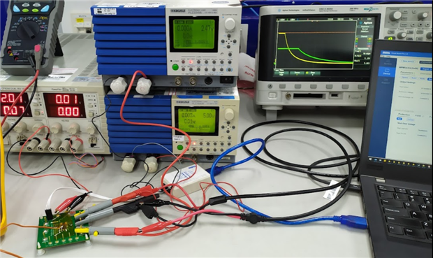

For lab tests, I was lucky to get permission to use some nice equipment at my workplace-lab (for which I am very grateful!).
I used the following equipment in my tests:
- TTI CPX200 bench power supply
- Kikusui PLX334W Electronic Loads
- Fluke 52 II Thermometer
- Agilent DSO-X 3024A oscilloscope with 10:1 probes
- A concoction of cables and clips
- A multimeter
Unfortunately, the number Electronic loads and oscillocope probes available to me were limited to 2 each, so I decided to do the tests with Channel s1&2 in parallel, and Channels 3&4 in parallel. This reduced my outputs to 2 voltage rails, but at higher power sourcing capacities.
Here's a picture of my test setup:
