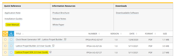

4. Download the Diamond software
  • I had already installed Diamond IDE for the OrangeCrab review and I had already started on the tutorial.
  • But I used  the LCMXO3L-6900C-5BG256C
  • So i used this version of the IDE

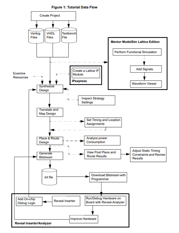

      • I learned that the programmer is different for the Mach03LF a Flash based option as opposed to the MachXO3L a NVCM Based option.
      • The following flow really helped me understand the complicated toolchains of the IDE. I pulled it directly out of the tutorial document, because it depicts the who process. I'll be refering to this as I learn more about the toolchain.
      • image
        • The solid arrows point to the major execution flow of the basic strategy used to build and embed the HDL to the board.
        • The dotted arrows point to task that can be used during development and analysis of the program logic of your design.

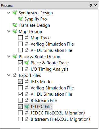

        • You should generate a .jed file instead of a .bit file.
        • Here are the strategy process tree showing the solid arrows depicted in the flow diagram above
        • image

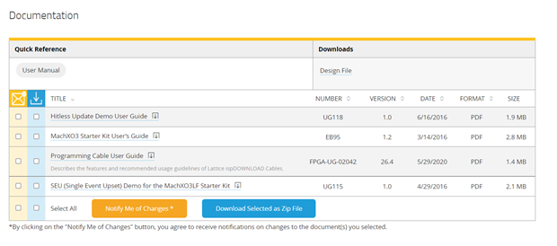

Experiment# 2 - SEU (Single Event Upset) demo for the Mach03LF Starter Kit
      • This section describes my second experiment with the Mach03LF kit.
      • The pdf document introduces the example as:
        • "This document provides technical information and instructions for using the Single Event Upset (SEU) demo design from Lattice Semiconductor. This demo demonstrates the functionality of Soft Error Detection (SED) and Soft Error Correction (SEC) using the MachXO3LF starter kit. This document provides a description of the demo design as well as instructions for running the demo. The demo design makes use of Lattice Diamond® software feature of Soft Error Injection (SEI) to induce an SRAM bitflip error. This error is then detected by the FPGA SED feature running on the board. Finally, the demonstration shows the MachXO3LF device’s ability to correct the inserted error (SEC feature) without interruption of the user function."

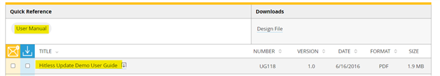

      • What I did, was to download the following 2 resources from the "Documentation" section on the https://www.latticesemi.com/xo3lfstarte Page.
      • image
      • User Manual section - the following PDF file
      • Design File section - the following Zip file
      • I unzipped the demo to my local drive and opened the PDF file.
        https://www.latticesemi.com/view_document?document_id=51669
      • I followed the instructions in the document and  took these videos of my results, since the document did not include any result videos

      • To run the demo, download the following 2 resources (Instructions and Files) from the "Documentation" section on the https://www.latticesemi.com/xo3lfstarte Page.
        • Be aware that the Documentation Table has two Tabs that you have to navigate to 1." User Manuals" and 2. "Design Files" to get the instructions and code files for the demo. As describe in the picture below.
        • image

2. In section 8, I could not run the Programmer within Lattice IDE as I have for my other experiments?
          • The .XCF file is crossed out for both implementations and the programmer widget reports an error trying to find the file?
          • I was able to exit out of the IDE and Run the Stand alone Programmer as described in Section 7 "Running the Demo".

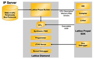

    • Here is a block diagram of the 3 Lattice Toolchains
      • Propel Builder
        • Using Local and Server IP, the Propel Builder is used for SoC design, then to export the RTL to the Diamond IDE. And the CPU description, memory map and Drivers to the Propel SDK tools for software development.
      • Propel SDK
        • Once proceed by the SDK tools, the executable code is sent to the RTL in Diamond to allow it to run on the SoC design.
      • Diamond IDE
        • Then the RTL is processed and analyzed by running thru the Synthesis, Place & Route Design, and Programmer to create the Bitstream to the MachX03LF
        • Debugging can be implemented with a JTAG Server into the Reveal Debugger.

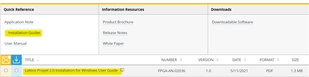

    • If you already have Diamond IDE installed and Licensed, you will still need to Get a license and install it to the license directory pointed to by Environment Variable LM_LICENSE_FILE. This will not affect the use of Diamond. You will still be able to run all 3 tools with the Propel License.
    • Install the software using the manual downloaded from the "Software Downloads & Documentation" section of the Propel page
    • image
    • Or click this button Lattice Propel 2.0 Installation for Windows User Guide

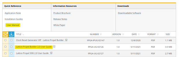

    • An easy to use system IP integration environment, Propel Builder provides tools to integrate processors and peripheral IP. The graphical integration environment features an easy-to-use, drag and drop correct-by-construction methodology. All commands are Tcl scriptable.
    • Get the Builder user guide from the  "Software Downloads & Documentation" section of the Propel page.
    • image
    • Or click this button Lattice Propel Builder 2.0 User Guide
Lattice Propel SDKimage
    • A seamless software development environment, Propel SDK is a software development kit (SDK) with an integrated industry standard IDE and toolchain. The SDK features SW/HW debugging capabilities along with software libraries and board support packages (BSP) for Propel Builder defined systems.
