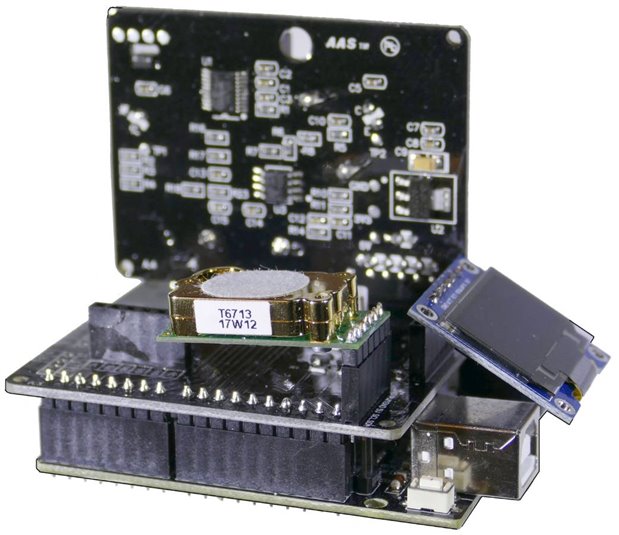

The Sensor Evaluation System supplied by the Amphenol Advanced Sensors Group kit is a complete system that includes fully integrated hardware - sensors, MCU and display.  The kit includes everything needed to test the sensors, except a power supply, but it can be plugged into any USB port to obtain power.
The arduino UNO also comes pre-loaded with demonstration firmware so here is a video that shows how the kit is assembled and what it does when power is applied.
Assembly & Power Up Test Video
There were a couple of things that surprised me with this kit:
The first surprise is that hardware kit is a complete system that just plugs together and it includes an OLED display. In fact the main micro controller card, sensor interface card and OLED display arrived already plugged together, only the sensors had to be plugged in.
The second surprise is that fully functional software comes pre-loaded on the host micro controller. Surprising because it is a 3rd party micro controller card. This software reads all the sensors and displays their values on the display.
So overall, the system was amazingly easy to set up and start taking readings.

An AAS Arduino UNO (ASS-AQS-UNO)
The MCU provided with the kit is a standard Arduino UNO in most respects but it is branded as AAS (Amphenol Advanced Sensors) and it comes with a pre-loaded air quality demo program.
This makes working with the evaluation kit super easy, allowing more focus to be on sensors and data than getting an MCU to work. Presumably I can try flashing the code available on GitHub onto a standard UNO to see if it works before editing the code or erasing the original demo. (there are several versions available on GitHub)
Note that the dust sensor pulse signals require a pin change interrupt library.
One thing I want to try is to see if I can split P1 and P2 signals into separate readings.
Another thing I want to explore is sending data out via Bluetooth.
If and when I attempt these enhancements, I will update this road test.
An AAS Sensor Evaluation Shield (AAS-AQS-UNO)
The AAS Sensor Shield breaks out the UNO signals to sensor-specific connectors, making the whole system plug-and-play. There are a couple of transistors to make I2C work with a 3.3 volt device. There are also some extra connectors including Bluetooth and VOC sensor (volatile organic compounds).
This card can plug onto any Arduino UNO compatible connector MCU which means it should work fine with many MCU cards from various manufacturers.
An OLED display
The included display is a 96 x 64 monochrome OLED. (cyan)
It runs off 5 volts and uses I2C for communication.
AS you can see in the above videos it does a nice job of displaying sensor data.

  • Thanks for your positive comments Doug, rewarding to see it positively received.
    A couple of points to note, whilst experimenting you can remove unnecessary sensors (exception dust) as the code checks to see if they are there, and only displays those it finds at start up. So whilst testing dust remove the CO2 and Temp/Hum sensor and it'll only display dust values.
    The dust sensor should have the tape over the cleaning window, as this helps induce a convection air current over the sensor between the upper & lower window. It also makes the sensor slightly more accurate as it reduces incident light getting to the photodiode. The sensor works by sensing the reflected light pulse amplitude from particulates, bigger particle = bigger pulse, it can be observed when you see a shaft of sunlight through a window making dust 'sparkle' - we count the sparkles. In general terms the colour codes follow the US EPA guide for PM 2.5 value.
    The code is available on github, I note you've looked. By commenting out the OLED and commenting in the serial port the output can be datalogged with rograms like PuTTy, Coolterm, or the like, and then imported into Excel or the like. We had to do it this way as the UNO crashes if both are available.

    I have been comparing the CO2 sensors, although it is difficult to know when they are seeing the same conditions. I didn't include any competitor data because this road test is about Amphenol Advanced Sensors. However, I can say that the way they are set up the Amphenol sensor is more sensitive and it has a larger range. It also has slightly better accuracy according to the data sheets.
  • Attaching peripherals by just a few SIP header pins is definitely not a very rugged solution. I will be printing a 3D housing for the system to stabilize and protect all the modules and I will post it here. In preparation I have carefully bent the display pins so I will still be able to see it when there is a sun shade above.

  • Excellent review - I was interested reading about the varied sensors. The CO2 sensor in particular looks really useful.
    It's a neat idea piggy-backing it on a Uno clone. Gives a platform that can be instantly used, but also lends itself to very easy experimenting and development.
    I think I'd be a bit concerned about the physical arrangement of the OLED display - I could see that getting broken. If I'd been doing it I think I might have considered some kind of simple plastic support to give it some protection.
    I look forward to your experiments with the smoke/dust sensor. That's the most intangible of the measurements, so it will be interesting to see how much sense you can make of the readings you get.
