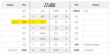

What were the biggest problems encountered?: Using the MikroE connector with a Relay Click Board. I was unable to get this working. I was able to finally get it to work but the documentation was giving a wrong pin assignment, which caused the problem. Also no Guidance in the Documentation on how to work with the MikroeE connector.
Detailed Review:
Updated 10/08/2021 -- I was able to get the MikroE Dual Relay Click working.

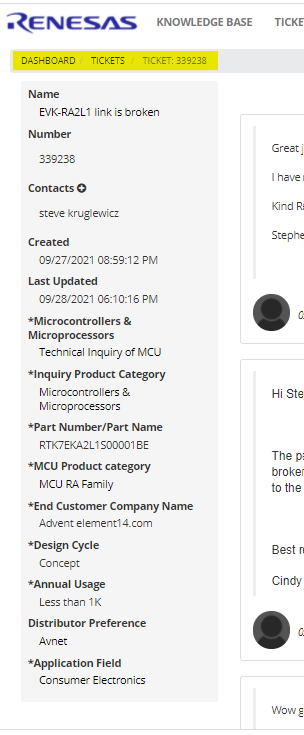

NOTE: This page link is not found
I found the following link to display the kit page:
https://www.renesas.com/us/en/products/microcontrollers-microprocessors/ra-cortex-m-mcus/ek-ra2l1-evaluation-kit-ra2l1-m…
9/26/2021 Logged a new Ticket with Customer Portal.
Updated
9/27/2021 Customer Support suggest using the above link for the broken link on the card. They have a request into the department responsible for fixing the broken link.
9/28/2021 The link on the card has been fixed. Fast turn around for an issue in the documentation.

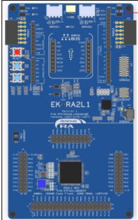

This section describes the board layout of the Kit. These photos were taken from the EK-RA2L1 v1 – User's Manual and are described here for review purposes.
EK-RA2L1 Board Functional Area Definitions
  • The Board is divided into two functional areas that are unique in all Renesas RA products.
    1. System Control & Ecosystem Access Area -- features Power, Debug MCU, User LED and buttons, reset, ecosystem connectors, USB Full Speed Host and Device, Boot configuration.
    2. MCU Native Pin Access Area -- features RA MCU, breakout pin headers for all MCU I/O and power, current measurement
  • the following figure points out the location on the board, for these 2 areas.
    • image
  • The next photo, describes the access points on the top side of the board.
  • Notice the location of the mikroBus Connector. This is where I'll be pugging in my MikroeE relay click board.
    • image
System Control and Ecosystem Access Area (Upper Half)
  • The following figure shows the System Control and Ecosystem Access area on the EK-RA2L1 board.
  • Subsequent sections in the Users' Manual, detail the features and functionality provided in this area.
    • image

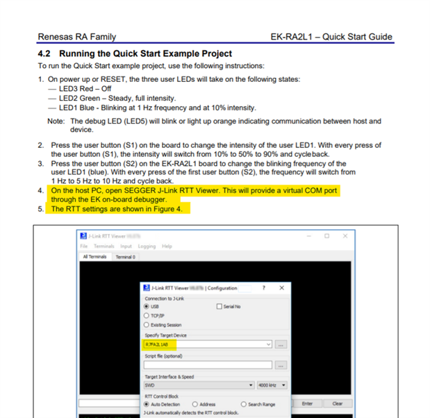

      • When you plug the USB cable in for the first time the Quick Start Example will run.
      • Follow the flow of the example and try to press the different switches
      • you will be doing the RTT connection in the next section.
    • Section 4 requires but doesn't explain how to install the following:.

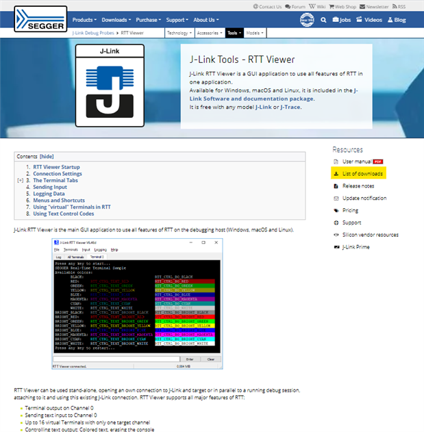

        • SEGGER J-Link® USB Serial Drivers

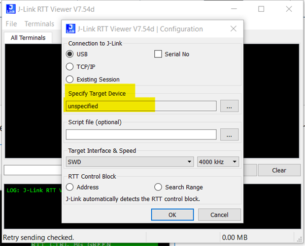

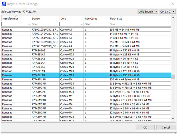

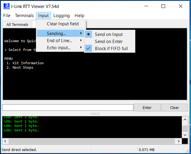

        • SEGGER J-Link Real-Time Transfer (RTT) Viewer, virtual terminal emulation application. It is included in J-Link Software and Documentation Pack which can be download from segger.com
      • Since the examples in section 4 require the SEGGER Drivers and RTT viewer, and the introduction section 1.1.1 states
      • "Tool experience: It is assumed that the user has prior experience working with IDEs such as e2 studio and terminal emulation programs. The examples in this guide will use SEGGER RTT."
      • I do have terminal emulation program (PuTTY & Tera Term) experience, but not with SEGGER RTT Viewer.
      • So, I decided to "Google It" and came up with information on Downloading, Installing and Running it, that I've placed in an Appendix at the end of this review.
      • So, if you have never used SEGGER RTT Viewer and are interested in using it along with the example, skip on down to Appendix A -- SEGGER J-Link RTT Viewer.to get instructions on where and how-to download and install it for windows10.

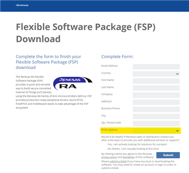

          • Click on the "Download the Latest FSP v3.3.0" button to download the windows installer from this page
          • image
          • The last textbox is a dropdown, with 3 options
          • image
          • I was interested if the choses made a difference in the size and the RTOS used in the FSP. I downloaded 2 different versions , selecting AzureRTOS for 1 and FreeRTOS for the 2nd one. There was no difference in the size. I installed the AzureRTOS. and I shall see if it makes a difference.
          • Click on the installer exe to install. Note: you might want to "Run as Administrator". However I ran without and haven't run into any problems yet.
          • I also did not install the Drivers when asked, because I assume they are already installed with the SAGGER package. We shall see.

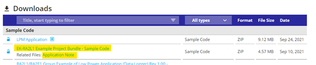

        • Section 5.2 -- Describes the Downloading and importing the Quick Start Example Project
          • Start by going to the EK-RA2l1 page renesas.com/ra/ek-ra2l1
          • Scroll down to the highlighted links described below.
          • image
          • Follow the rest of the steps 1 through 9 to get the example project into the e2 studio IDE

        • I modified the Menu options that are sent to the J-link RTT Viewer and was able to get the program to use the RED LED instead of the BLUE one.

The Flexible Software Package
  • In this section, I'll describe how I used the Manual to teach myself what FSP is all about.
  • First off off the FSP PAGE on the website, contains FSP Downlead, User Manuals, Documentation. Feature set., Downloads and Videos.
  • I downloaded and reviewed the documentation.
  • Download FSP Manual
    • The FSP manual is also online at Manual Online
    • The online manual can be read from any browser. A very convenient feature over the downloadable PDF version.
    • This manual describes how to use the Renesas Flexible Software Package (FSP) for writing applications for the RA microcontroller series.
    • Key chapters to read in the manual

      • image
      • It contains the USB drivers and RTT Viewer and a whole lot more.
      • For Windows 10 , I downloaded the Windows "64-bit installer"
    • Before plugging in the USB to PC,
      • check windows Device manager and note the drivers in the Universal Serial Bus controllers section. I've done reviews on many kits , so I have a ton of USB drivers installed. Your installation will be different.
      • Now plug the USB cable To the PC.
      • Now note that a new driver is present "J-Link Driver"
      • image
    • Now to Run SEGGER RTT Viewer on WIndows10
      • Go to the Windows10 Start Menu , Scroll down to the "SEGGER - J-Link" folder. in my case I have V7.54d.
        • image
        • Under the folder , scroll down to the button below to start the viewer
        • image
        • The instructions in the user guide in section 4.2 (Refer to Picture), instruct to use the "Specify Target Device" as "R7FA2L1AB"
        • image
        • But when you open the RTT Viewer, the "Specify Target Device" indicates "Unspecified"
        • image
        • You will need to click on the button to bring up a list of devices,image
        • image
        • Press OK.
        • My experience was , I did not to have to perform steps 7,8,9 in the quick Start Guide because it was already set.
        • image
        • At this point I followed steps 10 through 13 to complete the RTT viewer section of the Demo Example.
        • This completes the installation, setup and running of the SEGGER RTT Viewer with the demo example.
Appendix B -- Support Portal Example Ticket
The Dashboard
  • The dashboard ticket page with the "My closed Tickets" screen
  • image
  • Select a ticket to view.
Ticket Example
  • Ticket information is display along the left side of the screen and the comments are scrollable to the right of it as described below.
  • image
Appendix C1 -- Pin access on the MikroE connector (NOT WORKING)
10/04/2021 --- I'm stuck at this Point. I will keep working on a solution.
  • Here is my first attempt to use use the MickroE click Relay board.
  • I read the resource material and tried to figure out How to access the The CS pin on the MickroE BUS connector in the "System Central & Ecosystem Access" section of the board. This Appendix describes my steps.
  • the Relay click is very simple in that it sets the CS pin to HIGH the turn on the relay and LOW to turn it OFF.
    • I used this relay click board in another roadtest.
      • What I had to do was look at the schematic to determine the pin routing from the CS pin to the pin on the MCU on the board.
      • Then I modified the Blinky example to toggle that pin instead of the LED pin.
      • It worked fine.
      • I assumed, I could do the same for this board.
  • Going to the resources available on the website.
    • I found the reference to the CS pin  in the  EK-RA2L1 v1 - User's Manual  In section 5.3.5. The Page is pictured below for reference.
    • image
    • I referred to "Table16. mickroE Connector"
      • The row for the CS pin (highlighted) the signal is on P103. This is what I used to lookup the pin in the FSP configurator Described below.
    • Then in the FSP configuration viewer, on the "Pins Tab" I found the CS pin information displayed below. by clicking on P103
      • I did not change anything on this page I assumed it was all set.
    • image
    • I modified the hal_entry.c code as follows
      • Added - include "r_ioport.h"
      • Added - the define for led pin to BSP_IO_Port_01_Pin_03
      • I tried the following 2 module methods:
      • Used call for BSP write and it did not work
      • So I tried R_IOPORT_PinWrite(&g_ioport_ctrl, RELAY1, pin_level); and that also did not work
    • image
I'm stuck at this point and need to answer some questions.
  • I'm stuck at this point and need to answer some questions.
    • What am I missing?
    • Is there another Module I need to add?
    • Am I using the right API?
    • How do you reference a pin on the access area of the board?
    • Is it like the LED pin reference in Blinky?
New Appendix C2 -- Pin access on the MikroE connector (WORKING)
  • I was stuck with getting this to work, but a discussion,  I started on the Renesas Forum finally helped me to get this to work.
  • The short of it, is that the documentation is wrong. The wrong PIN is given for Relay2 CS pin. It specifies Port/Bus: P103, but the member in the forum pointed out that it should be P104.
  • I simply configured the P104 pin in FSP configurator and changed my code to use P104 and it worked!
  • So, i will be deducting a point for documentation and adding one for Support.
What I did, to get it to work
  • Here is how I documented my response to him on how I was able to get my code to WORK!
  • The documentation  is incorrect in the manual, EK-RA2L1 v1 – User's Manual
  • In section 5.3.5 the CS connector is described as connected to P!03 SSLA0
  • The CS pin is for Relay2 (It's a dual relay click) as described in the MikroE  I not sure about Relay1 which is on pin PWM and described a pin/bus P400 (GTIOC6A) , P400 seems to work as defined using the BSP function.
  • It should be P!04 (SSLA1). for SPI channel 0.
  • I'm using FSP 3.3 and when I create a project and use the project Template "Bare Metal - Blinky"
  • P104 is marked "Not Assigned" and the Mode is marked "Disabled" and the "Symbolic Name"  value is blank.
  • But No problem.. I change the value In Mode to "Output Mode (initial High)", the P104 changes to GPIO..
  • I also fill in the value for "Symbolic Name" as "RELAY2". This will be used in the code to reference this pin in the IO fuction.
  • When I change my code to use P104  the RELAY2 works fine on the MikroeE  click board
  • NOTE: RELAY2 is defined in the FSP configurator for P104 in the value for the "Symbolic name".
  • If you use the BSP function R_BSP_PinWrite() the first arg is defined locally.

Questions Answered from Appendix C1
    • The documentation was giving the wrong port for the CS pin image
    • NO
    • YES the R_BSP_PinWrite() and the R_IOPORT_PinWrite() both work
    • Is always nice if the documentation is correct. I tested the Relay1 and the Pin assigned is working with either functions above.
    • Yes using the same functions but a correct pin works.
