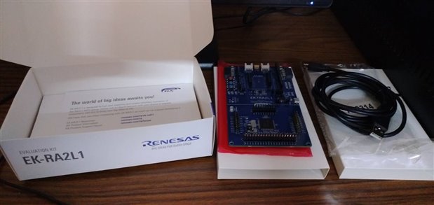

UNBOXING:
I would like to start with unboxing of product given for testing. It came in nice white box with two enclosures, one contains USB cable & another one with EK-RA2L1 evaluation kit as shown below in photographs:  image
