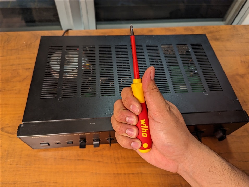

To test the out-of-box experience I used the screwdrivers to disassembly and assembly again a Rotel stereo amplifier.
This amplifier has a lot of screws in the bottom, back and inside. Different sizes but all of them are Phillips.
I used all of the Phillips screwdrivers, but I like more the #2 because of the handle size and it can hold the screws, even that the head is not magnetic.
The disassembly was 17 minutes, and the assembly was 22 minutes, the extra 5 minutes was because I used the 4 Phillips sizes, when for those screw sizes it would be better to use only #2 or #3.
Phillips #2
Disassembly:
Assembly:
These screwdrivers are easy to use, the handle has good proportions for every size. In general, they work as expected.

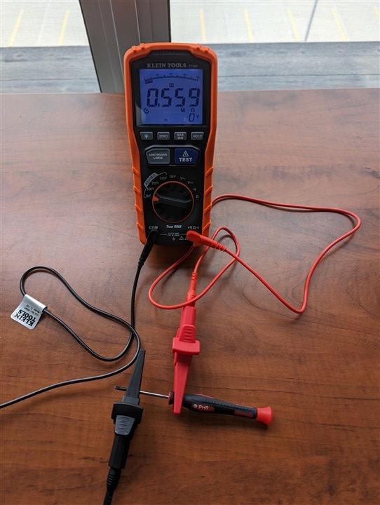

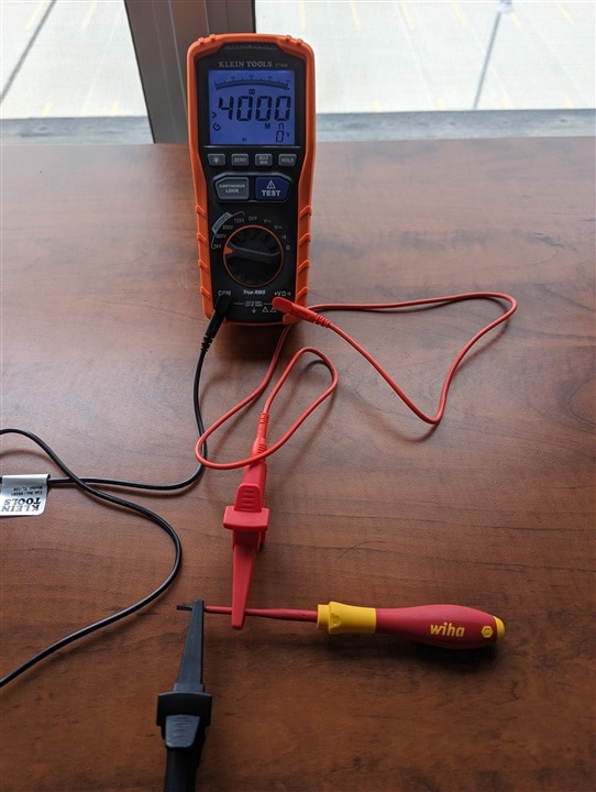

I use an insulation tester to measure the resistance of the screwdrivers.
I tested using 1000V setting, I got a reading of 4GΩ+ on all of the Wiha screwdrivers, anything above 100MΩ is excellent.
In order to get the insulation value that Wiha tested, I would need to use a better insulation tester capable of testing at 10,000V. But is good to know that it has an excellent insulation resistance at the rated voltage (1000V).
Wiha Screwdriver being tested
For reference, I tested a cheap no brand non-insulated screwdriver, I got a reading of 559KΩ which is bad.
No brand non-insulated screwdriver being tested
