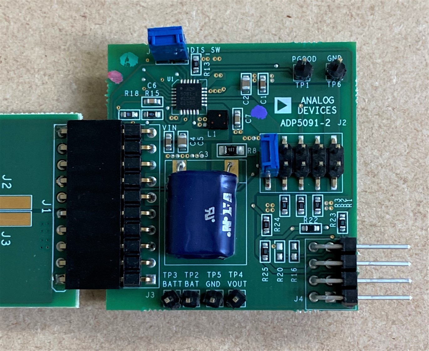

Unfortunately, there was an issue with the Alta PV board that I discovered when I initially started testing.  I was getting very intermittent voltage values from the PV cells that were inconsistent with the variation in light conditions.  The Alta PV cells appear to be mounted to the PCB using conductive epoxy and under close examination I noticed that one end of the attachment was fractured along the epoxy joint.  Fortunately, Randall was able to get a replacement sent to me within a week, so there was minimal impact to the review timeframe.  I wasn't able to get a specification for the PV board or the Alta cells, so I'm not sure why conductive epoxy was used rather than solder.

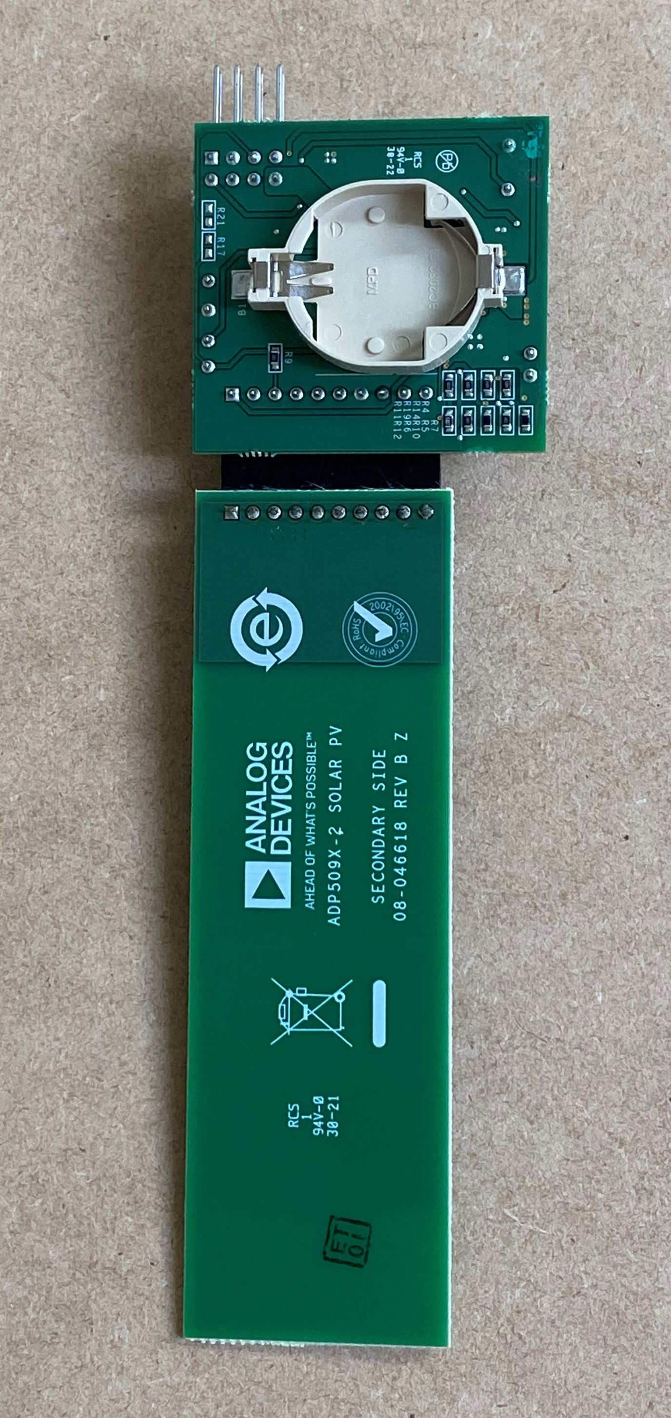

Top of Eval Board Set
Bottom of Eval Board Set
Closeup of Harvesting board
Cracked conductive epoxy connection
Evaluation Board Operational Description
The block diagram below shows the configuration of the evaluation board set.  The Alta PV cells are on one PCB and the energy harvesting circuitry is on the other.  This makes it convenient to use alternate energy sources (different PV cells, piezo, or thermoelectric generators) with the harvester.

Eval board
0.1 F supercapacitor for energy storage
Regulated output with jumper programmable output voltage (2.5 V, 2.8 V, 3.0 V, 3.3V)
External resistor dividers with preconfigured operating thresholds for plug and play operation with low voltage PV cells
CR2032 Backup Battery holder

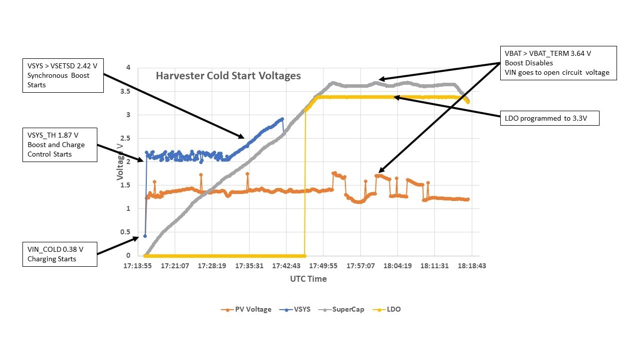

Fast Cold Start-up Circuit (VSYS < VSYS_TH, VIN > VIN_COLD)
Initially, when VIN < VIN_COLD, the harvester circuit is off (low light, VSYS < VSYS_TH).  When VIN > VIN_COLD (0.38 V), the capacitor on the SYS pin begins charging (cold start).  When VSYS > VSYS_TH (1.87 V), the main boost regulator and charge controller start working.  When VSYS > VSYS_CHG (2.19 V), the storage element on the BAT pin starts charging.  If VSYS < VSYS_CHG (with hysteresis), the storage element stops charging and VIN returns to charging the VSYS capacitor to ensure it does not enter cold startup.  If VSYS < 0.08 V, it returns to cold startup.
The sequence is illustrated in the figure below:

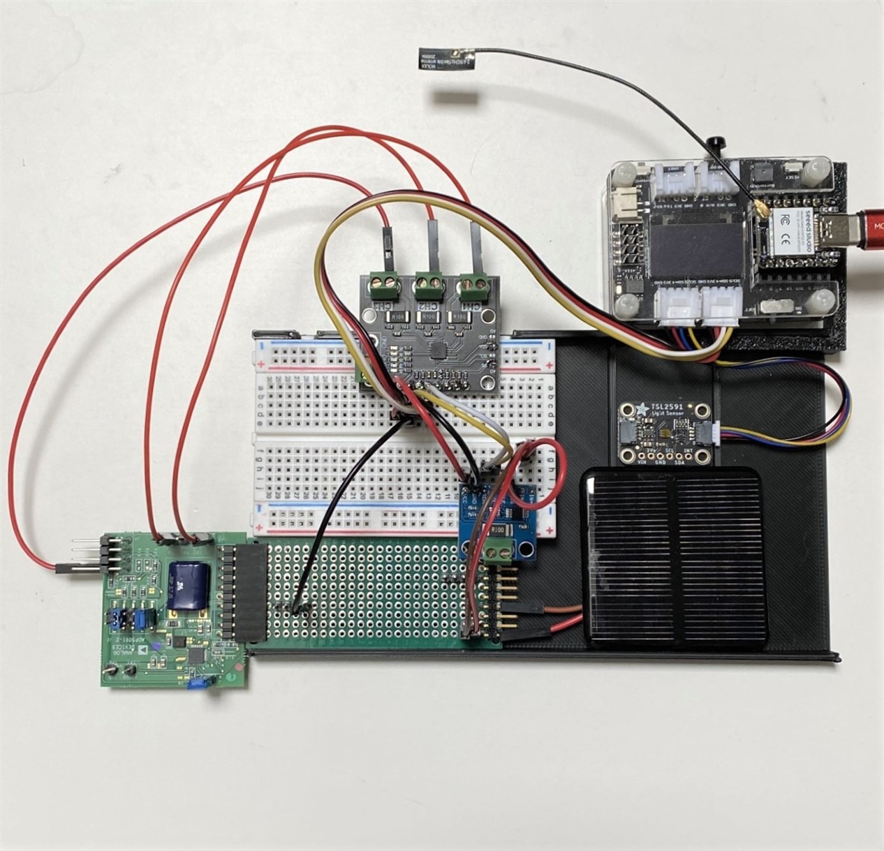

Test Setup
Hardware
In order to evaluate the Energy Harvester operation, I created the test setup shown below using a 3D printed baseplate:
The setup uses a Xiao ESP32S3 MCU to monitor and upload the following sensor information:
  1. PV cells voltage and current using an INA226
  2. Harvestor SYS, SuperCap, and LDO volatges using an INA3221
  3. Ambient light value (visible, infrared, lux) using a TSL2591
All sensors are interfaced via I2C.  The Xiao uploads MQTT data via WiFi to a Node-Red Dashboard and an Influx database.  The Xiao also displays debug info on an OLED display.  The Xiao and sensors are powered separately from the Harvester circuit using USB or a USB power bank.
The TSL2591 is not calibrated and I don't have a calibrated reference or source, but I'm hoping that the Lux computations from the visible and IR sensors are reasonably close and it will give me a relative measure of the available light plus allow me some degree of repeatability for my test data.

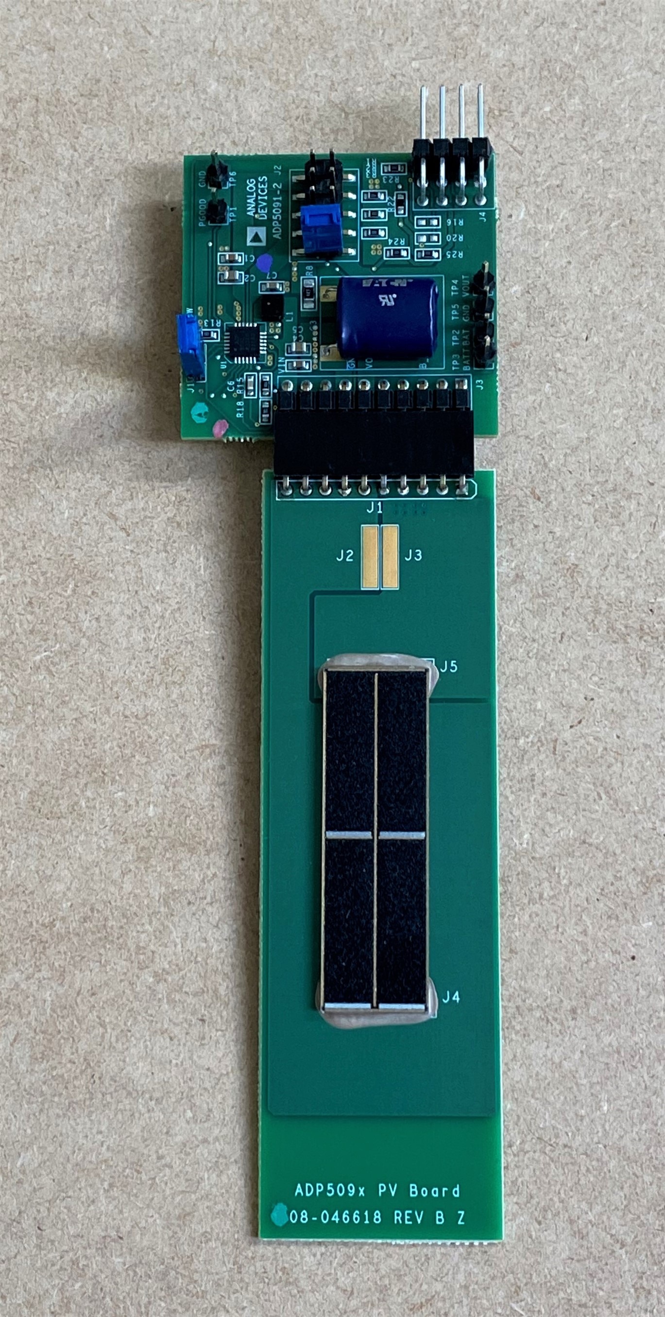

I am using two different types of PV cells to test the harvester, the Alta GaAs cells provided with the evaluation kit and generic monocrystalline Silicon cells that I purchased from Amazon (I've used these in outdoor project).  Unfortunately, I don't have detailed specifications for either of the cell types.  The Silicon cell assembly output is described as 2V @ 160mA.  I have no specific information on the Alta GaAs cells - there was no information provided with the kit.
From general information that I obtained from searches for single junction cells, the GaAs cells should be more efficient that the monocrystalline Silicon cells - (21% vs 29%).  GaAs cells also have lower leakage current and lower temperature coefficients, so should perform better in lower illumination and higher temperture envionments.
The Silicon cell assemblies have larger surface area than the GaAs cell assemblies (1849 mm^2 vs 480 mm^2), so I would expect higher power available.  I don't have calibrated light sources, but Silicon panels are generally spec'ed at an irradiance of 1000 W/m^2, temperature of 25C and  perpendicular incidence angle.  I do have a calibrated irradiance meter, so I measured the two cell panels on a sunny day when I could get spec conditions.  Unfortunately, I don't have an SMU to generate a continuous load curve, so I just tested with fixed resistors (OC, 1K, 100, 10) to obtain the following plot.  The GaAs panel had a higher open circuit voltage, but a lot less available current (short circuit current looks like it might scale with the cell area).
I'll be using these cells indoors for testing the harvester, so there will be substantially less energy and the available light spectrum will be different.  Bright LED lights in an office might be able to achieve illumination values of 1000 Lux which is roughly equivalent to about 8 W/m^2.  From a 2017 conference presentation that I found I would expect to be able to harvest about 130 uW @ 200 Lux from a 10 cm^2 GaAs solar cell, so it appears that it will be extremely challenging to sustain an IoT sensor without a lot of power optimization.

For my initial tests to verify that my setup was working, I started with the Silicon PV module as the harvester input as it has a larger available current.
This test was done using illumination from a skylight above my desk on a cloudy day.  Indoor temperature was 24 C.  I started with the SuperCap discharged.
Here is the data displayed on my Node-Red Dashboard.
This is the same data extracted from InfluxDB and plotted in Excel.  When I started the test the illuminance was about 700 Lux which resulted a PV output of 1.4 V @ 1 mA and it later dropped to 300 Lux with a PV output of 1.2 V @ 0.4 mA.  The overlay shows the phases of the harvester operation.
Toward the end of the test, I applied a 10 K resistor to the LDO output (330 uA load).  This was in the lower illuminance phase (300 Lux), so that the PV input was not able to sustain the load and the SuperCap started to discharge.  When the LDO output reached 3 V it switched off (disconnected the load).  The SuperCap was then able to charge to allow the LDO to turn on temporarily, but the load would cause it to turn off.  The input power was about 0.5 mW and the load power was about 1 mW.  At 700 Lux the input power was about 1.4 mW, so that would have sustained the load.
