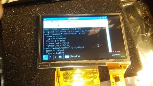

  • Hi Display Cape shows up plain white screen after booting Debian from SD card, i updated and upgraded to latest available libraries and lxde, do we need to change some settings in uEnv.txt for display cape? (or display have problem?) Thanks in advance image
  • Hi Trent,
    Did that worked out??
    Cheers,
    Sakthi
  • Hi Sakthi,
    Thank you very much for this suggestion. I will try this. My apologies for the typos in the previous comment. Having issues with website thru mobile Chrome browser.
    The bbcape43 firmware image is most likely the cause of the issue. It could possibly be the eprom on the display. I have tried to enable WiFi and Bluetooth without success. When connmanctl technologies is entered, it only returns Ethernet and Gadget.
    I will follow your suggestion of using the debian image from the BeagleBone site. Access to the wireless capabilities of the BBB Wireless and the small form factor of this LCD Display are of importance to the intended application. But if this is not possible yet, purchase of a BeagleBone Black might be necessary.
    Thanks for the suggestion. I will try this.
    Trent
  • Hi Trent
    I Understand the issue I know how hard it is when you hit a dead end on projects.As you have read through the documentations it actually states
    "Use of this LCD display product is initially intended for use with the Beaglebone Black host board. Support for use with other compatible Beagleboard variants will be provided at a later time"
    I think the problem is with the image, But still If you got enough time give a shot with the Debian 9 (I actually did the roadtest with it), I hope that should fix it. Keep us posted Trent.

  • I purchased the Element 14 BeagleBone 4.3 LCD Display for use with the BeagleBone Black Wireless.
    This was a mistake. The image provided by Element 14 for use with this LCD Display is not fully compatible with the BeagleBone Black Wireless.
    When the eMMC of the BeagleBone Black Wireless is flashed with the image provided for this BB 4.3 LCD Display, WiFi and Bluetooth are not detected on the BBB W.
    Ethernet is detected even though the BeagleBone Black Wireless does not have an Ethernet port.imageimageimage
