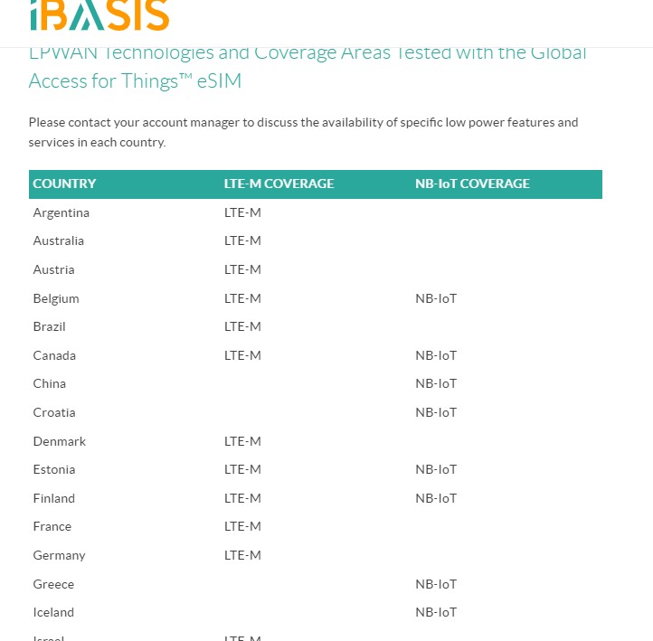

This road-test will review the nRF7002-EK WIFI-6 chipset and the nRF9160- Development Kit together with Nordic Cloud using a Basis SIM card. The kit I received contained the NRF9160, the nRF7002 and a Basis IOT enabled SIM card with 10Mb of prepaid data.   The nRF9160 DK comes with a pre-certified single-board development kit for evaluation and development on the nRF9160 SiP for LTE-M, NB-IoT and GNSS. The board also includes an nRF52840 board controller that for example can be used to build a Bluetooth Low Energy gateway. In Canada, the nRF9160 DK can be connected to either LTE-M or NB-IoT networks if equipped with an IoT enabled SIM card.

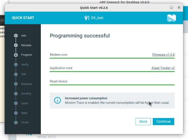

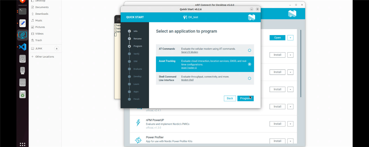

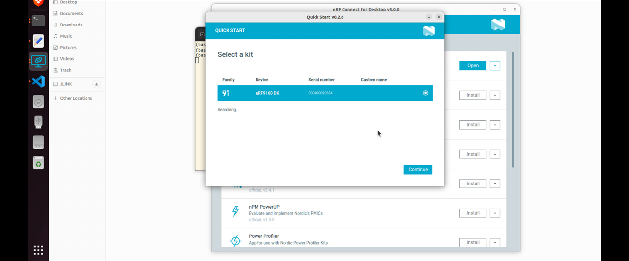

Next I installed nRF Connect for Desktop. This application allows to test the Nordic cloud using a GPS asset tracer application.
The pre-compiled package located  at https://www.nordicsemi.com/Products/Development-hardware/nRF9160-DK/Download#infotabs
contains all the following applications

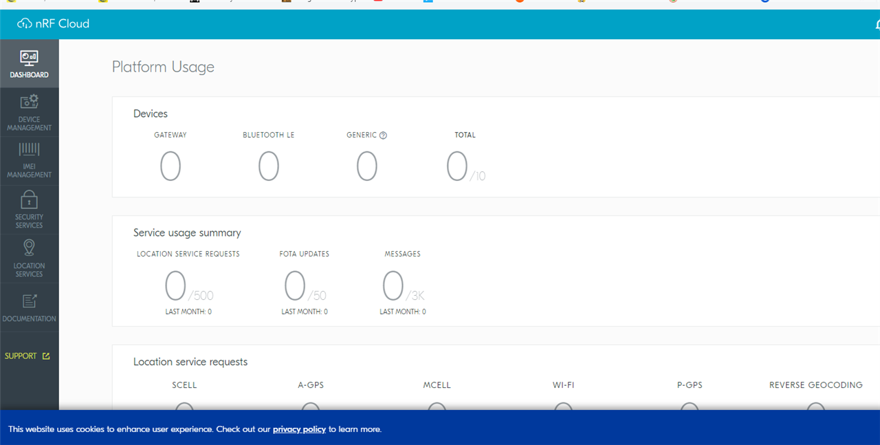

1. First register for the cloud access. Once registration is done you will have access to the dashboard below.
a) Go to nRF Cloud at https://nrfcloud.com/
b) Click Register
c) Next create an account by entering your address.
Fig 1. Nordic Dashboard

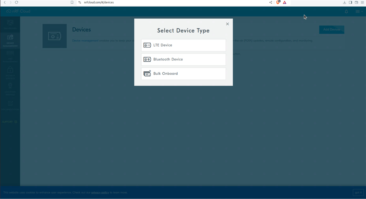

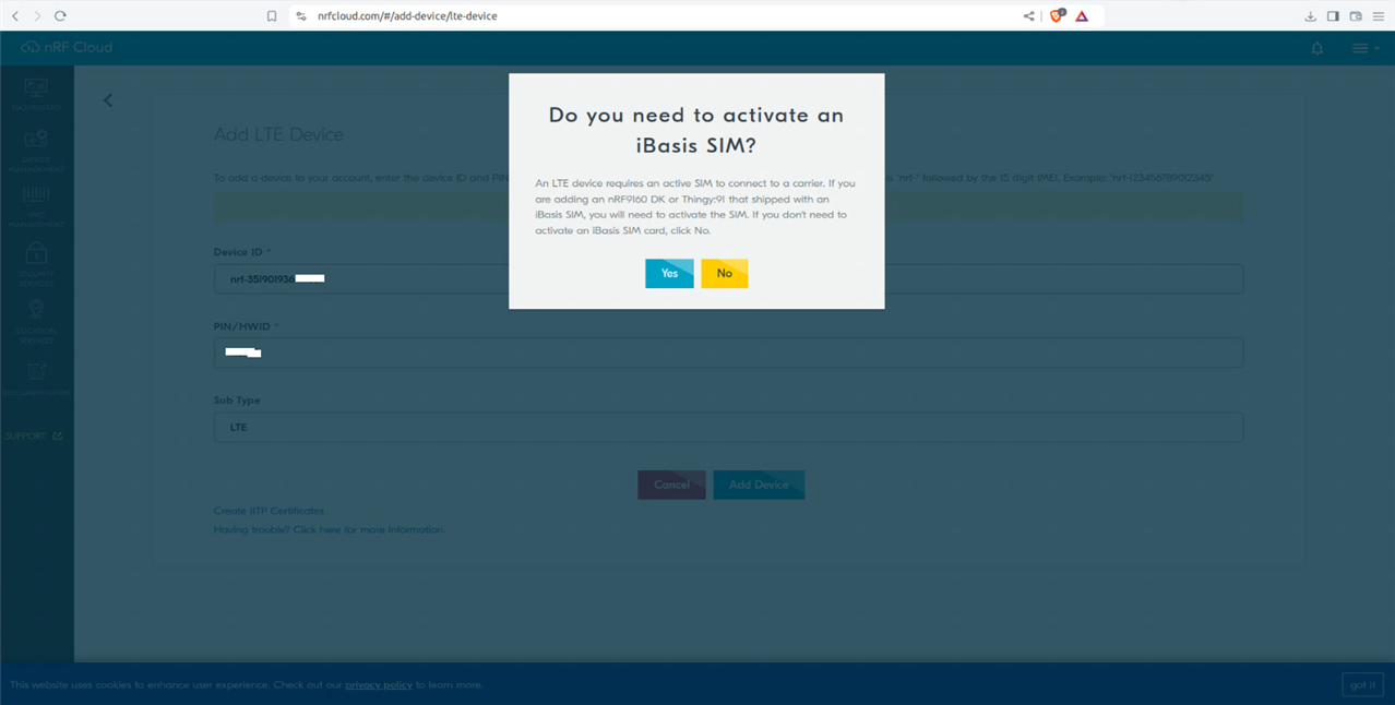

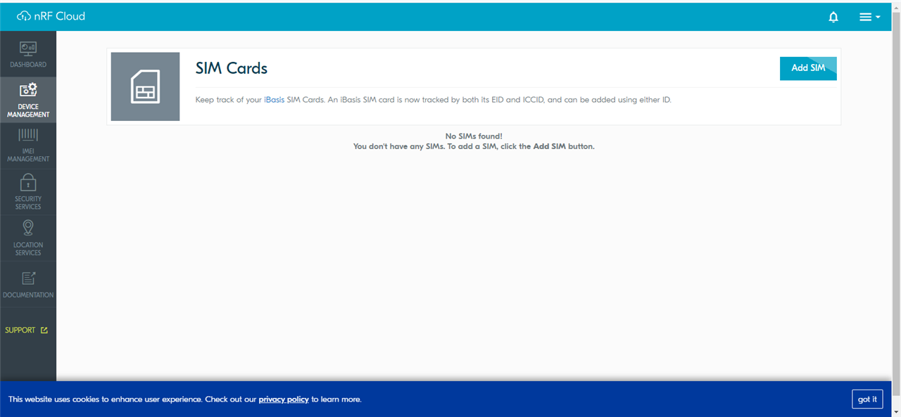

Next Add a SIM card.  Record the SIM card data and enter the micro SIM on the NRF9160 -DK.
Add SIM card
LTE-M and NB-IOT
GPS Tracking App
At this point you will be asked for the IMEI and PIN. These are located on the underside of the board of the nRF9160DK.
Same for the MAC of the nRF7002. It's located on the bottom side of the shield.

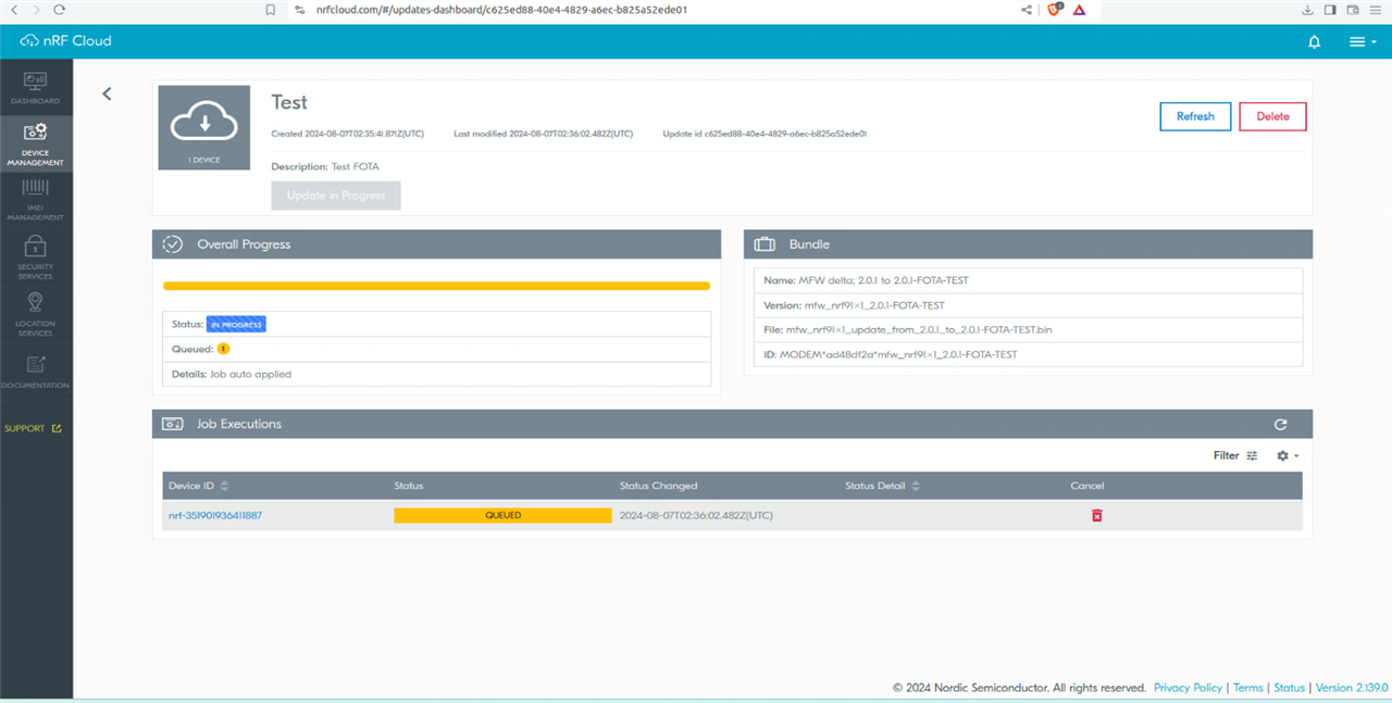

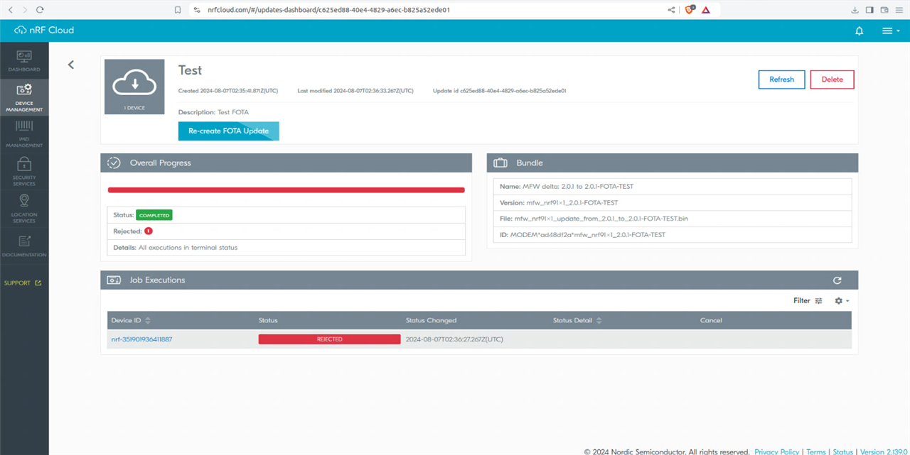

Firmware Over the Air Update (FOTA)
The Nordic cloud application supports updating the firmware of the nRF9160 DK board remotely via cellular radio. (LTE-M or nb-IOT).For this roadtest, a simple FOTA upgrade was tested.
The kit comes pre-loaded with the latest FW update so when downgrading it will not accept the downgrade binary.

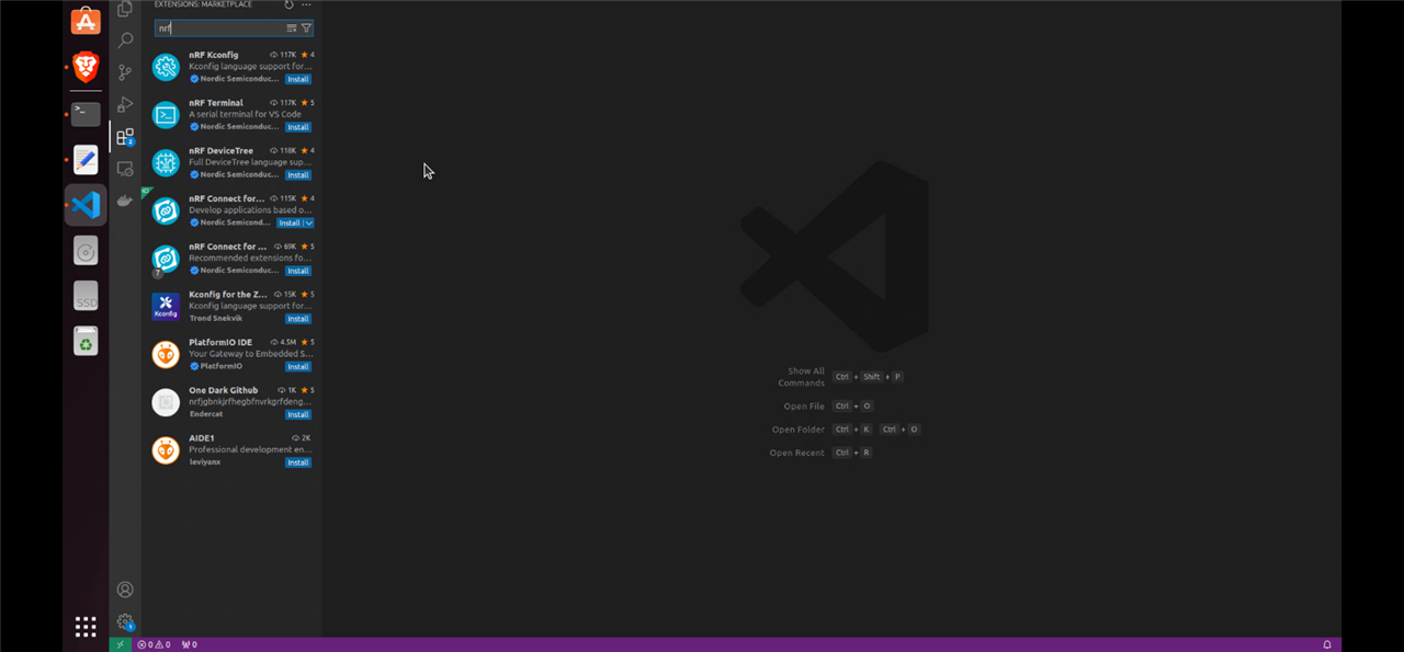

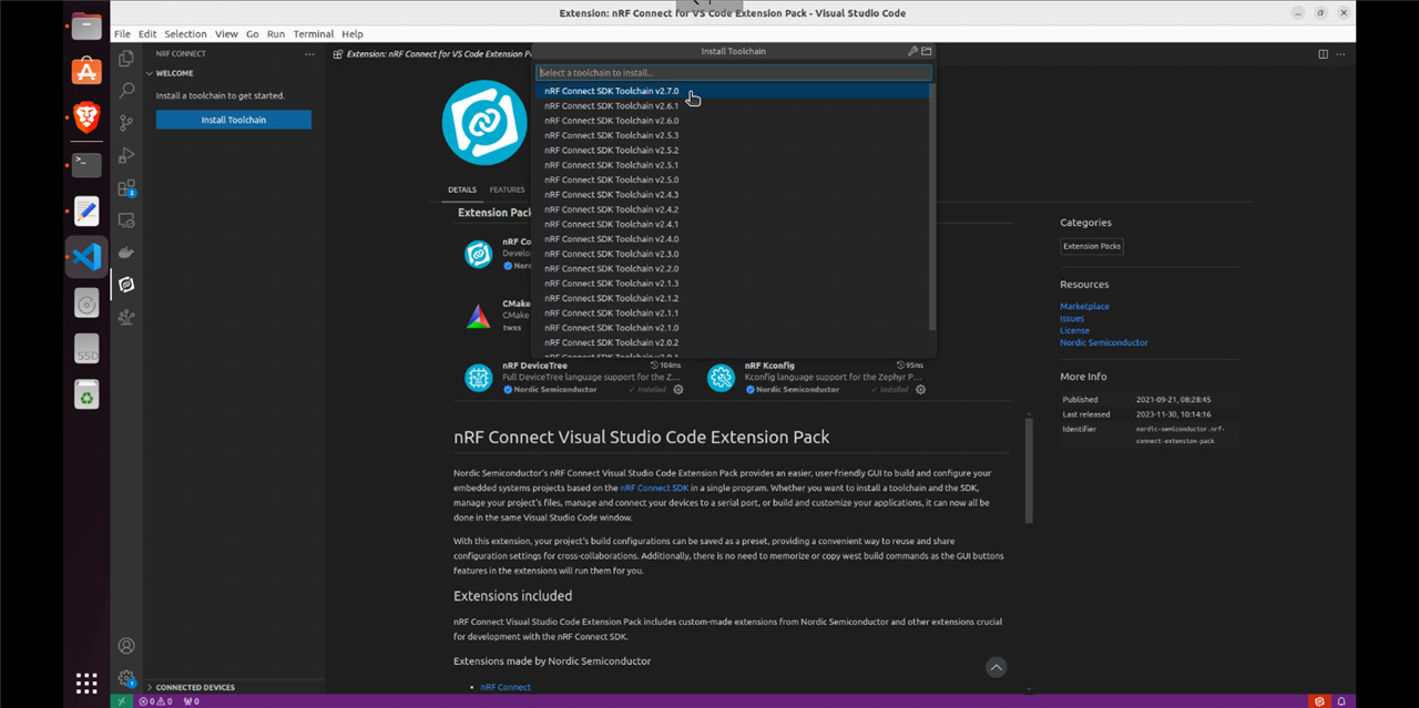

Custom app development
To build custom applications on this board one can use a number of IDEs with VScode or SNES being the most well-known.
For this application I tested one of the VScode example after installing the nRF extensions.
