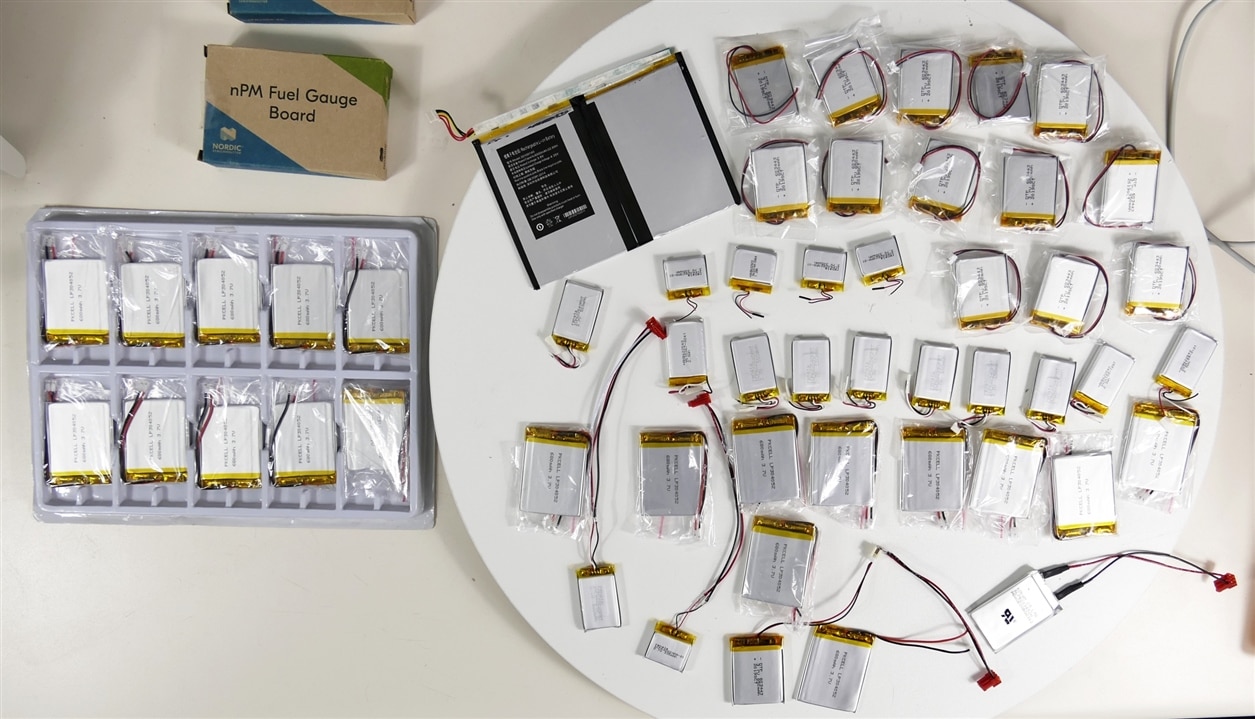

This is a road test of the Nordic Semiconductor  nPM Fuel Gauge Board, shown on the left above, plugged into an nPM1300 Evaluation Kit. This Fuel Gauge Board adds a constant current load capability to the power management system. Specifically the Fuel Gauge Board is intended to be used to discharge batteries during the process of characterizing battery discharge curves. Both the nPM Fuel Gauge Board and the nPM1300 Evaluation Kit were included in the road test kit which is important since the Fuel Gauge Board is designed precisely to work with the nPM1300 Evaluation Kit. I wanted to do this road test because together these modules provide the ability to characterize Li-Po batteries for capacity. I have quite a few Li-Po batteries of various sizes and ages and I want to know how well these old batteries perform relative to their published specifications. Some are at least 12 years old, but none have ever been used.
Li-Po Batteries
Here is a picture showing the batteries:

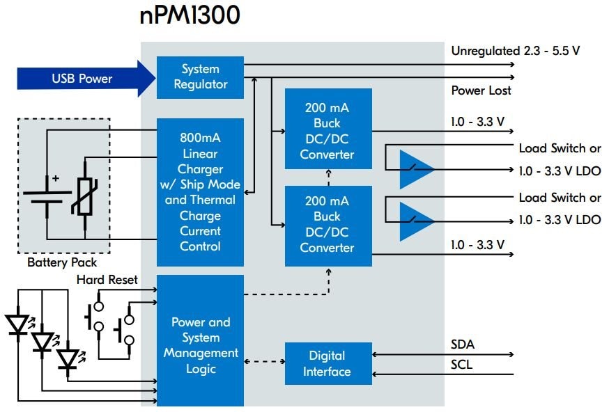

Although this road test is about the nPM Fuel Gauge Board, I have to mention some features of the nPM1300 power management IC (PMIC) and its evaluation kit (EK).
The nPM1300 is an unusually capable PMIC featuring
  • Ultra low power operation
  • Accurate battery fuel gauge (with host SoC/MCU)
  • Watchdog & boot timer
  • Power loss early warning
  • Button hard-reset
  • 800 mA battery charger (for Li-ion, Li-Po, LiFePo)
  • 4 controlled power rails
  • 2 efficient buck regulators (200 mA)
  • 2 load switches or LDOs
  • Input regulator (USB C support)
  • Ship & hibernate modes
  • 5 GPIOs & 3 LED drivers
  • I2C interface
I have never seem a PMIC with such an extensive feature set. Here is a block diagram:
There is significant complexity and configurability to set this chip up for a specific application but fortunately Nordic Semiconductor provides an  "nPM PowerUP" software application that allows graphical configuration of all aspects of the PMIC and even allows configurations to be exported for use in target applications.

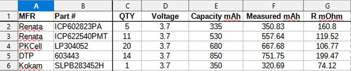

Battery Characterization Table
This table shows that the real battery capacity can vary from what is written on the battery. I noticed in this small dataset that the the older the battery was, the lower its capacity was relative to the nominal capacity specifications.
It is good to know that even the 12 year old batteries still perform at least close to their rated capacity.

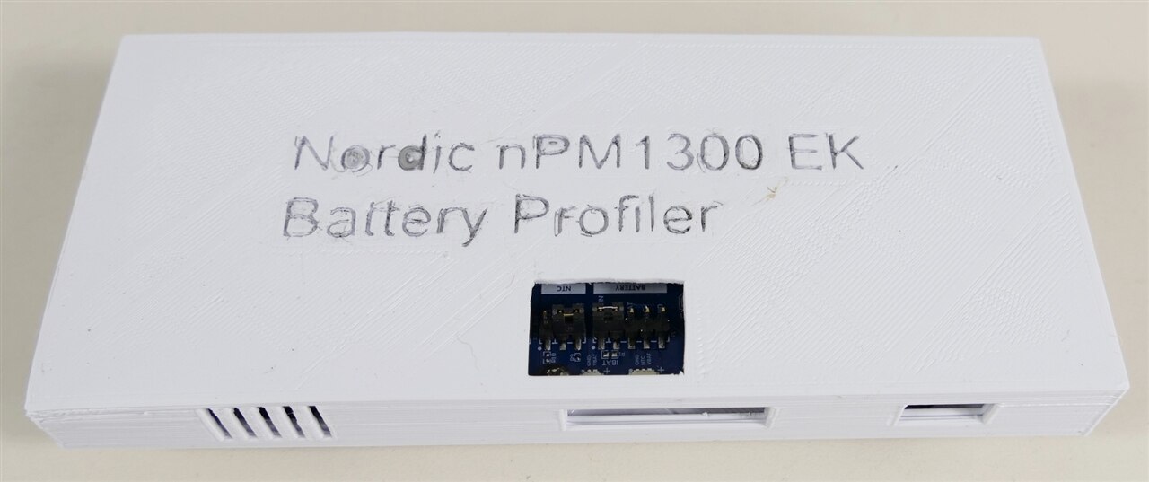

I used the hardware modules and software tools as-is, without needing to do any electronic or software development,.to implement a complete battery profiling system. I designed a 3D printed chassis to turn the setup into a complete instrument that I can use whenever I need to profile batteries, or indeed test other applications of the nPM1300 PMIC.

Battery Profiler Instrument
A 3D printed cover turns the system into a battery profiler instrument.
