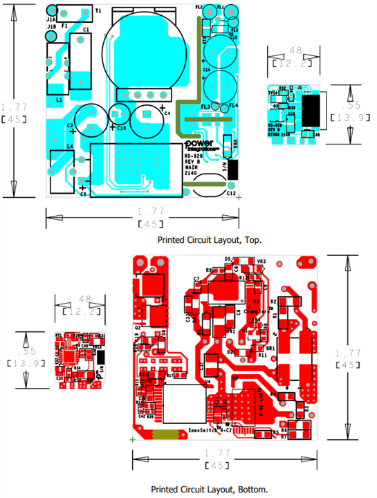

Examine the effectiveness of the PCB layout and component selection in ensuring proper operation and compliance with EMI/EMC standards. Verify that the 60 W USB PD 3.0 power supply in the RDK - 928 kit meets the specified electrical performance requirements, including input voltage range, output voltage accuracy, output current capabilities, efficiency, and ripple limits. Evaluate the power supply's performance under different load conditions, input voltages, and environmental temperatures.

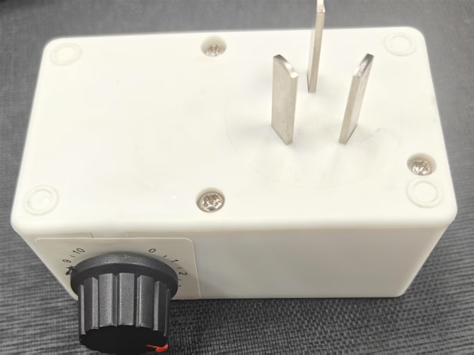

 AC Power Source: Capable of providing a variable AC voltage in the range of 90 - 265 VAC with a frequency of 47 - 64 Hz. Since the maximum power of 60W, use one AC power variable switch.

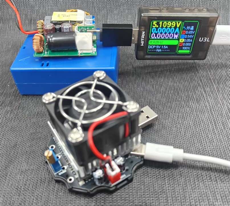

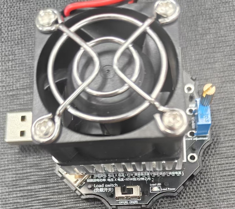

Electronic Load: Able to simulate different load currents for each output voltage setting (5 V/3 A, 9 V/3 A, 15 V/3 A, 20 V/3 A). There is one portable constant current electrical loadfor this mobile power charge testing

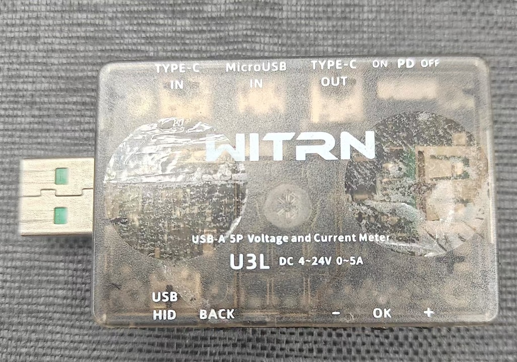

Oscilloscope or mobile charger tester, : In this case, one portable mobile charger tester 0-24V and 0-5A is better fit,

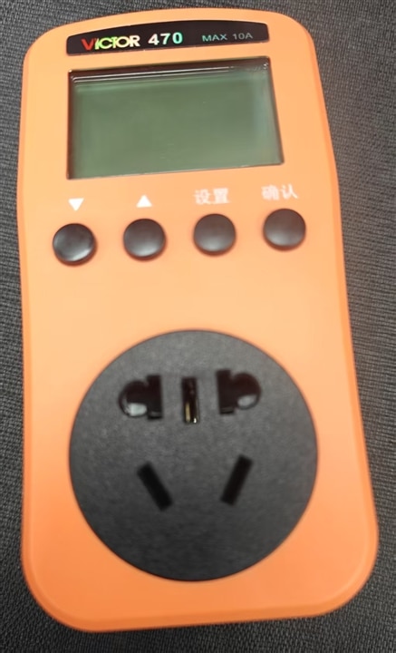

AC Power Meter: To measure input power, output power, and efficiency. One socket type AC power meter can read voltage , current , frequency

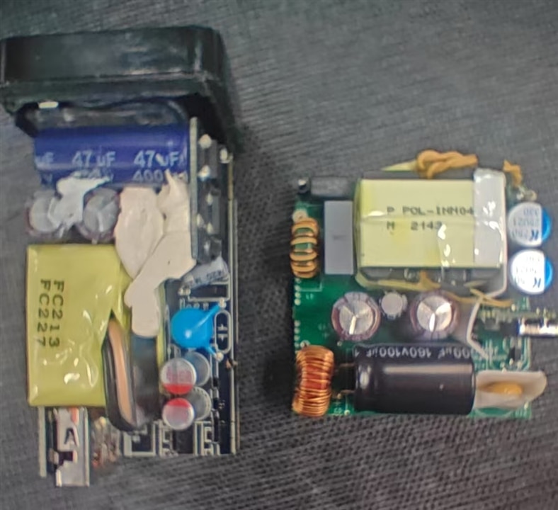

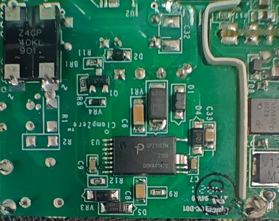

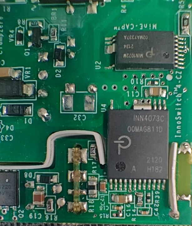

There are key com[onent
In comparing with previous product in mobile charger

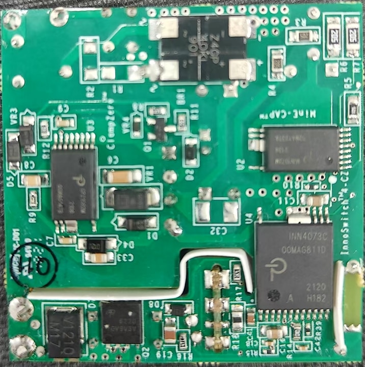

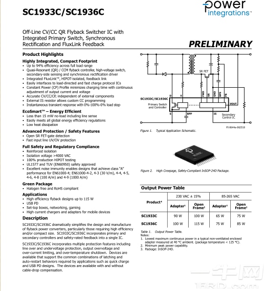

PI GaN Control chipset SC1933,

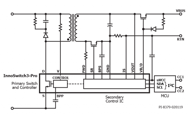

one of INN3307 serial of InnoSwitch3-Pro
The control logic block is

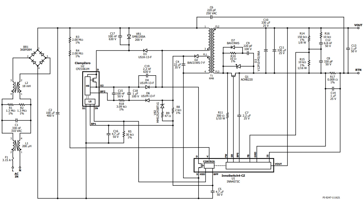

There have been many improvement for InnoSwitch 4 INN4073C-H181 | Power Integrations
The maximum power increases to 75W and more green technology shall be applied. For this serial of product with PowerGaN technology, 220W output can be reached.
The InnoSwitchTm4-CZ family of ICs partners with the ClampZero family of active clamp ICs to dramatically improve the efficiency of flyback power converters. The InnoSwitch4-CZ family incorporates primary and secondary controllers and safety-rated feedback into a single IC. This greatly reduces system and primary switch losses, allowing for extremely high power densities. InnoSwitch4-CZ also incorporates multiple protection features including output overvoltage and over-current limiting, and over-temperature shutdown. Devices are available that support the common combinations of latching and auto-restart protection mode required by applications such as chargers, adapters, consumer electronics and industrial systems. Most widely applied products are high performance mobile charger. One typical diagram for notebook computer power supply as
This RDK-928 kit is fully tested demonstration solution for mobile charger, this is optimized for 65W power delivery in many PD protocol.
The compact design into compact size

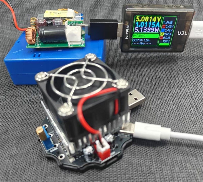

Connect the power supply to the AC power source at different input voltages as 115 VAC, and 230 VAC (The maximum voltage of 90 VAC, and 265 VAC are not tested, according to the test, the output is fairly stable even within the voltage range).

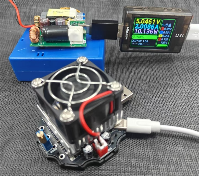

Connect the electronic load to the power supply's output with the appropriate load current for each output voltage setting 5 V/3 A ( 9 V/3 A, 15 V/3 A, 20 V/3 A can be tested in this configuration and runs OK, only that the PD cheating shall be used for voltage modification). Read the output

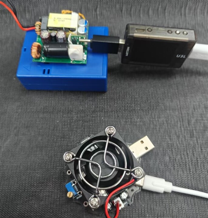

No load state while the electrical load is off.
start from 0.2A
increate to 1.01A,

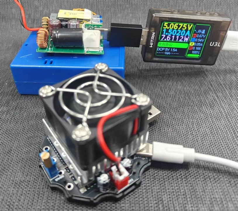

Increase to 1.50A, the output voltage drops a little to 5.06V
That works well in this stage. in 2A and 3A as well , the output voltage is stable around 5.04V

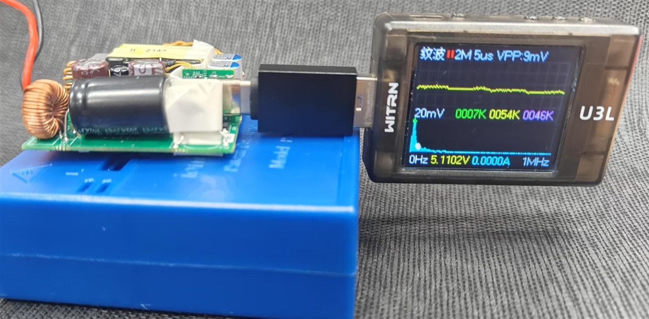

4.2 Output Ripple Test
Output Voltage Ripple test,Use an oscilloscope with a modified probe (as described in the RDR - 928 documentation) to measure the output voltage ripple as the document explained. Measure the ripple at different input voltages (90 VAC, 115 VAC, 230 VAC, 265 VAC) and load conditions (no - load, full - load) for each output voltage setting. While in this test, the specific meter can measure ripple internally
The bandwidth of 2MHz are as low as 9mV, and normally 11mV for 5 V, 9 V, 15 V at 2 MHz bandwidth. Furthermore, for reference dynamic voltage vs current diagram can be shown as well,

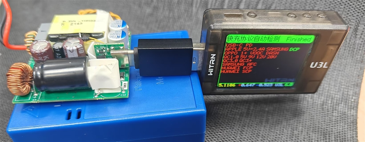

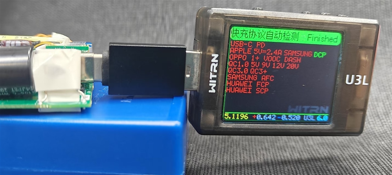

4.3 Power Delivery protocol Test
 The supported protocol can be read directly with updated firmware for the mobile charger tester, it starts to polling the protocol tests automatically.
When finished, the Following protocol are supported,
Apple 5V/2.4A
Samsung DCP, AFC
Oppo, Oneplus, VOOC, DASH
Huawei FCP, SCP
QC 1.0 and QC  3.0
The QC can supported up to 5V, 9V, 12V and 20V
