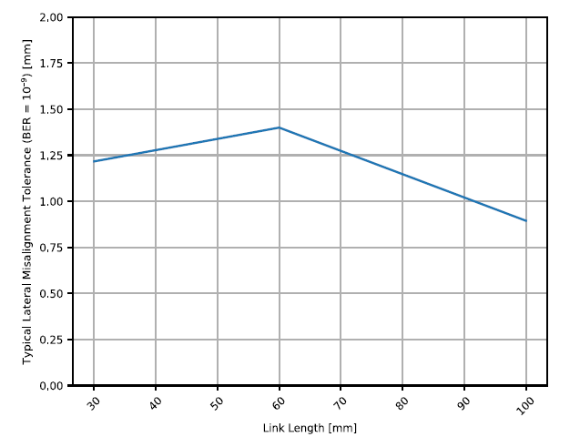

Documentation provides maximum allowed misalignment curve for 5 Gb/s transfer rate and bit error rate of 10-9
misalignment curve
which could be useful when evaluating the possibility of use this part in a given mechanical (for example: rotating) setup. As can be seen, some precision is needed when establishing a link.

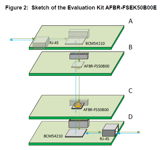

In this roadtest, we will evaluate Ethernet version of the evaluation kit (AFBR-FSEK50B00E).
The kit consists of four boards - two for the each side of the optical link: one optical transceiver board and one media converter board:
ev kit boards
with each side providing one RJ-45 data connector and micro USB power connector.

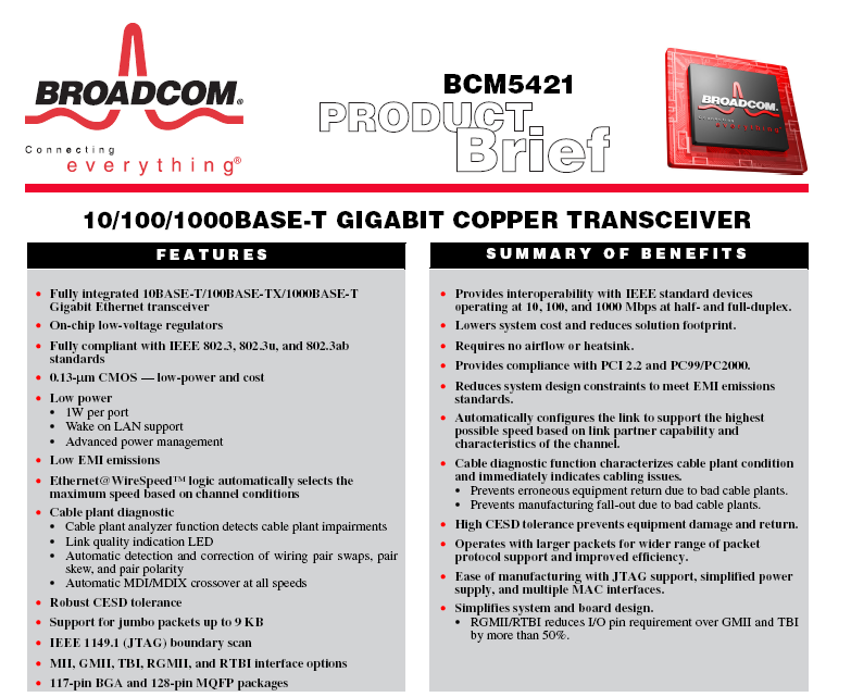

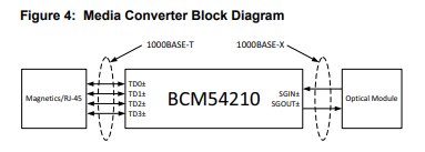

Media converter board includes BCM54210 Ethernet PHY configured as a standalone media converter, working as a bridge between 1000BASE-T (copper) and 1000BASE-X (optical) interface.
media converter block
Unfortunately, no detailed documentation of this part is publicly available, so it has to be used "as is" despite it's many interesting features.
bcm54210 brief

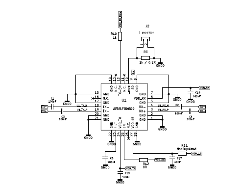

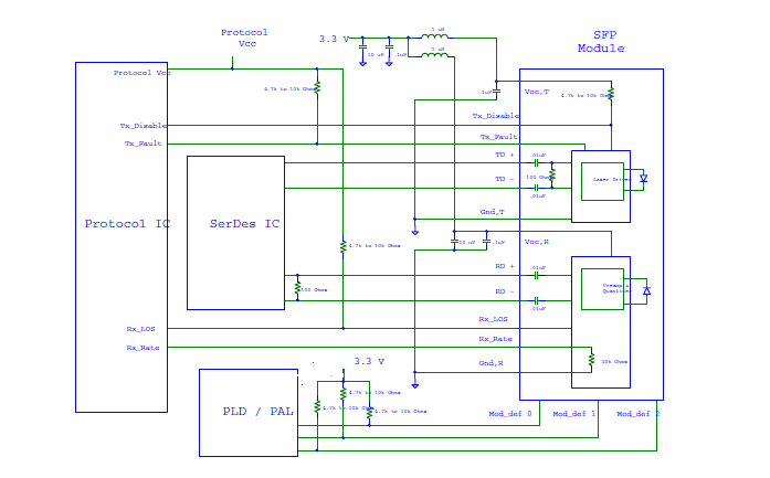

Block schematics of the media converter seems to confirm the observation that AFBR-FS50B00 module can be used in place of standard SFP (small form-factor pluggable ) transceiver, like ones below

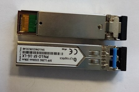

sfp
This theory is reinforced by the block diagram of SFP interface as specified by INF-8074i specification:
SFP interface
that is very similar to the AFBR-FSEK50B00E optical frontend electrical interface:
optical interface

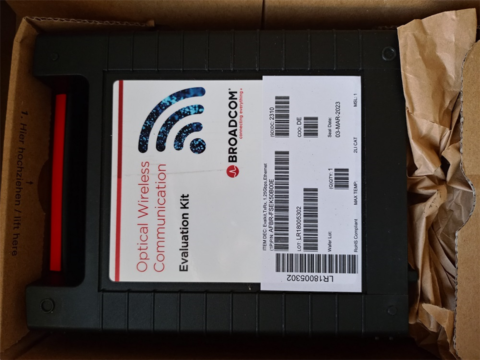

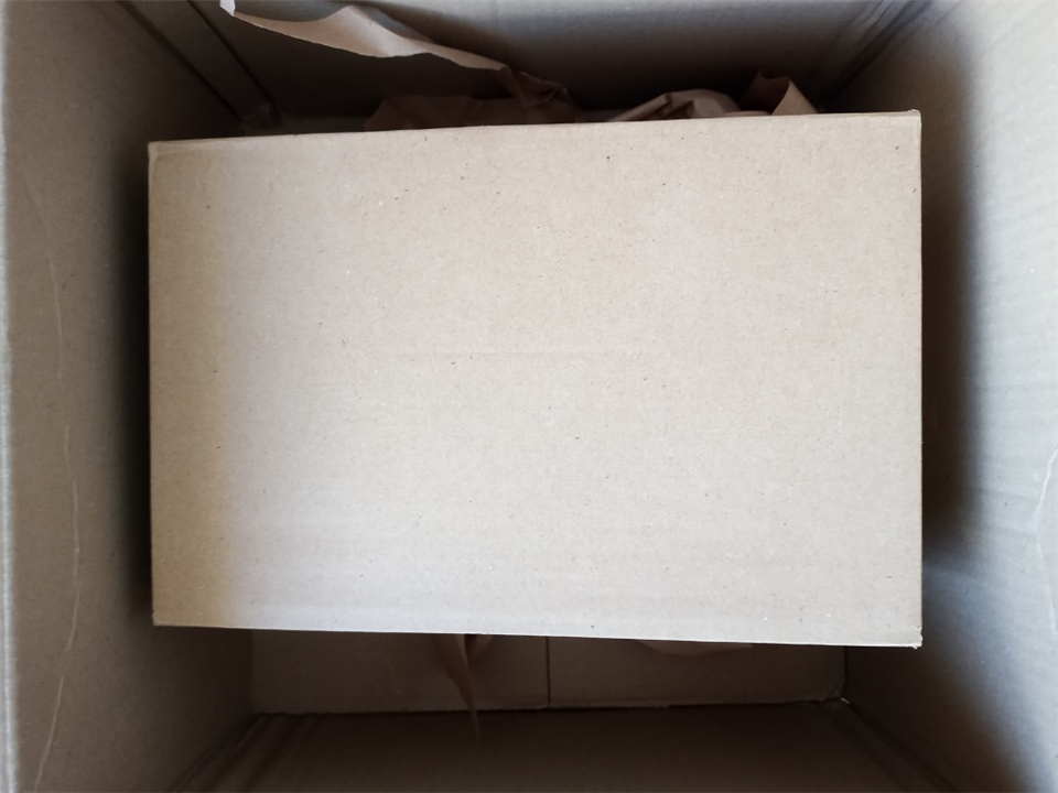

Module has arrived securely packaged in a cardboard box that contained elegant plastic enclosure filled with a foam that was holding evaluation kit in place. No additional accessories were included, but - in fact - none are needed: the kit can be connected using two standard Ethernet cables and two micro USB cables for power.
{gallery}unboxing
Outer cardboard box

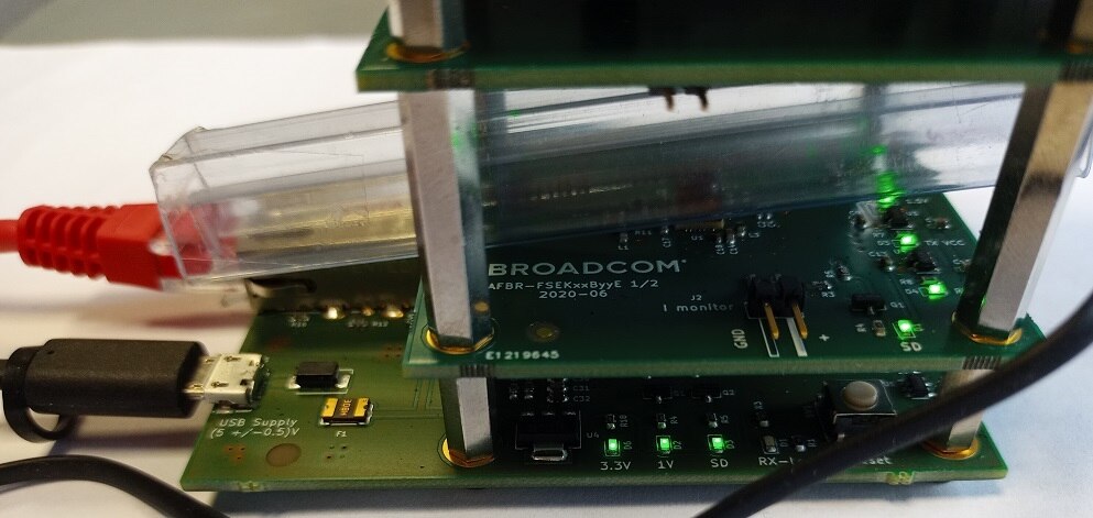

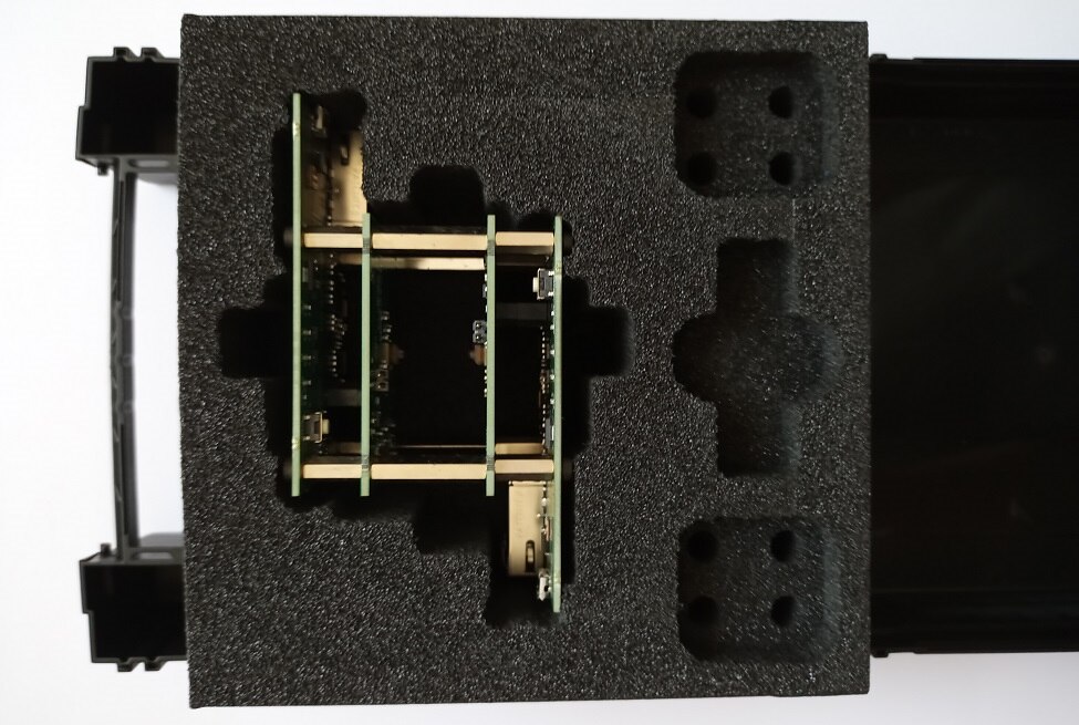

Initial inspection and powering up

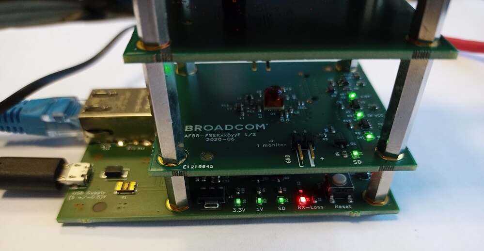

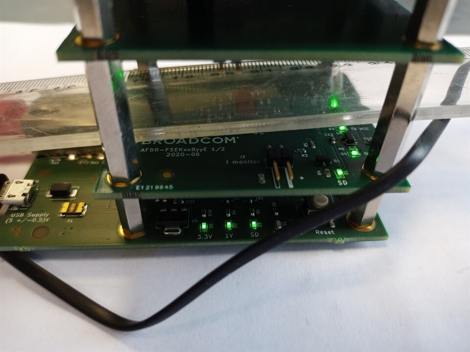

Evaluation kit is built as a four PCB "sandwich", with external screws dual-purposed as module's feet
 module construction
Media converter board has four LEDs - two of them indicate presence of 3.3V and 1V supply voltages, SD LED turns green when optical signal is present and Rx Loss LED turns red when copper interface is down.
As there is no auto-negotiation on the optical link, Rx Loss is also reported when connected to the link not supporting 1Gb/s speed (for example 100BASE-T interface)  - despite the fact that the transceiver supports signal speeds from 125Mb/s - so some care needs to be taken when selecting test equipment to use interfaces capable of operating at 1Gb/s.
Another important note is that media converters seem to propagate "link down" condition across the link, so the datasheet advises against powering up both boards simultaneously and states that in such a situation link might not be established. At least one second wait in powering up sequence is advised.
rx loss led

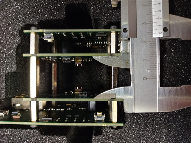

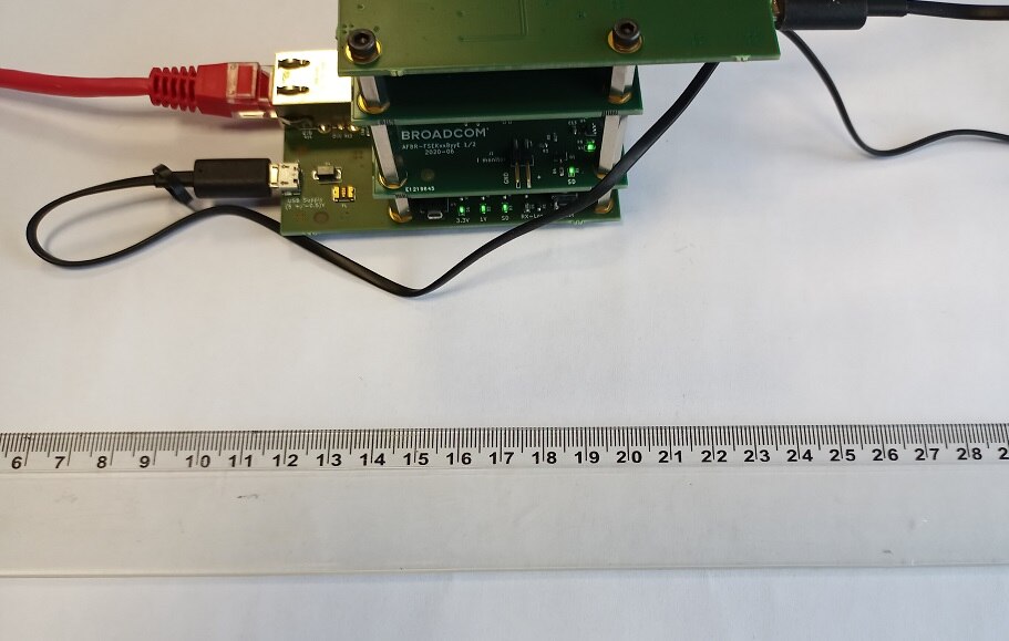

Optical link length
Another thing that can be visually identified is an optical link length that seems too short.
link length
As - according to the documentation - link length is defined as "top of lens to top of lens" distance and the transceiver is 4.83 mm high, calculated link length is
24.5 mm - 2*4.83 mm  = 14.84 mm
which is much lower than the specified range of 30 - 100 mm.

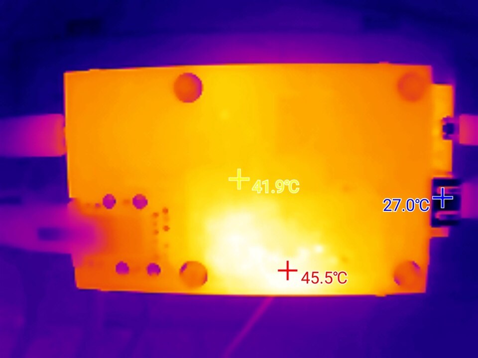

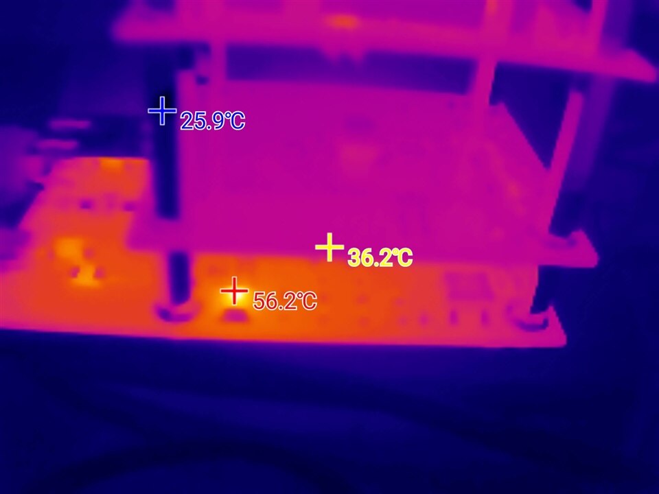

Power consumption
After powering up, media converter board draws following current from the USB port:
  • one side connected, no ethernet connection: 200mA
  • two sides connected, no ethernet connection: 210mA
  • two sides connected, ethernet connected: 270mA

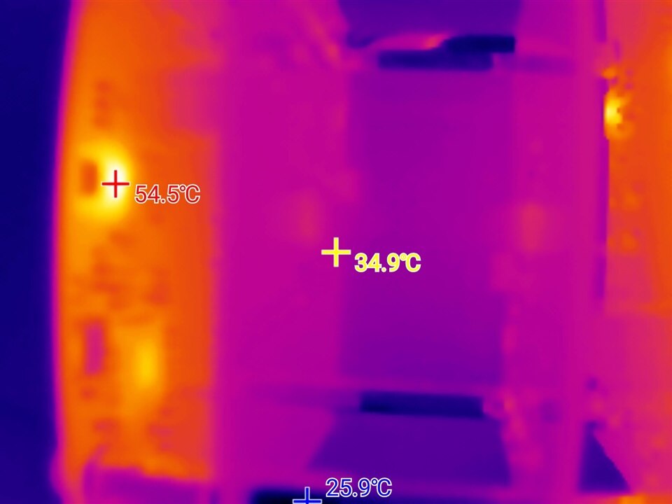

That is significantly more than expected 35 mA of the transceiver. Additionally, media converter boards are getting warm when powered, indicating where most of the power consumption occurs:

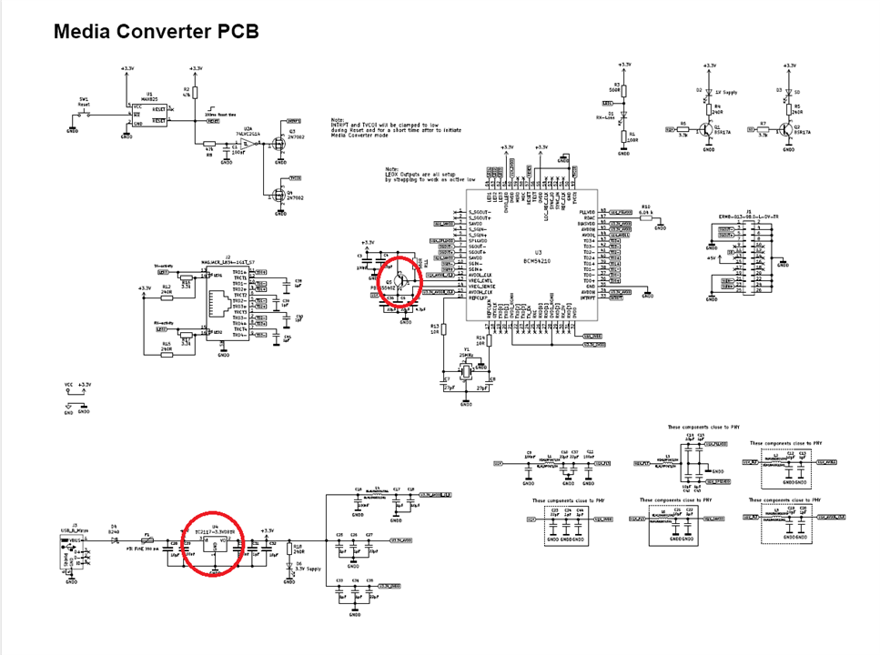

temperature distribution
two additional photos pinpoint power consumption areas as linear regulators: one (U4) for 3.3V rail and another one as power transistor driven by the 1V regulator inside PHY (Q5)
{gallery}thermal distribution
U4
3.3V LDO
Q5 power transistor for 1V rail
Q5 power transistor
 heat generation on schematics
As can be seen - elevated power consumption is not connected with the transceiver operation but mainly with media converter design.

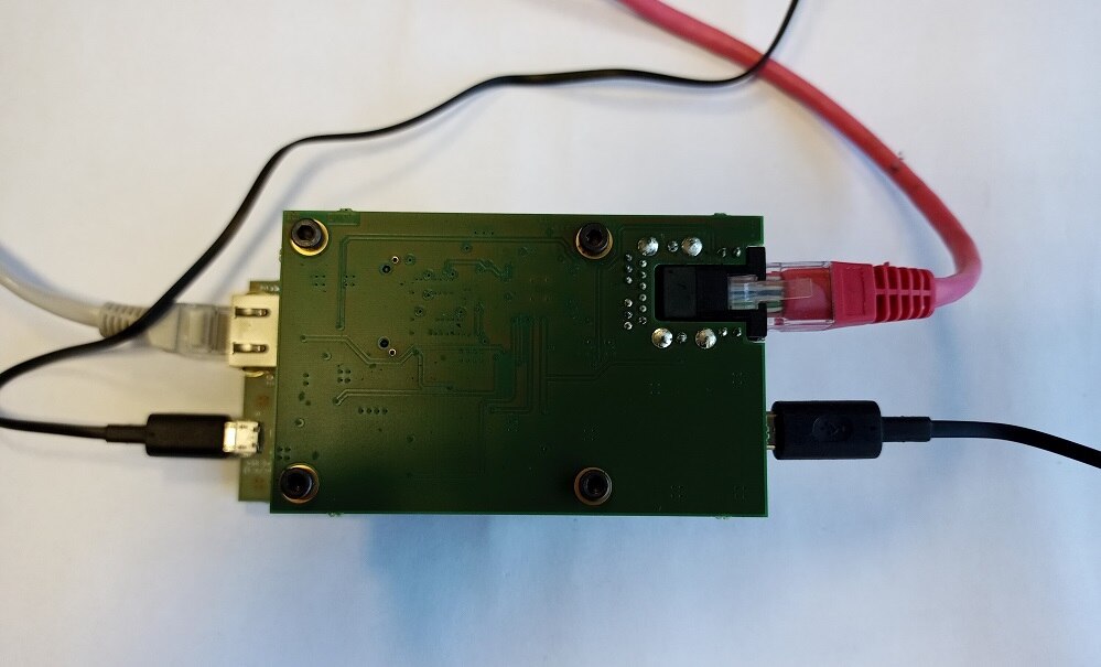

Test setup
To evaluate the performance of the optical modules, test setup was prepared. It consisted of two 1000Base-T Ethernet (a.k.a. copper Gigabit Ethernet) NICs installed in two GNU/Linux servers.
The cards were of different types:
  • a built-in Intel Server Adapter (based on Intel Corporation 82579LM chipset)
  • a four-port Intel 82576 add-on card.

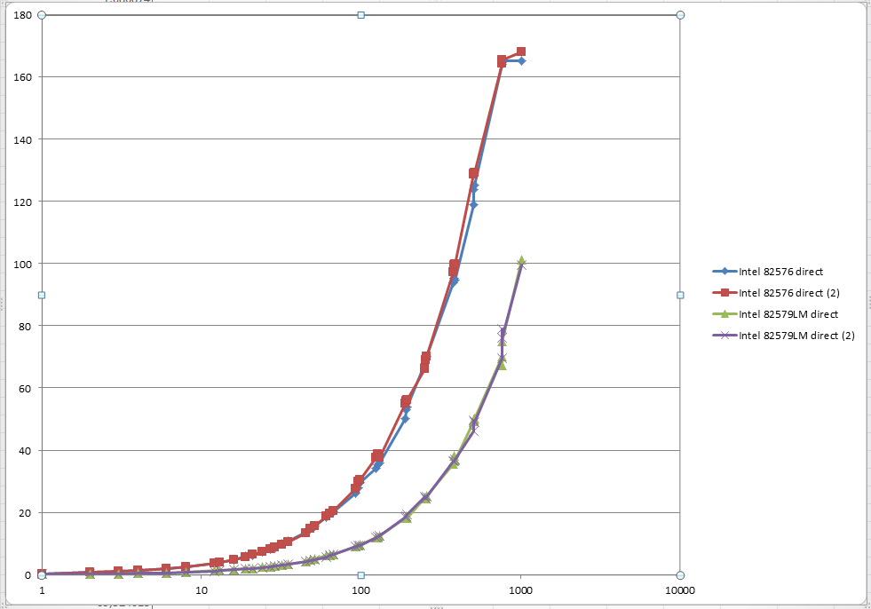

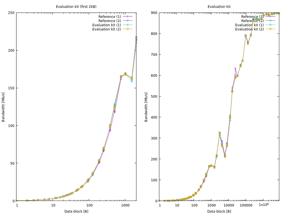

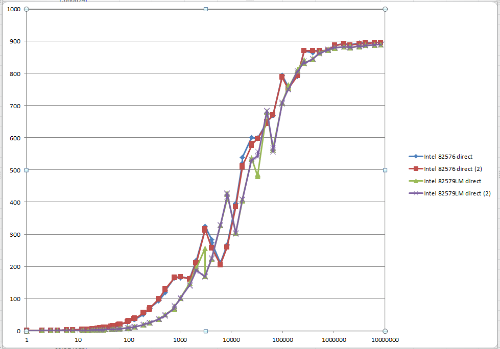

Reference tests were conducted using Netpipe TCP module, that is providing detailed link bandwidth measurement by sending blocks of different size using ping-pong technique. This measurement provided following baseline (X axis represents block size in bytes, Y axis transfer in Mb/s), with two measurements from each link to check repeatability:
baseline - full
As can be seen both adapters achieve almost full 1Gb/s bandwidth for large blocks, but initially data transfer  is limited by the transmission delay (which is more than three times longer for 82579LM) . Additionally, for some block sizes transfer rate degradation is observed. Difference of performance for small blocks can be better seen on the following graph fragment, when 82576 achieves more than 60% faster transfer than 82579LM.
baseline - small blocks

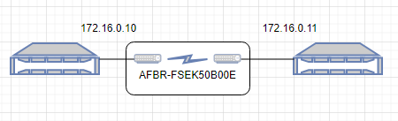

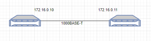

First, direct connection was tested:
reference diagram

Then, evaluation module was inserted between the hosts
test setup
and tests were repeated

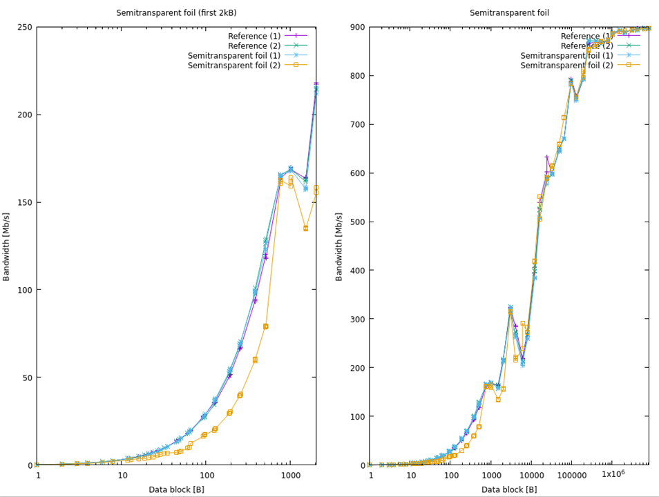

Finally, Netpipe test provided results as below - transmission rate curve when using evaluation kit is hard to distinguish from direct copper connection.
netpipe evaluation kit

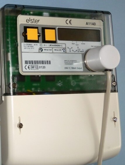

Following test cases take into consideration the fact that unobstructed data channel is sometimes hard to obtain. For example, in the setup as on the photo below - optical interface is connected to the equipment, providing isolation without creating weak spots like connectors that can get dirty, damaged or become point of water or humidity ingress. Unfortunately, all the benefits of such a connection would be lost if enclosure wall (or dirty/scratched enclosure wall) would hinder the optical communication.
smart meter with optical head

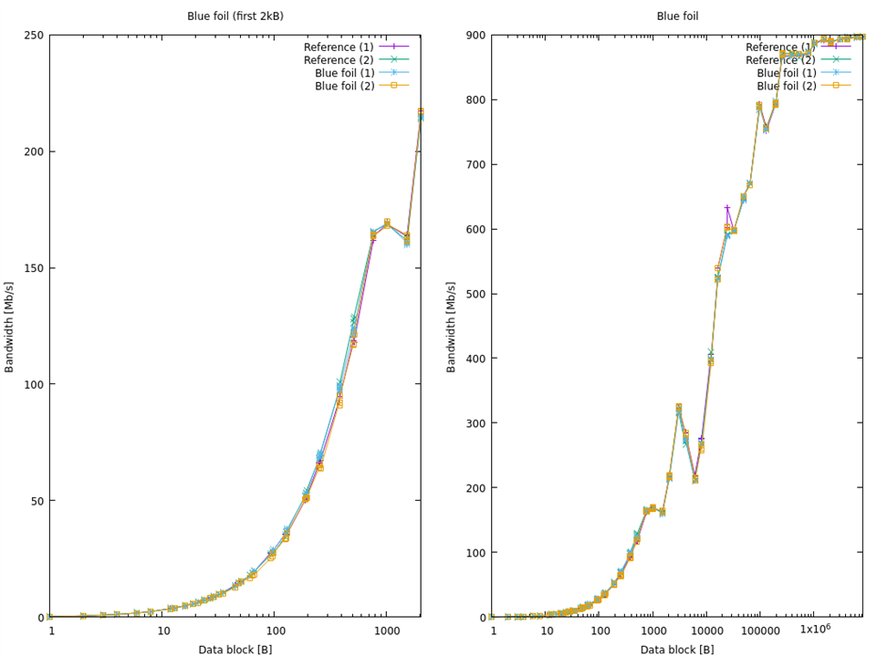

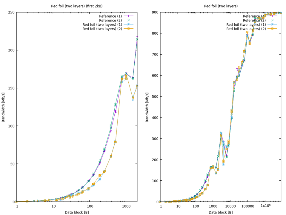

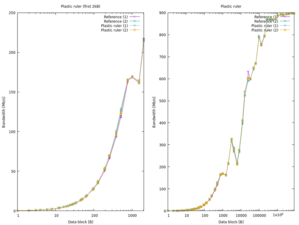

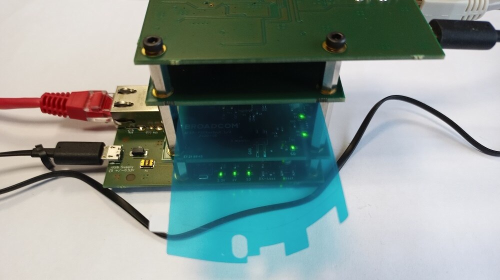

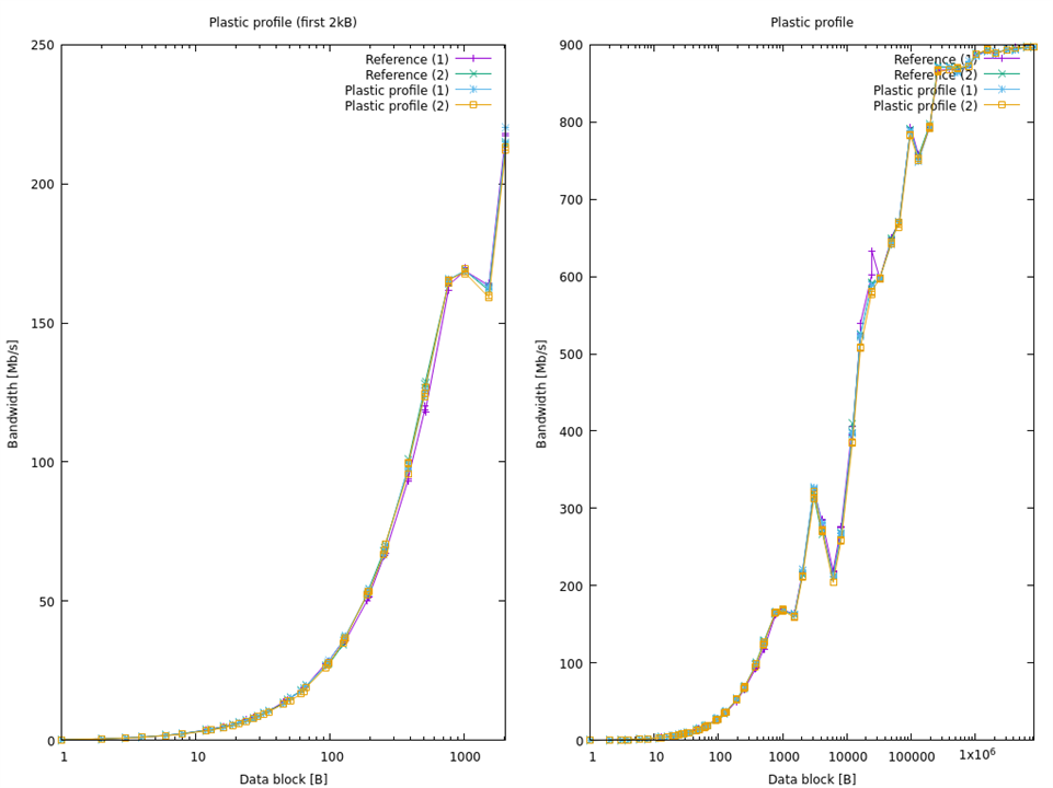

To test the influence of different types of materials in the optic link, several tests were devised.
For every scenario, two test runs were performed and then compared to two series of reference data - this approach was adopted to detect possible differences between test runs.

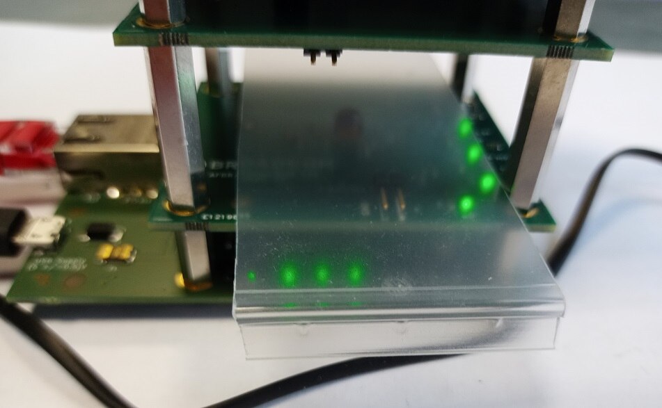

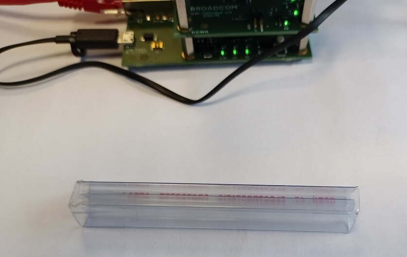

Plastic profile
As a mock-up of typical window glass (with at least two glass panels separated by the air gap), plastic profile (commonly used to store DIP chips) was used.
{gallery}Plastic profile
plastic profile 1
Plastic profile
Profile under test
Profile under test
Plastic profile test was passed without observable signal degradation - in fact, signal quality is hard to distinguish from the direct connection.

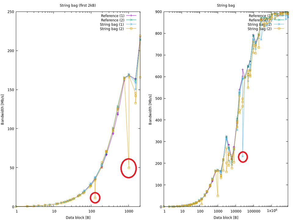

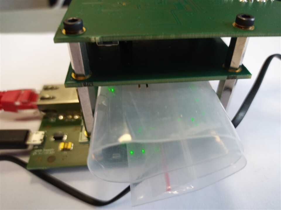

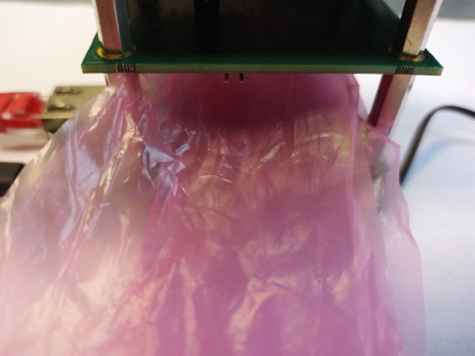

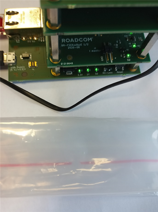

String bag
As plastic profile test was successful, let's find something with even more glossy surfaces, possibly creating more reflections - something like a string bag
{gallery}String bag
String bag
Another reflective plastic test case
under test
Under test
This one was more challenging - depending on the bag placement and number of folds, transfer was either not possible or was pretty good:
string bag
As can be seen - overall test result was ok, but some packet loss was detected (visible on the plot when only one of two data series had momentary performance degradation, indicating TCP retransmission caused by packet loss).
Plastic ruler
What's about thicker plastic element? Like a transparent enclosure wall? Let's see
{gallery}Plastic ruler
Thicker plastic element
Under test
Under test
As can be seen, transparent plastic element about 2mm thick is not creating observable signal quality degradation in this test.
plastic ruler test
Semitransparent foil
And what will happen if our obstacle will be not fully transparent?
This one is really interesting - one data series has performance similar to the direct connection and another exhibits noticeably longer transmission delay (for small data blocks) but without visible data loss symptoms.
Semitransparent
Blue foil
To this point we were testing transparent or semi-transparent obstacles. Let's see what will happen when our obstacle will be of different color - for example blue (not expected to attenuate IR radiation)
blue foil
As can be seen - nothing spectacular had happened - transfer rate is again very similar to the direct connection.
blue foil
Red foil
If previous one was working that good, let's see what will happen when red (possibly attenuating IR signal) foil is used?
red foil
This test was conducted in two parts: first test iteration was conducted using double layer of red foil and resulted in consistent increase of transmission delay for both test series (as seen on the plot below). Trying to repeat the test using three layers of the foil resulted in a very high packet loss, preventing the benchmark from completing - possibly attenuation was too high to establish a reliable link.
Red - double layer

    And as of distance/alignment tests - I was initially thinking about executing them, but after reviewing misalignment curve I have realized it would be difficult to do repeatable distance and (especially) alignment tests: as maximum misalignment is about 1 mm, distance test would involve using hardware setup with minimal leeway to not add effects of misalignment to the results from different distances.
    And misalignment test would need a precision and repeatability in the range of fractions of millimeter - probably something like modified 3d printer could be used, but I am currently not owning one...
    If I can prepare a workable test setup, I could probably add them, but for evaluation of this evaluation module (in contrast to the test of the transceiver alone) they are probably not strictly necessary - as they would involve kit disassembly/modification (but the results could be very interesting of course)

    Are you going to test the distance sensitivity?
    Have considered testing for alignment sensitivity?
