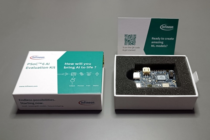

What’s In the Box
The kit includes the board and a nice introductory card with a QR to a very handy and complete Getting Started page.

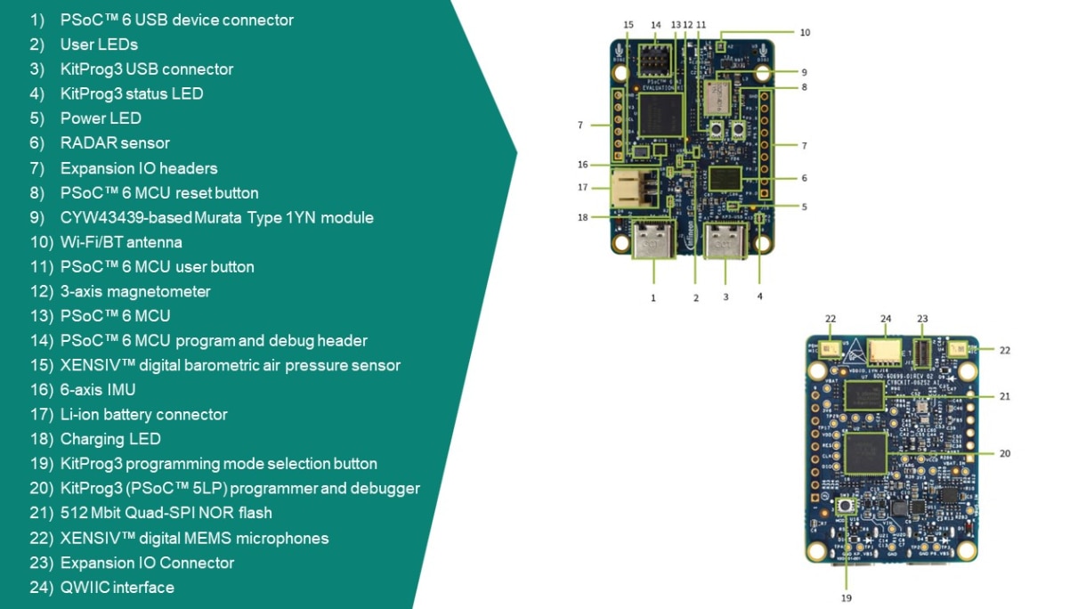

Hardware
The CY8CKIT-062S2-AI development board is extremely compact, and it's powered by a PSoC 62xA MCU based on a dual-core (150MHz ARM Cortex M4F + 100MHz Cortex M0+) CPU design, featuring 2MB of Flash memory and 1MB of RAM.
This board also features a wide array of digital and analog I/O (including SDHC, UART and I2C ports), as well as Wifi and BT/BLE, and a USB-C port (actually two; one for programming, and one for interfacing).
For sensor-rich experiments the board is also fitted with:
  • A DPS368 barometric pressure sensor
  • A BMM-350 3-axis magnetometer
  • BMI-270 6-axis (accelerometer + gyroscope) IMU
  • BGT60TR13C 60GHz RADAR sensor
  • And two IMT72D128V MEMS microphones.
As for the power supply, this board can get power from either of the USB-C ports or from a dedicated 3.6V Li-Ion battery connector with on-board charging circuitry.
Finally, the board also includes a PSoC 5LP MCU that acts as a KitProg3 programmer for the main PSoC chip.
Board diagram taken from the Product Page
Diagram taken from the Product Page
As you can see the board is packed-full of sensors and resources for ML experiments and applications. More details and documentation here:

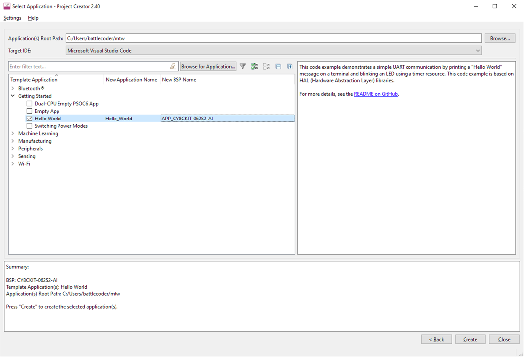

To create my own basic project I started the Modus Toolbox Dashboard, which has handy shortcuts to start a project on any of the installed/configured IDEs through the “Project Creator” interface.
I had to select the board, and a project from the templates, which included a Hello World.
Then it automatically started downloading the code from a GitHub repo .Apparently all the templates seem to be at https://github.com/Infineon/Code-Examples-for-ModusToolbox-Software. I think having them on Git is a really clever way of providing a collection of easy-to-update templates for different platforms and it allows you to browse the code freely.
Once the Hello World demo was downloaded, I opened the project with VS Code and uploaded the code to the board.
The result? Well, exactly as expected:
A beautiful blinking LED.

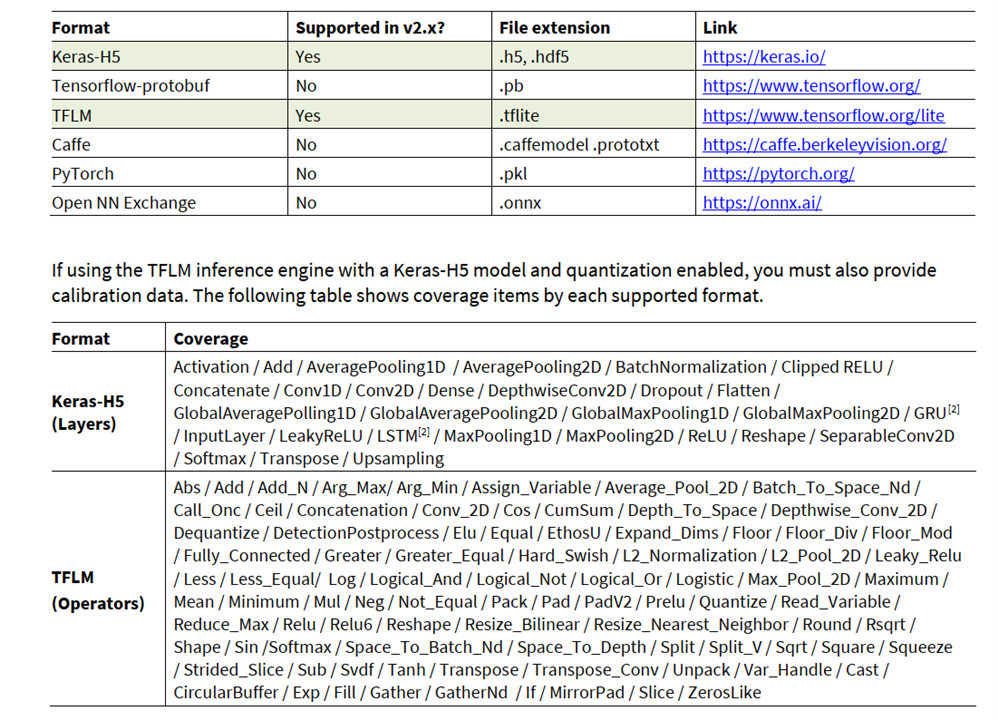

Technically by using the Modus Toolbox ML package you can also run your own models trained on industry-standard frameworks and tools! The best resource if you are interested in this alternative is the ModusToolbox ML User Guide, but here is one of the relevant tables from that document, to give you an idea of the framework's compatibility:

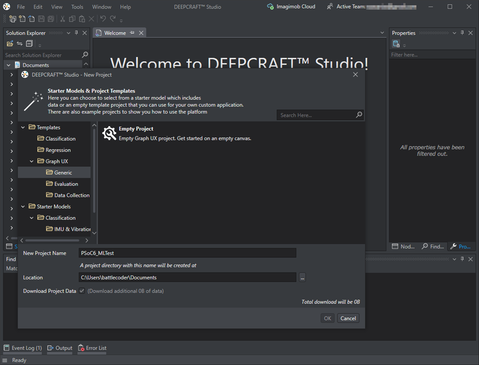

I followed the instructions from the "Getting Started" guide that briefly covers how to create a data collection workflow to acquire and label sensor samples. It's not mentioned in the guide; but for the board to appear in the list of nodes in DEEPCRAFT Studio it needs to be connected to the computer, and it has to be running the sensor streaming firmware. Once everything is ok, you can select the onboard sensors as inputs for your workflow!:
I made a very simple workflow with just the microphone, the labels, and a data visualization node, and then hit "play", which took me to a screen where I could start recording data. For my test I clapped a couple of times and stopped the recording, then I started assigning the same level to each "clap" captured: (I know "Mylabel1" doesn't say much for now, but that's going to be for Clap. Maybe I should have given it a more meaningful name before recording).
After labeling the data and saving that session, I started a new one to record "taps" (not claps!), labeled the samples, and then saved it.
Once I had the data I created an Empty Classification project (from the templates), and imported the labeled audio samples as per the guide in Imagimob's developer portal.

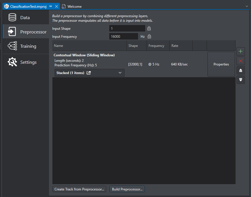

The next step was definining the pre-processor. This is an important step but for the sake of running a quick experiment I went with just a sliding context window, which seemed reasonable for continuous detection of audio patterns, and moved on.

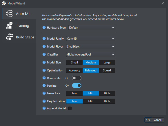

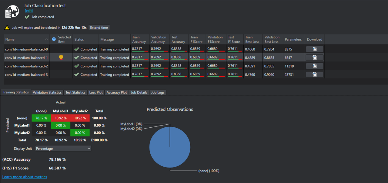

Finally we get to training a model. For this step I decided to use the Model Wizard and see what AutoML is able to do with my data.
This gave me a list of models with slightly different configurations that I could start training. Clicking on "Start Training Job" uploads everything to the Cloud and schedules a job, giving you the option to monitor the training status.
My first session ended in error but it gave me a clear idea of where it went wrong."Not enough validation data" was a clear enough instruction to help me fix the issue and try again! (I had just 10 examples of each type for validation, so it was to be expected). Going back and adding data was easy enough that I didn't have to resort to the documentation again.
My next attempt went through just fine. This is what the status screen looked like after it had completed a couple of epochs:
Once finished it, it gave me a lot more data on the performance of each, plus their corresponding confusion matrices. It also selected the best performing model for me. Unfortunately I noticed that despite the apparent "high" accuracy, my models weren't really picking up the clap or tap patterns. I had a model with 78% accuracy, but ...78% of my audio recording were neither claps nor taps,  and that's where that figure was coming from. It picked absolutely zero of the actual noises I was interested on. This, again, was really easy to see in the detailed analysis I got after training finished.
I think this is a great time to mention that while I have some experience with ML at work and with my own personal projects, I have no experience with audio detection models, so I was in partially unknown territory (which happens to make this an even better test of the whole process). At any rate, I realized that probably my sliding window strategy was wrong, and I should also append some FFT in the pre-processor stage (since it makes more sense to find patterns in the frequency domain). I also took this opportunity to re-label my data so my labels are "Clap" and "Tap" instead of "Mylabel1" and "Mylabel2".
I decided to keep this failed experiment in this review because failing is part of the process, and I didn't want to just show a successful run with a perfectly tuned model. Trying different variations of models and transformations is how ML/AI development normally goes, so this also showcases the way that DEEPCRAFT Studio handles this trial-and-error cycle.

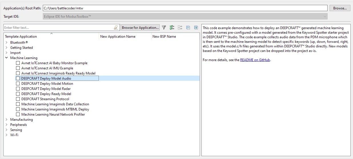

For my application I needed to create a project that initializes the audio hardware and obtains samples from the microphone that I could pass to the model, checking after every new sample if there's a result available from the classification. Luckily Infineon already has a deploy example for their keyword spotter model, which does exactly that (but with their own model). Now, apparently that repository contains outdated dependencies so I'd recommend to use the Project Creator interface and use the templates offered there, which seem to come from more up-to-date repositories:
Since this example does exactly what I need (captures audio samples at 16KHz from the onboard microphone, feeds them to the model, and keeps checking if the model has detected a label) I was able to just use that project and replace the model.c and model.h with mine. I made some other small adjustments to the code like changing the microphone gain and tweaked the threshold for the detected label to be selected as the output, and then I run it. Here's a video capture of me testing it:
It works great in my opinion, and I was very happy with the results.
