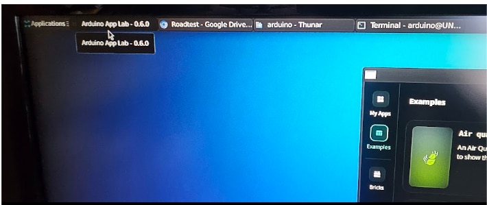

Arduino App Lab
This is a brand-new unified development environment (IDE) pre-installed on the UNO Q. It allows developers to:
  • Combine Arduino sketches (C++), Python® scripts, and containerized AI models (Docker/Docker Compose support) into a single application.
  • Utilize "Bricks"—modular, ready-to-use services for AI, web UIs, or sensor integration.
  • Monitor logs for both the MPU and MCU simultaneously.

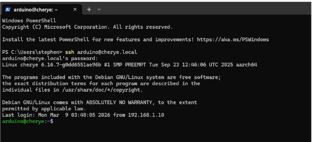

  • Connect to UNO Q via Secure Shell (SSH): A tutorial on setting up a remote terminal connection to the board's Linux environment over a network.

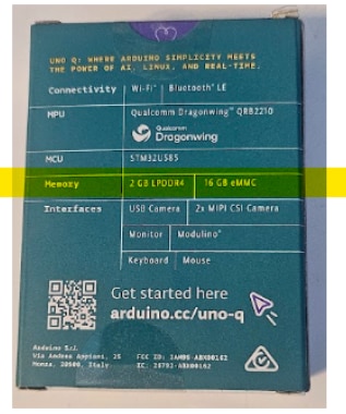

2 GB model (ABX00162) (back of the box)
4 GB model (ABX00173) (back of the box)
As you can see from the back of the boxes, the only difference between the 2 GB model (ABX00162) and the 4 GB model (ABX00173) are in Memory RAM & Storage (RAM LPDDR4 & eMMC Storage).

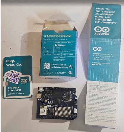

What’s in the Box: You will find the Arduino UNO Q board,a small safety leaflet, and a Scan Card.

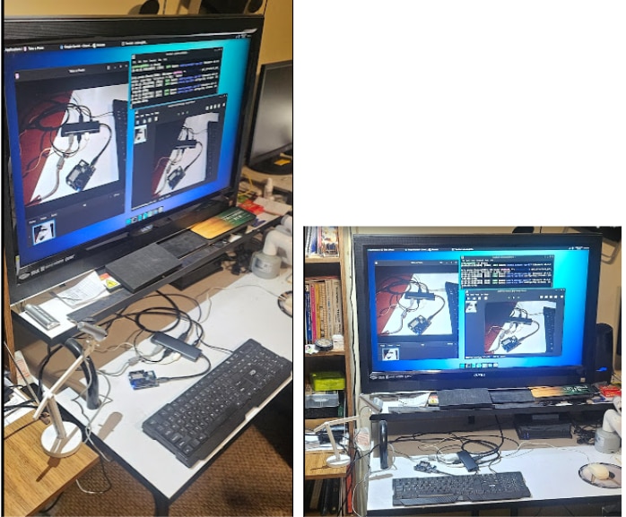

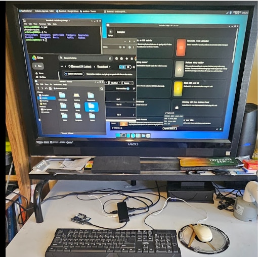

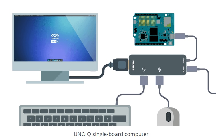

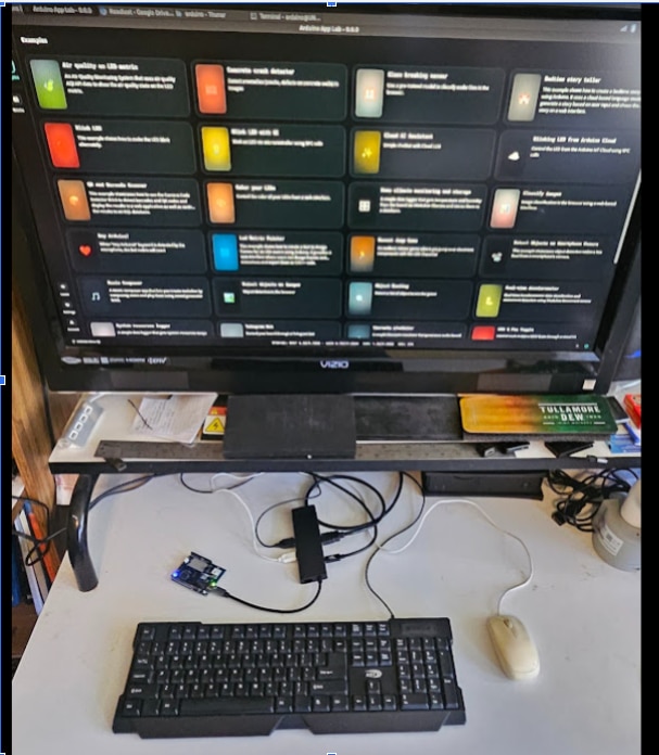

To use the UNO Q in Single-Board Computer (SBC), the following 2 items a USB HUB and Power Supply , are required, in addition to a mouse, keyboard, and HDMI cable with a display.
I had these lying around and they worked fine

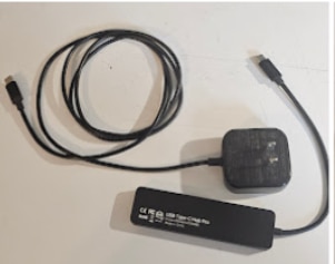

This is what element14 supplied  for the roadtest
  1. Multicomp Pro AC/DC Power Supply
  2. Cables Direct USB4 Type-C Cable (for power supply)

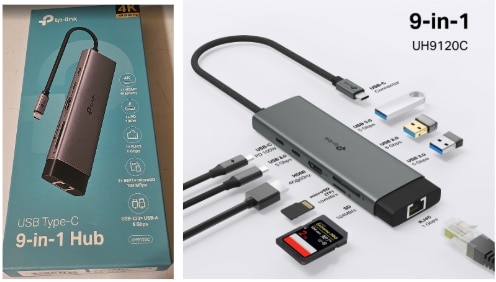

  3. TP-Link UH9120C USB Type-C 9-in-1 Hub

  1. Multicomp Pro AC/DC Power Supply.
Output Voltage: 20 V
Output Current: 1.5 A
Total Power: 30 W
Manufacturer Part Number (MPN): MP009260
2. Cables Direct USB4 Type-C Cable POWER CABLE
Model Number: USB4-7200E
Length: 2 meters (approx. 6.5 feet)
Data Transfer Speed: Up to 20 Gbps (USB4 standard)
Power Delivery: 240W Extended Power Range (EPR). As indicated by the "240W" icon on the connector housing, this cable supports the highest current USB-C power delivery specification. It contains an internal e-marker chip to safely negotiate high-wattage charging for power-hungry devices like heavy-duty docking stations or large laptops.
Connectors: USB Type-C to USB Type-C (Male to Male)
3. TP-Link UH9120C USB Type-C 9-in-1 Hub.
UH9120C | USB Type-C 9 in 1 Hub | TP-Link
Designed with an aluminum alloy casing and a braided cable that neatly tucks into the body for self-storage, it expands a single USB-C port into nine distinct connections.the ports include:
1x HDMI: Supports up to 4K resolution at 60Hz for external displays.
1x USB-C PD: Supports up to 100W Power Delivery pass-through charging.
1x RJ45 Ethernet: Supports stable 1 Gbps (Gigabit) wired network speeds.
2x Card Readers: Includes 1x SD and 1x microSD slot, with transfer speeds up to 104 MBps.
4x Data Ports: Features 1x USB-C and 3x USB-A ports, all capable of 5 Gbps SuperSpeed data transfer.
Compatibility: It features driver-free "Plug & Play" support across a wide range of operating systems including Mac OS, Windows, Linux, iPadOS, iOS, Android, and Chrome OS.

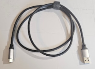

To use the UNO Q in Headless mode, In addition to a PC running Windows, MAC OS or Linux a USB type-C cable is needed. I'm sure you have plenty of these around.

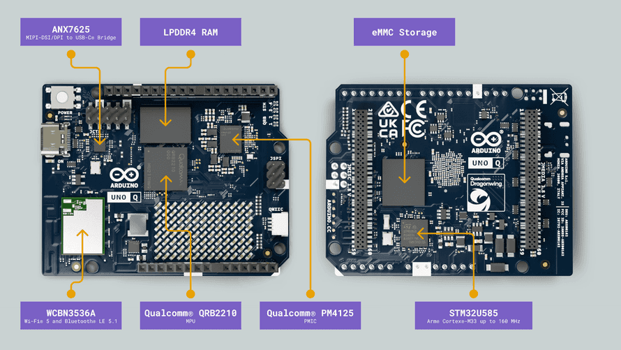

Hardware Inspection
Courtesy of the User Manual image, here is an overview of the board’s main components, as shown in the image above:
LED matrix: Locate the built-in 8x13 LED matrix on the board; this will be your primary source of visual feedback during the initial boot.
Microprocessor MPU: The Qualcomm® QRB2210 is a quad-core Arm® Cortex®-A53 processor running at 2.0 GHz, equipped with an AdrenoTm 702 GPU (845 MHz) for 3D graphics acceleration and dual ISPs supporting up to 25 MP at 30 fps. It runs Debian Linux OS with upstream support, making it well-suited for embedded vision and edge computing applications.
Microcontroller MCU: The STM32U585 microcontroller features an Arm® Cortex®-M33 core running up to 160 MHz, with 2 MB of flash memory and 786 KB of SRAM. It runs the Zephyr OS, providing a secure and efficient platform for low-power embedded applications.
Wireless Connectivity: The WCBN3536A radio module provides dual-band Wi-Fi® 5 (2.4/5 GHz) and Bluetooth® 5.1 connectivity, both with onboard antennas for reliable wireless performance.
Memory: The board features 16 GB or 32 GB options of eMMC storage and 2 GB or 4 GB options of LPDDR4 RAM, delivering fast memory access and reliable storage for embedded applications.
Multimedia Codec: The ANX7625 multimedia codec enables video and audio output through the onboard USB-C connector, providing a high-speed interface for display and sound transmission in embedded applications.
Power Management: The UNO Q includes the Qualcomm® PM4145, a power management integrated circuit (PMIC) to meet the demands of always-connected IoT devices.
Regardless of which of the models you have purchased, there is a “get started” sticker on the box pointing to arduino.cc/uno-q
If you follow this link you will come to this page.
While this is a starting page, I question its effectiveness in helping a new user make an informed decision about the numerous paths they could follow. The very first element is a button to download "APP Lab." A user, unlike myself, might not have read the documentation yet at this stage. The subsequent links are: the 3 modes to running App Lab and then a link to introducing the reader to what Apps are then a link to the Bricks doc page. And at the end of the page there is a link to the extensive user manual at User Manual. There is no mention of HOW TO Connect the board, or use App Lab.I find this to be a shortcoming The comprehensive User Manual and resources are entirely digital and available on the Arduino website. I previously detailed these resources and strongly recommend reviewing at least the  Uno Q Datasheet before proceeding. However, if you are eager to get started, I've compiled a quick-start guide for the basic setup and powering up the board. Most of it has been taken from the extensive User Manual.

You can interact with the "dual-brain" system in two ways:

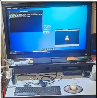

Desktop Mode (SBC):
UNO Q as a Single-Board Computer (SBC).
The single-board computer comes with a pre installed Debian-based desktop operating system and App LAB. The Arduino App Lab runs automatically on boot to update the board and dependencies. The computer supports various uses like web browsing, media playing, coding, and file managing. Remote access is available through the Arduino App Lab desktop and Network Mode.
Out of the box, the Debian-based image on the UNO Q already comes with several useful applications pre-installed, allowing you to get started immediately:
  • Chromium Browser: surf the web, check your email, and use cloud-based productivity tools.
  • Terminal: manage files, run Linux commands, install software, and interact with the system at a deeper level.
  • Vim Editor: a powerful text editor available in the terminal, useful for editing configuration files or writing code.
  • File Manager: organize your documents, images, and downloads in a graphical interface.
  • Media Player: play audio and video files locally (VLC installation needed).
  • You can always expand your environment by installing more software using Debian’s package manager (apt)

This system unifies a Qualcomm® DragonwingTm QRB2210 microprocessor (MPU), with a real-time STM32U585 microcontroller (MCU). Bridging these two distinct environments is the Arduino Bridge (RPC library), the critical communication layer that enables seamless data exchange between the Debian Linux on the MPU and the real-time OS on the MCU. As an architect, your choice of setup mode is a strategic resource-management decision: you must align your deployment strategy with the board’s 2GB or 4GB LPDDR4 RAM and 16GB eMMC storage to prevent performance bottlenecks.
Selecting the incorrect mode can result in severe resource contention, particularly on the 2GB model, where OS overhead can starve high-priority Python scripts or AI models. This guide evaluates the two primary setup modes to ensure your hardware is optimized for its intended workload.
The choice between these two configurations is typically driven by the performance requirements and the target application complexity. The lower-end configuration (2 GB RAM / 16 GB Storage) is suitable for basic, resource-light operations, while the higher-end option (4 GB RAM / 32 GB Storage) is designed to handle more demanding applications, multitasking, and larger datasets. The use of LPDDR4 (Low-Power Double Data Rate 4) RAM signifies an emphasis on power efficiency, crucial for battery-powered or heat-sensitive embedded devices. The eMMC (embedded MultiMediaCard) acts as the primary boot and data storage, offering a compact and cost-effective solid-state solution.
Using Arduino App Lab on a host PC to configure and program the Arduino UNO Q is actually the recommended and most efficient approach for the 2 GB RAM and 16 GB eMMC model.
Here is how this setup affects your board's memory and storage:
Impact on RAM (2 GB LPDDR4)
  • Frees up memory: By installing App Lab on your PC, your computer handles the heavy processing of running the Integrated Development Environment (IDE) and its graphical user interface (GUI).
  • Dedicated execution: This leaves the board's 2 GB of RAM fully available for running your actual project—such as the Debian OS, Python scripts, basic network services, and lightweight TinyML applications—without struggling with heavy multitasking.
  • Avoids GUI overhead: Running App Lab directly on the board using an HDMI monitor and keyboard (Single-Board Computer mode) uses a demanding GUI that requires more memory. For that standalone setup, the 4 GB RAM model is recommended to ensure stable operation.
Impact on Storage (16 GB eMMC)
  • Pre-installed baseline: Arduino App Lab and the Debian Linux OS come natively pre-installed on the UNO Q out of the box. Therefore, a baseline amount of your 16 GB eMMC is already used for the basic OS and core libraries regardless of whether you use a PC.
  • Project deployment: When you write code on your PC and press "Run", the App Lab editor builds the Linux component, flashes the microcontroller sketch, and deploys any required "Bricks" (such as containerized AI models or web servers) over to the board's storage.
  • Sufficient space: Because you are coding on a PC, you do not need expanded local storage to support a full standalone desktop environment. The 16 GB is perfectly suited to hold the OS, the core libraries, and the specific applications you deploy remotely.
In short, developing in PC-connected mode offloads the development overhead to your computer, maximizing the 2 GB of RAM and 16 GB of storage for your application's real-time execution.

Desktop Mode:
Desktop Mode transitions the Arduino UNO Q into a fully autonomous single-board computer (SBC). In this configuration, the board hosts its own development environment via its pre-installed Debian Linux OS, functioning as an independent workstation that requires no external host PC for daily operation.
To initialize Desktop Mode, a specific hardware interface is mandatory. The USB-C port on the UNO Q handles power, high-definition video, and data throughput. To boot and operate in this mode, you require:
  • USB-C Hub/Dongle: A hub that supports both Video Output (HDMI) and Power Delivery (PD). This dongle acts as the primary interface for USB-C host/device role switching, allowing you to integrate essential AI peripherals like USB cameras and microphones.
  • PD-Enabled Power Source: The board strictly requires USB-C PD through the hub to initiate the boot sequence; the UNO Q will not boot if power is provided through a non-PD-compliant source in this configuration.
  • Standard Peripherals: An HDMI monitor, keyboard, and mouse are necessary to navigate the graphical interface.
Desktop Mode is built around the Arduino App Lab. It allows developers to manage "Bricks"—pre-built functional modules—alongside containerized AI models and Python logic. This interface is designed for visual-heavy AI tasks, enabling the rapid deployment of models for object/human detection, anomaly detection, keyword spotting, image classification, and voice commands. This mode is the Recommended path for developers utilizing the 4GB UNO Q model who require a "responsive standalone desktop experience." By utilizing the higher memory ceiling, you can run the Debian GUI and the Arduino App Lab simultaneously without compromising the performance of complex, containerized AI processes. If you don't need a monitor or a graphical interface, which can consume unnecessary power and memory, you can opt for a simpler connection. To do this, refer to "Headless Mode," which is detailed in the following section.

Desktop Mode Initial Setup (SBC)
The good news is that the Arduino APP Lab Dual-Brain development works in both Modes. The Desktop Mode (SBC) is the most straightforward way to begin, since it requires no install and runs on the UNO Q.
If you want to get started with this mode then follow this link: UNO Q as a Single-Board Computer. In this tutorial, you will learn how to set up your UNO Q as a personal computer, ready for everyday tasks like web browsing, office work and media playback, alongside working with product specific features like using Arduino App Lab for developing amazing projects.
No PC Software Needed: You do not need to install anything on your Windows/Mac PC for this initial setup; the setup logic and App Lab software are pre-installed on the board's internal storage.
Once operating in this mode you can always run SSH clients from your PC.

This mode uses a Type-C USB cable to connect to the board. Basically you plug a single USB-C cable from  a host PC (Windows, macOS, or Linux) to the UNO Q type-C connector on the board.
So what happens if you plug in the Board right out of the box?
Initially I did not install App Lab on my PC. On my 2 GB model, I just Plugged the Type- C into a PC and the board .What happened was,the default app was started. The LED display puts the Arduino logo on first, then displays a heart and blinks the GREEN  LED.  This indicates that the Board is operational.
At this point you need to configure the environment on the board first.  The easiest way to configure the board is to run the Arduino App Lab Development tool. You need to install the Arduino App Lab and run it from your PC after plugging in the USB cable and after the LED matrix screen displays the heart.

So now that you have connected to WiFi and you have the Linux credentials, and the boardname (found at the bottom status bar of the AppLab) you can SSH into the board.using this command:
$ssh arduino@cherye.local #replace <boardname> with your board name
This dumps you into the ls /home/arduino directory
Now you are able to access the board's shell and perform operations on the UNO Q remotely.

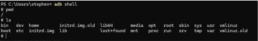

2, Connect to the UNO Q via ADB.  This section of the user Manual Connect to UNO Q via ADB,  instructs how to use ADB. This is a tool that you install on your PC , where you can access the board's shell and run operations on the system.

  1. Access the Arduino App Lab (it opens automatically to the Examples section).
  2. Select the  "Blink LED" example.
  3. Click on the Run button in the top right corner and wait for the app to be uploaded.
  4. Observe the Board: Verify that the Red segment of the built-in RGB LED is blinking.
NOTE The LED controlled in this example is driven by the STM32 microcontroller through the Arduino sketch.
In the UNO Q ecosystem, a "Blink" is more than a simple GPIO test—it is an end-to-end verification of the RPC (Remote Procedure Call) bridge. When you click "Run," a command is issued from the Linux (Qualcomm) environment, processed by the arduino-router.service, and sent across the high-speed link to the STM32 microcontroller to toggle the pin. A successful blink confirms that your software stack, the service bridge, and the hardware interconnect are operating in perfect systemic harmony.

  • Accessing the Lab: If you are in Desktop Mode, simply open the App Lab interface from the Linux desktop.  If you are in Headless Mode allows you to run App Lab on your PC, connecting to the Uno Q either through a USB cable or over your Wi-Fi network.

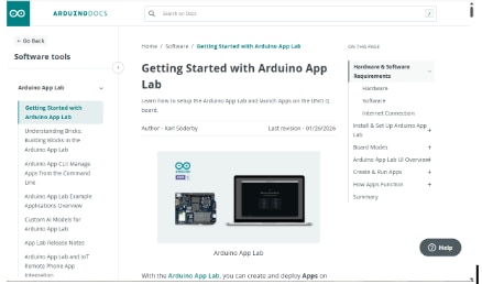

Getting Started with Arduino App Lab

Exercise UNO Q as a desktop‑class Linux SBC, using the 4 GB model (Part # ABX00173).
If you have not set up your UNO Q as a personal computer, follow this link: UNO Q as a Single-Board Computer
When you're done setting up for the first time  you’ll notice that App Lab runs on startup. For now you can exit App Lab, and explore the usage of the Debian Desktop

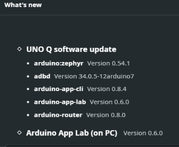

Here is my update screen for my new Uno Q  Installation. .
And showing the App Lab running version .0.6.0
I experimented with the UNNO Q 4GB model in SBC Mode, performing the six operations detailed below. You can replicate these steps or use the manuals to explore the SBC Mode further on your own.
1. Try everyday tasks like web browsing, office work and media playback.
Here I am running four apps: terminal, File Manager, Web browser and App Lab, Run from the launcher at the bottom of the screen

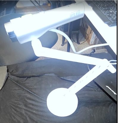

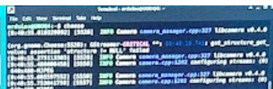

USB CAMERA USED:
To use a USB camera you can install Cheese, an app that provides a graphical interface to take snapshots and record: Here is how to run the Cheese webcam application on the Arduino UNO Q board by leveraging its built-in Debian Linux operating system.
The process involves three main steps:
1. Hardware Setup (SBC Mode): Configure the UNO Q as a Single-Board Computer by connecting a powered USB-C dock/dongle, monitor, keyboard, mouse, and a USB camera. The 4GB variant of the board is recommended due to the high resource demands.
2. Install Cheese: Open the Terminal in the Debian desktop environment and use the commands sudo apt update and sudo apt install cheese to install the application.
3. Run the Application: Launch Cheese either by typing cheese in the Terminal or by selecting it from the Multimedia Applications menu. Cheese will automatically detect the connected USB camera.
The setup includes a camera, positioned in the lower-left corner of the frame, capturing an image of the UNO Q on the desk. The screen displays three running applications: the terminal (used to launch Cheese), the Cheese application itself, and an image viewer showing the resulting JPEG photo.
Conclusions
Initially, the "cheese app" displayed an error stating that the video was not supported. I was able to resolve this by researching and implementing a fix to force Cheese to use a standard, low resolution (640x480).
While I am still receiving a "critical error" message, the application appears to be functional and is successfully capturing both pictures and videos.

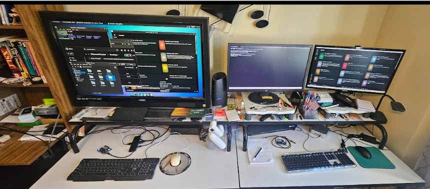

5. Try operating the SBC Uno Q while running App Lab in host mode
The Uno Q in SBC mode is on the LEFT and on the RIGHT, I have App Lab running in host mode connected to the UNO Q on the LEFT. This host is running on Windows running APP Lab On the right Display and on the Left display is the terminal screen. Now you can also exercise your PC in Headless Mode as described in the next section.section

  • Physical Connection: Connect your UNO Q to your PC using a USB-C® cable.
  • Wait Time: It can take up to one minute for the device to be recognized by your computer.
  • Verification: Run adb devices in your terminal to ensure the board is listed and connected properly.

Connecting via SSH
To connect to an UNO Q board via SSH, we only need to know the board name and password. This is set up during the first setup.
  1. Open a terminal.
  2. Run the following command:
ssh arduino@<boardname>.local #replace <boardname> with your board name
  1. Type yes when asked to connect.
  2. Enter the password for the board.

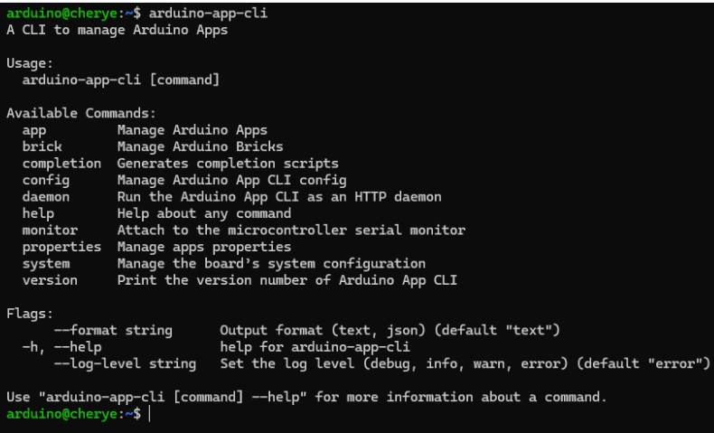

4. Arduino App CLI
Use the Arduino App CLI to access App Lab. It can be used to start & stop Apps on the board from the terminal. When accessing the board via SSH, you can run commands such as
arduino-app-cli app list
arduino-app-cli app start <app>
Note You CANNOT run multiple Apps at the same time. I’m wondering why?
.image
Based on the Arduino App CLI documentation, the system command allows you to manage configurations and updates for the UNO Q board. Here are the available commands:
  • arduino-app-cli system update: Checks for and prompts you to install any available system updates.
  • arduino-app-cli system set-name "my-board": Changes the board's name. This change takes effect after the board is reset.
  • arduino-app-cli system network-mode enable/disable: Enables or disables network mode. Enabling this allows for SSH access and lets clients connect to the board over a local network.
  • arduino-app-cli system cleanup: Frees up storage space by removing unused containers and images
Other commands available for the arduino-app-cli

    • I am not sure if you are getting true "headless" experience in your example above - you are not connecting a monitor, but you are also not preventing the window manager running. Even with a monitor connected you can switch the Debian Linux to start without all the overhead of the window manager etc by running
      # via SSH check the current setting
      sudo systemctl get-default
      > graphical.target
      # change to a non graphical target
      sudo systemctl set-default multi-user.target
      # IF YOU WANT graphical back - you can turn it back ON
      systemctl set-default graphical.target
      this means I can still see the login sequence on the screen, but the window manager never turns on - this was the difference in the 2GB grinding to a halt running a video-person-classification and browser and web cam. But when I turned the graphical stuff right off - it ran without a problem all day - accessing the web view of it and streaming video from another computer

  • Nice review !
    I haven't read it all yet but have hit a snag with the pictures - not sure how you got them into the document but they show up as rather low resolution and small - so I can't read anything on most of them.
    For example: this picture is 485 x 292 pixels,
    and I can barely read it.
    It really would be worth re-doing the pictures at better resolution.
    MK
