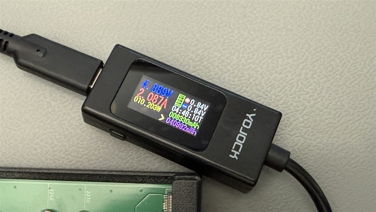

But let's see the actual power consumption. I used an USB-C power meter to check the actual voltage and current during each phase:

SDR application 4.889 V 2.087 A 10.203 W 46.2 C

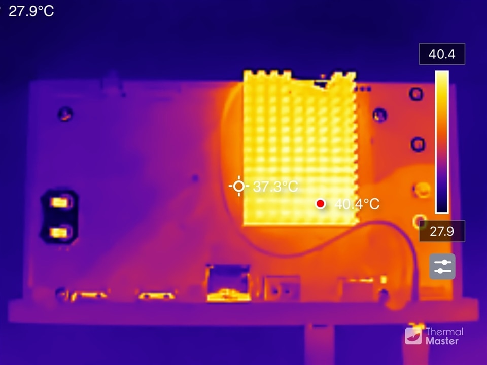

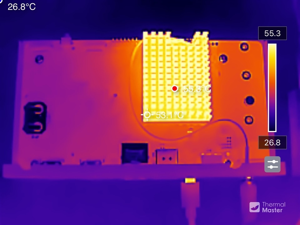

Additionally, I used a thermal camera to check the temperature distribution. The following 2 thermal pictures were taken with normal system running and with 5 minutes of CPU stress. You can see that the highest temperature on top of the heatsink is slightly lower than the CPU itself.

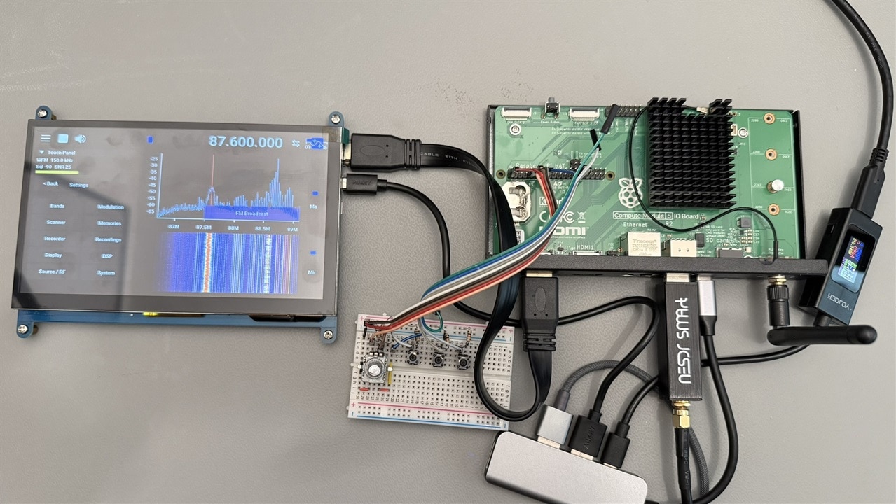

The stack is a CM5 + IO Board, an RTL-SDR dongle (Nooelec NESDR SMArt v5), a 7" HDMI touchscreen, a USB audio interface, and an optional physical control panel with two rotary encoders and four buttons wired to the 40-pin header.

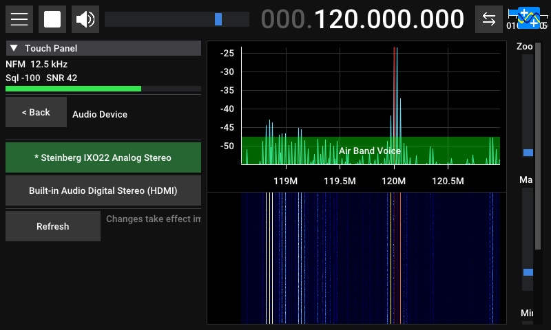

The software is a patched build of [SDR++] (https://github.com/AlexandreRouma/SDRPlusPlus) running in kiosk mode, driven either by touch or by the knobs, with both paths going through the same command interface.

For the audio output, since it's not integrated in this CM5 + IO board, I used an USB audio adapter. After you connect one, you can select the device from Menu → System → Audio Device. The HDMI output is always present in the list, but of course you can only use it if you connect a display with integrated speakers.

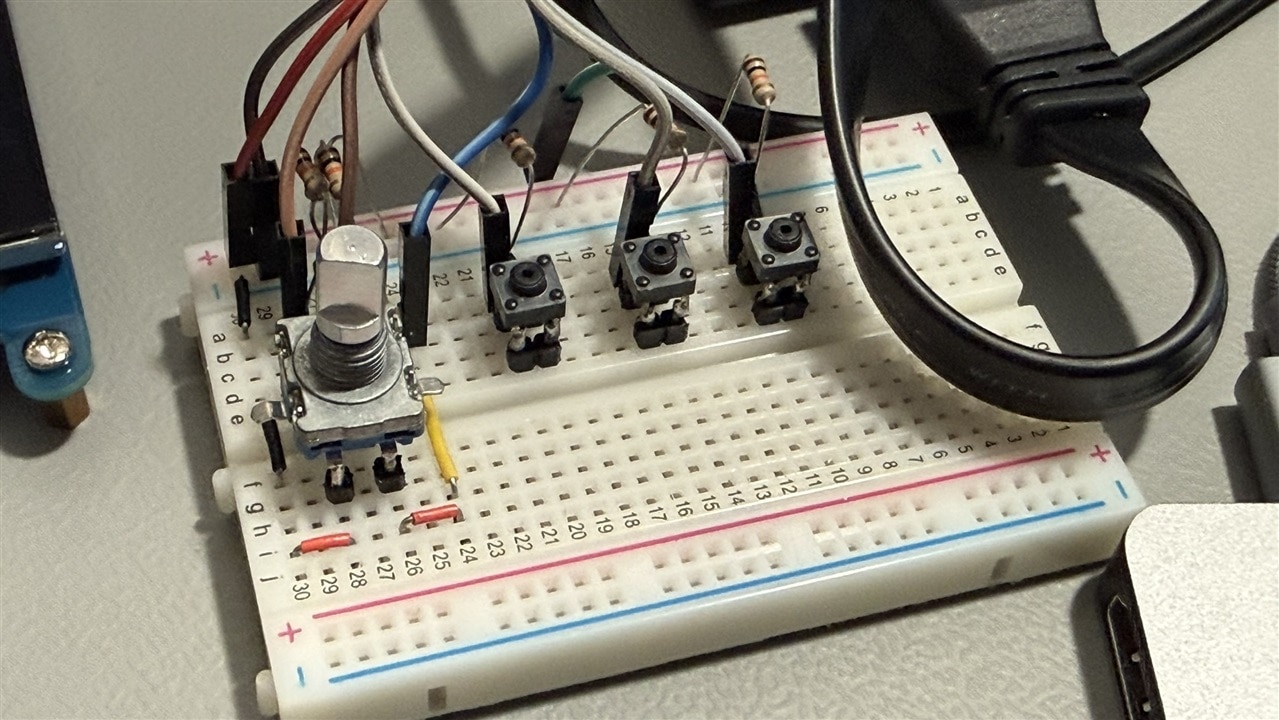

Wire physical controls
I used 2 types of controls:
  • Rotary encoders, type EC11, with CLK+DT pins and SW for push function. Each of these pins is connected to a GPIO, with a 10k pull-up resistor to 3.3V, and a common GND.
  • Push buttons, also connected between GND and a GPIO, with 10k pull-up.
Here you can find the mapping I used:

An additional pushbutton, already integrated in the IO board and accessible via dedicate header, is used for the soft power off and on, but the functionality was customized on the software to show a popup confirmation on the application, instead of exiting from the kiosk mode and show the OS desktop with a standard shutdown message.
Here you can see a short demo of my working setup:
