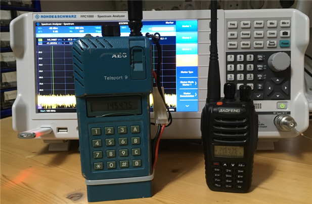

One of the first applications in which I tested the FPC1000 is the measurement of unwanted signals from my HAM radio transmitters.
I have two handhelds around, the first one is a Teleport 9 from AEG. This is a solid and very robust portable transceiver for the 2 m band. Visitors of the main Dutch airport (Schiphol in Amsterdam) may remember these brick-size blue handies being used by all airport service personel. The AEG Teleport 9 was part of a trunking network used by all services at the airport and has now been replaced by a more modern (and smaller) alternative. The old units ended up in the HAM radio community and have been converted by Rob Spijker, PE1RJY, into amateur transceivers covering the entire 2 m band.
The second one is a cheap Chinese dual band handheld Baofeng UV-5B.
The measurements were very easy to perform with the FPC1000. I first selected the frequency range, put the RBW at 300kHz and the VBW at 100 kHz. I used the radios in low power mode (0.5W) using their own antenna and just picked up the signal with a small wire in the input of the SA.
Then by pressing the marker menu 'Mkr' and pressing the marker 1, marker 2 and marker 3 successively, the three strongest signals will automatically be selected. I started with the Baofeng at 145.475 MHz, where the main signal and the second and third harmonic were selected. I kept the markers the same for the AEG. Finally I again tested the Baofeng, but now at 430.475.
Using the measurements menu of the FPC1000, it is possible to very quickly measure the harmonics of a signal. When you start a measurement, the R&S FPC looks for the first harmonic of the signal (= the highest signal) in the frequency range you have defined. The number of harmonics it looks for depends on the number of harmonics you have defined. It then adjusts the frequency axis so that all harmonics are visible.
In addition, the R&S FPC also calculates the total harmonic distortion (THD). The THD is the root mean square of all harmonics in relation to the power of the fundamental frequency. Details can be found on page 65 of the manual. The last two screenshots below shows the harmonic analysis of my Baofeng radio, on 145 and 430 MHz.
Here are the screenshots:
{gallery} Measuring Harmonic distortion
Baofeng 145MHz: second and third harmonic too strong
Teleport 9: Nice clean signal
Baofeng 430 MHz: better performance than at 145 MHz
Baofeng 145 MHz: harmonic distortion measurement THD = -28dB
Baofeng 430 MHz: harmonic distortion measurement THD = -41dB
The pictures speaks for themselves, the Teleport 9 has a much cleaner signal than the Baofeng at 145 MHz. To be honest, the Baofeng is not compliant with the regulations. In the Netherlands regulations state that unwanted signals must be  -60 dBc (60 dB below carrier signal). As you see in the screenshots, for Marker 2 and 3 the FPC1000 nicely shows the frequency distance to Marker 1 as well as the difference in dB, dBc so to speak. The last screenshot above shows some other signals which are picked up by the SA. They are not transmitted by the radio. A future challenge might be to detect the source of these signals.
