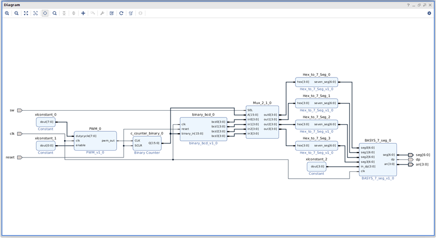

4x7 Segment to 7 Segment Mux
The next step is to use four instances of the hex to 7 segment display created above and add a multiplexer for enabling the display and selecting which digit is currently enabled.  The VHDL code is shown on the left and the block diagram is shown on the right.  The push button switches were used to enable and select the digit.  A combinatorial logic approach was chosen as there is not a need to use a clock for this as everything can be derived from a truth table.  I must say I don't know any of the nuances of VHDL yet, so hopefully my coding doesn't result in using 'latches'.  Using latches is considered a big no-no in IC design (unless there is actually a good reason for a latch).  I also uncommented out the three pushbutton switches in the constraint file, Basys3_Master.xdc ( not shown ).
PWM and Clock Block
There is a clocking wizard, that builds some Xilinx specific code for creating a different frequency oscillator form the 100 MHz oscillator.  This is a really import section as it will be used over and over again in other designs.  This is not a VHDL exercise, but another use of the IP that comes with Vivado.
Select Project Manager->Board->System Clock and a Connect Board Component pop up window will occur, select clock_CLK_IN1 and hit OK.
Setting up the clock blocks was pretty straightforward but I added the PWM block at the same time and as a result caused a bunch of problems and errors, although I was able to create a bit image, the results were discouraging.  The first thought was there was a problem with the clock MMC so I wanted to find out if there was anything special I needed to do to simulate the clock block.   I found a YouTube video that I sped watched,  Verilog Tutorial 21: Vivado Clock IP,  and it covered a simple simulation and I was able to simulate a post synthesis result, however I was getting errors with the Behavioral Simulation
Below is the results, when trying to simulate a "Behavioral Simulation".   There were quite a few error messages.
The post synthesized functional simulation did provide results that indicate that the clock wizard set up the clock correctly !
Because of the inability to run a Behavioral Simulation, I therefore decided to go back one step further, because debugging the post synthesized simulation didn't make sense because the internal signals were very difficult to figure out.  Of course this is even harder when the code was just plain wrong.  A new project was created with just the PWM and a very simple simulation, written in verilog, that was used to stimulate the behavioral simulation with enough initial conditions, to do something (OK I cheated a little, I used verilog for my simulation).   Breaking things down into atomic level is probably good practice for anyone new to either verilog, VHDL and/or Vivado.  Create a block independently and write a simple simulation.  This can save a lot of banging the head against the wall.
The test bench called pwm_tb.v ( written in verilog for convenience) and the pwm.vhd are shown below.  I had many iterations of the pwm.vhd until I figured out some of the differences between writing in verilog and VHDL, and I'm not going to guarantee that it is any good, but rather to demonstrate the use of the tools to learn the language, VHDL.
   In the simulation, the clock was sped up from 4MHz to 100MHz so that results would be available sooner, for each simulation turn.   If you notice the little red dots,  you can also step through by setting breakpoints.  That is a means of examining things more like software/firmware development.  If you are using VHDL variables,  you will only be able to access them in this mode,  as they are not currently supported in Vivado, and means you will probably want to use signals instead of variables where possible.
The simulation is shown below and it shows that a counter can be created with the output from the clocks block.
The pwm.vhd block was re-imported back into the previous iteration where I could not get a Behavioral Simulation to run, and voila, from that point I was able to make good progress.  There were a few changes made to the pwm.vhd block and the multiplexer block that takes the counter output to operate each of the 4 segments was tweaked as shown in the screenshot below:  I went online and utilized a VHDL Coding 10 Bit Decimal to BCD article in StackOverflow as the basis of finishing the aspect of binary to BCD conversion.
The final block diagram is shown below:
A short video shows the final result.

  • Thanks for the review - as I keep saying, Vivado and similar tools are monster pieces of software to get your head round, they try to be friendly but there is still a monster in there image
    BTW, here's a thought re design - why not put the hex to seven seg decoder before the multiplexor - I think you'l find it uses less logic and is easier to debug.
    And a second though:
    Learn to love synchronous (ie clocked) logic design - with FPGAs it's the only way (to do anything complex).
    Keep up the good work.
