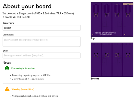

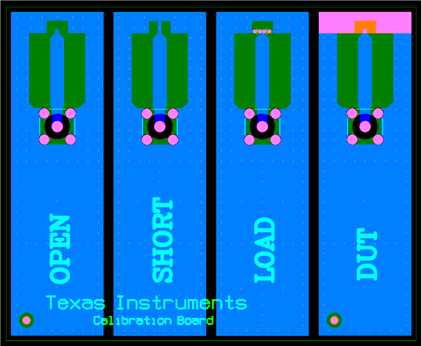

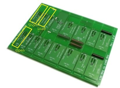

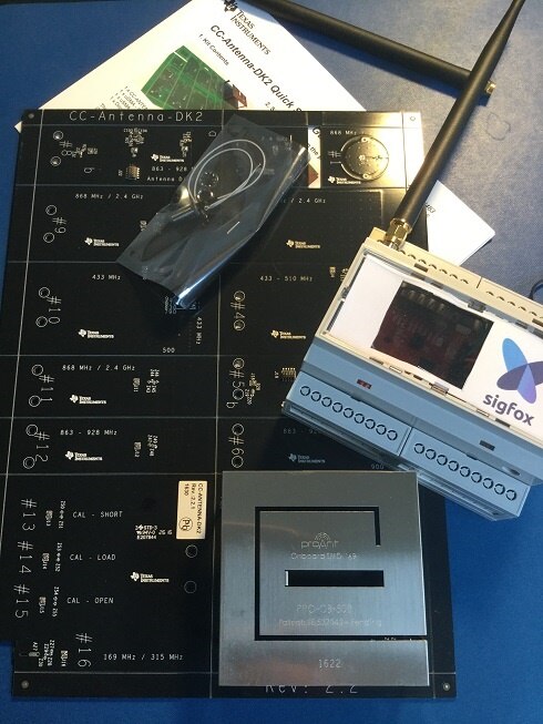

What were the biggest problems encountered?: I didn't have a decent calibration kit, but this is not a product issue, it is my problem. There was a minor bug that did impact me, but it is because I have an unusual wireless LAN setup. It is a simple bug-fix for R&S, and I have workarounds with Ethernet or USB for now.

Low-cost Calibration Method
Although this will not be anywhere near as accurate as the methods mentioned above, for basic testing, a home-made Open/Short/Load can be used. One method is to obtain connectors, and trim off the end and then attach either a short (e.g. copper sheet) or a load (e.g. a couple of 100 ohm resistors connected electrically in parallel).
Alternatively, at one point Texas Instruments offered an Antenna Design Kit with code CC-Antenna-DK however it is no longer available for sale. The kit included a printed circuit board version of an open/short/load with SMA connectors. Since the Gerber files are still available, it could be possible to get the PCB manufactured and build that up.
I edited the Gerber file, to remove the antennas, and it is attached below, ready for sending off to a PCB manufacturer.

  •   wrote:
    ... Also, it's great they included the SMA adapter cable too!
    That's the reason why I bought the two kits - I needed those adapters to mount your antennas on LaunchPads.
    It turned out that a set of these cables with shipping was hard to find for a price under two of these antenna kits (1 payed $98 for the two sets).
  • Hi Jan,
    It looks like a very useful kit! Also, it's great they included the SMA adapter cable too!
    EDIT: The DK2 OSL will likely have better performance over a wider frequency range, because the older DK design is more reliant on PCB thickness+dielectric constant, which has too much variation for low-cost PCBs.
  • Hi Gerald,
    Thanks for the links, I'd missed seeing the DK2 version!
    I just checked it out in a Gerber viewer (OSL portion shown in the image below), and it will be worth ordering it, or getting a PCB made for that too, since it uses the smaller connectors, which are on WLAN, Bluetooth etc antennas, to have a complete set for UF.L and SMA. I get the feeling life will be so much easier using the same connector on the OSL as the particular antenna under test. Meanwhile I ordered the SMA PCB last night from Elecrow, so hopefully I can try that out soon and report back.
  •   wrote:
    Hi   ,
    Thank you!
    Yes, I found a 2nd version of this RefDes board as well, CC-Antenna-DK2.
    CC-ANTENNA-DK2 Sub-1 GHz and 2.4 GHz Antenna Kit for LaunchPadTm and SensorTag | TI.com
    I bought two of those second generation antenna kits a few years ago, for a Sigfox project.
    They go nicely together with two sub-1 GHz antennas that kindly sent me.
    If you need close up photos of the calibration area, let me know.

    I found yet another way is to use a Texas Instruments Antenna Development Kit, known as CC-Antenna-DK. It is a PCB with a load of antenna designs on it, but there is also space on the PCB dedicated to an open/short/load! That area is highlighted in yellow:
    Unfortunately the CC-Antenna-DK is end-of-sale (and was a little expensive, although nowhere near as expensive as a real OSL calibrator tool), however the Gerber files for it exist!
    The board is quite large, so I edited it, and removed the antennas, and kept just the yellow OSL portion. I then added an optional space for device-under-test too, it is the same as the 'Open' portion of the design, but with the solder mask stripped off the end. not great, but maybe usable. I don't think I'm causing any copyright issues by publishing it (TI encourage people to use the antenna reference designs - but just didn't mention the OSL portion anywhere : (, but I will remove the file if I receive an objection.
    This is what it looks like:
    I've not ordered it from a PCB manufacturer yet, so I cannot guarantee there is no error. This is what OSH Park upload thinks of it:
    It is 80x65mm, and is double-layer, 1.6mm PCB.
    I'm going to build it (it is trivially easy, just needs some SMA connectors, and a couple of 0402 100 ohm 1% resistors to construct the load portion). The file is attached above to the review, as export-osl-gerber-r1.zip if anyone is interested to build it too.
