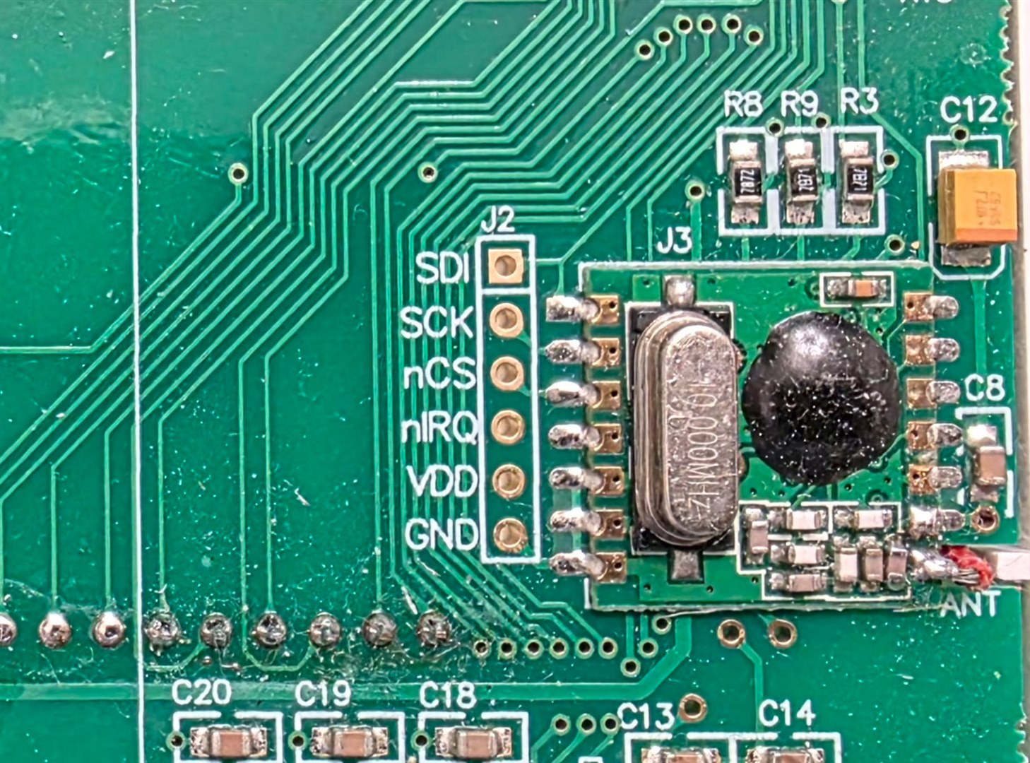

I have a pretty awful heating system controller at home; it never regulates the temperature all too well, and its user interface is buggy and difficult to use.
The controller relies on a radio transmission to switch the boiler on or off, and I fancied overriding the controller with my own custom system. This would involve reverse-engineering the radio protocol.
I was able to partially figure it out by probing around inside the transmitter, but the transmitter module was a black box (an unlabelled blob). I managed to narrow it down to possibly a Silicon Labs (Silabs) chipset range - perhaps Si443x series, and capture some of the bitstream using a logic analyzer.
It was a weird system, it used an out-of-band SPI interface for configuration, but the actual transmission was controlled through a kind of direct signal used for modulation on-the-fly (i.e. not a packet-oriented transfer from the microcontroller to the transmitter chip), at around 9600 bits per second, for a duration of about 176 bits. You can see this in the screenshot below, where firstly some of the purple data (configuration data) is sent together with the blue SPI clock signal, but then a load of purple data is sent without the blue clock signal changing. That clock-less portion of purple data is the direct signal that modulates the transmission, and that period length was measured to be 176 bits long, if the speed is 9600 bits/sec. The yellow signal appears to be an interrupt from the transmitter IC, paced at 9600 Hz, to act as a handshake to let the microcontroller know when it can apply the next data bit.
I didn’t manage to narrow down the SPI content to any specific chip, so I had no idea what frequency or modulation scheme was set up.

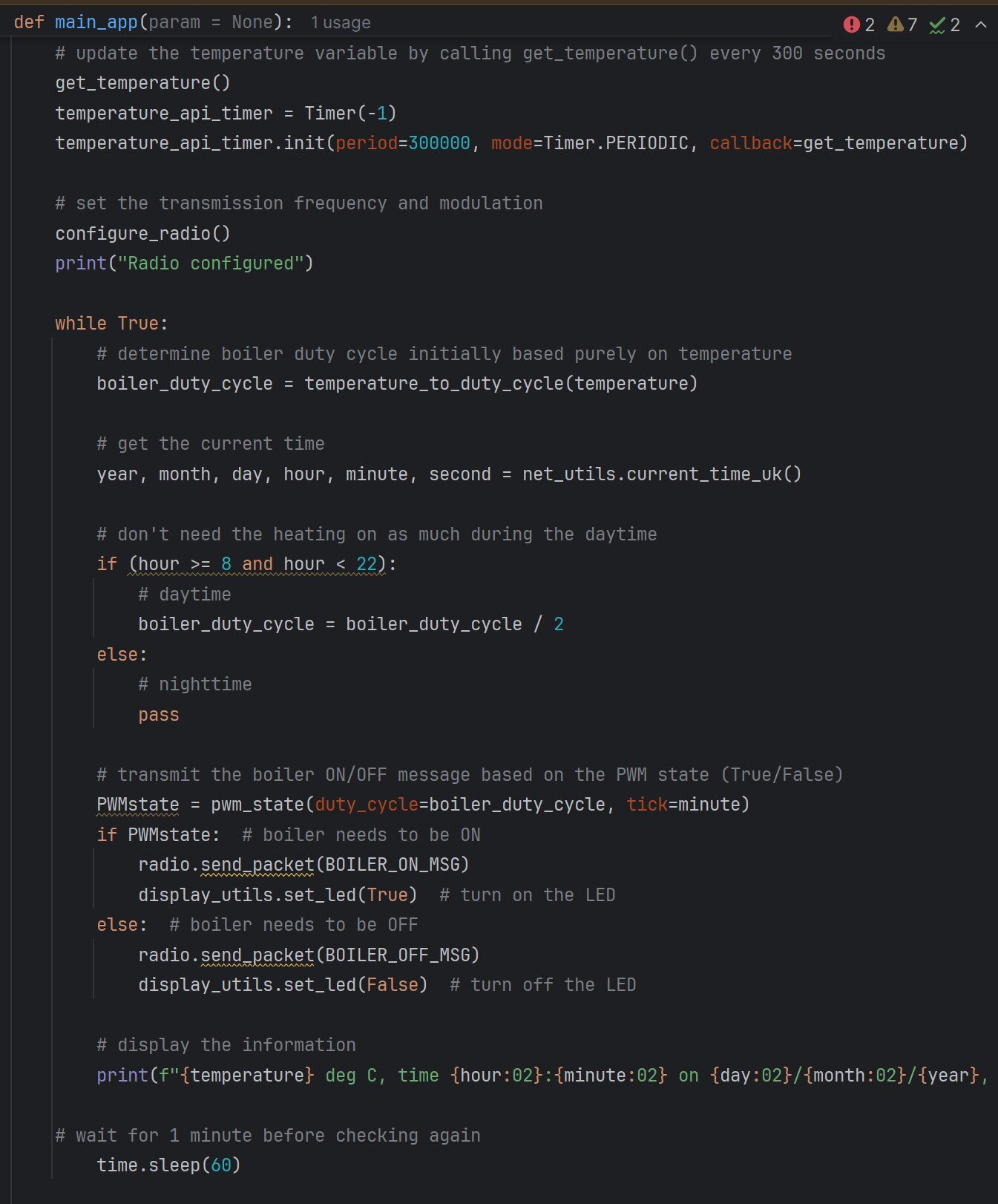

I attached the EBYTE module to a Pi Pico module, and wrote code to replicate the transmission. I used the R&S FPC Digital Demodulation functionality to troubleshoot the code, until the symbols looked similar, and then verified that it did indeed control the boiler. That still needs documenting, and so it is a write-up for another day. The photo below shows the EBYTE module dead-bugged onto a Pico-Eurocard board.

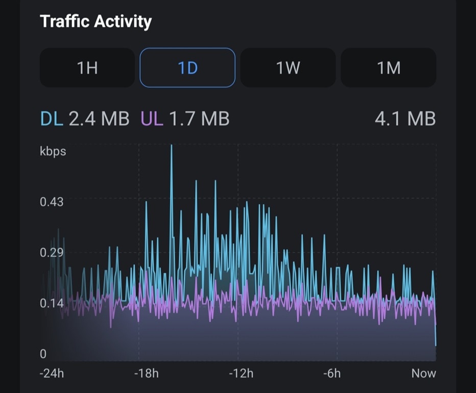

    shabaz 9 months ago in reply to shabaz
     I've been running the code continuously for the past fortnight, and it's been reliable. The screenshot shows the network activity over a typical 24-hour period (I've been checking this regularly).
    However, for the last day or so (I don't know the precise time on Sunday that it occurred), the network activity is different:
    It may well be API reattemps, but, I have no idea, because I cannot peek at any detailed status, nor observe error codes (there's no display, and no serial interface). Boilers themselves have interfaces (there are at least a couple of popular serial ones). I could implement a serial interface as one option. It could even be an API change (the fact that it occurred on a Sunday could be a smoking gun), although to me it seems the API response still looks approximately what I expect, when I test the API from a web browser).
    I've been working on a separate project to provide general external logging and alarms and data querying. It appears to function, but I'm refining it. At some stage I'll port that to this project.
    For now I could power-cycle the system to see if the traffic goes back to normal, but I'll give it a day or two, to continue to see what happens. Right now it's too warm for the boiler to switch on, but the heartbeat LED indicates that the main code loop is running, and the router log shows that the WiFi has not disconnected. There may well be bugs related to reattempts, but I've improved that greatly recently (not ported that across to the live system yet either) - a good tool is called WireMock, that allows you to simulate API failures, and I've been using that for testing (will write a blog at some point).
