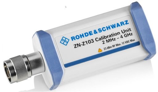

As mentioned, the easiest way is to use an electronic calibration toolelectronic calibration tool.
Image source: R&S websiteimage
It has a single N plug on one end, and a USB socket on the other. When the USB connector is plugged into the FPC1500, the calibration procedure can be used to electronically switch different reference impedances onto the N connector. Tables of calibration information are also built-in to the tool, so that the FPC1500 is aware of the precise characteristics of the tool’s impedances.

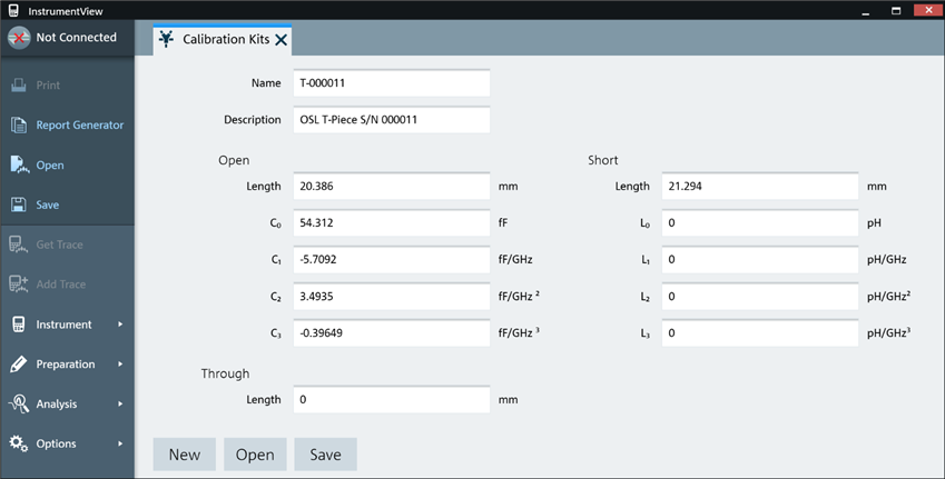

Without the electronic calibrator, an OSL tool can be used. I had to send off mine to be measured, and the returned file specified the parameters that I needed to load into the FPC1500.
The excellent software from Rohde and Schwarz, called InstrumentView, is used for that purpose. It allows me to enter in the information in a user-friendly manner, and it will convert it to a binary file for uploading (e.g. via USB) to the FPC1500.
Here you can see the parameters I entered for my OSL tool:
After that I clicked on Save to locally generate and save the binary file, and then went into the Instrument->File Transfer menu to transfer the file to the FPC1500.
Loading the parameters is just the preparatory part of the calibration procedure. Next, the calibration procedure is executed from the FPC1500 menu. It will prompt on the display to attach the OSL tool at the desired reference plane location in three steps, corresponding to the three impedances that the OSL tool offers.

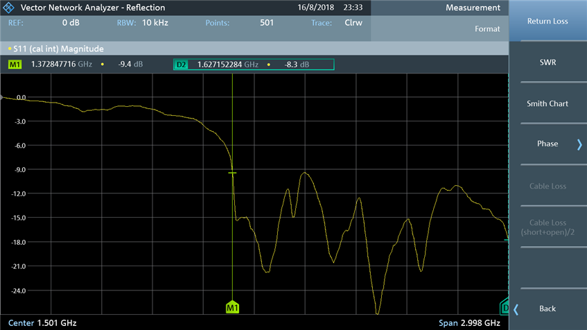

Another way of seeing the same information is to look at ‘return loss’. It shows the same information, just as a different conversion that shows more detail due to the y-axis being logarithmic. The SWR chart has everything cramped in the useful portion. In the return loss chart below, the marker is set to -9.5dB which is a return loss value of 9.5dB, that is equivalent to 2.0:1 SWR.

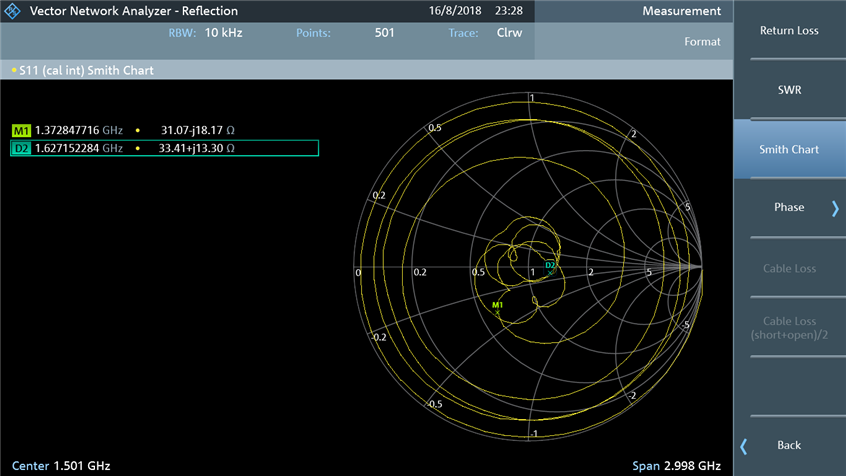

So far the charts have shown scalar information. Now we can go into the vector domain! The swirly diagram here is a Smith Chart. It is discussed in a lot more detail in the FPC1500 review linked to earlier. To cut a long story short, imagine the 0 to 3GHz line in the previous charts, laid out in a different way, which in the case of the screenshot below, happens to begin near the right side of the circular chart, spirals downward and inward, and finally ends up at somewhere else (near the center of the chart in this example).
Anything near the center of the chart corresponds to the antenna looking like a 50 ohm resistance at that frequency, and the loss would therefore be very low. Anthing far away from the center corresponds to an impedance that is not close to 50 ohms resistance. The green marker M1 corresponds to the 1.37GHz position on the swirly yellow line, and it is close to the center. The D2 marker is at a delta of 1.63GHz to M1, i.e. it is at 3GHz absolute frequency, and it too is close to the center.
The Smith Chart view is helpful because it graphically describes what needs to be done to the circuit in order to make the match closer to the center, for any desired portion of the spectrum. This too is discussed in more detail in the FPC1500 review.
