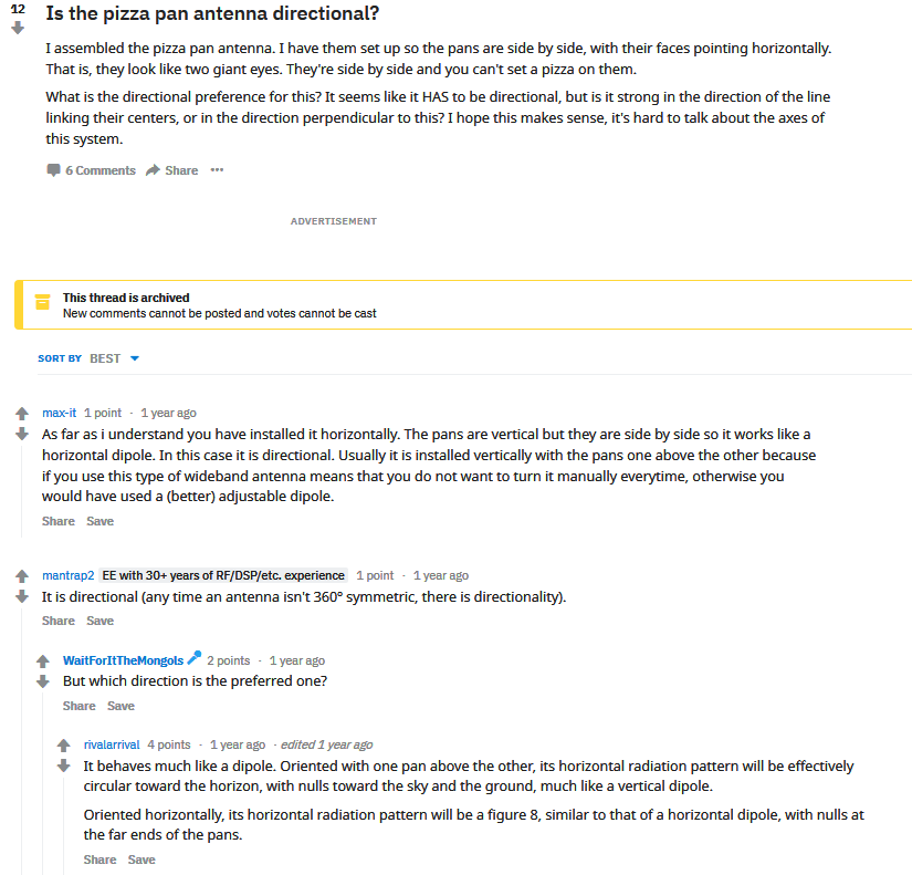

  • If I were to get serious about a proper TV antenna, it would be better done outdoors (to increase signal and reduce interference), as high as I could get it (while hiding it as much as possible from the neighbors and the HOA).  Probably I would have a dual bi-quad antenna (with a screen reflector) for the UHF channels, and a 2-element beam for the VHF channels, mixed with an RCA amplifier (these have a built-in VHF/UHF diplexer)-- then run a coax all the way to the central splitter that feeds the entire house-- then all of the TVs in the house would simply connect to where the cable used to go.  My cable modem would be the only thing connected to the cable company in that case-- (and I'm looking for alternatives to that-- perhaps a wireless link from LV.net).
    Probably, it would be much better if the pizza-pans were on a proper mount (edge-on board, or PVC pipe) and moved away from the wall-- Yeah, I thought about the rock-board attenuating the signal.  I *did* do a test where the 2 pizza-pans were mounted on cardboard, and in rotating the antenna, there was very little variation in signal-- maybe +/-1dBm broadside, and -2dBm at the edges of the antenna-- so this antenna is (weirdly) very omnidirectional.  I did not try vertical polarization though.  I might re-test all of this with proper mounting-- and move it to a proper thread (since this thread is about the instrument review).
    That said, with the FPC1500, you can actually SEE what you are doing, and what is happening with the SWR and the signal levels-- in real-time...  I have absolutely no idea how I managed to get by in years past without one of these instruments!
    -Ken
  • TV transmitters are required to support horizontally polarized antennas.
    Thats the bit that confused me as well. ...
    When you're talking about a dipole, it is essentially a donut. ... Its the best way to picture it.
    From what I read and your statement "...there ARE nulls at the edges ....", this tells me you have the 'donut' rotated 90 degs.
    I suspect the responder was suggesting that if the wall the pizza pans were on, was in line with the signal, it would be in the null.
    I also suspect that your SWR will improve by rotating it.
    You have a large lump of earth stopping the signal from freely transferring into a magnetic field, and this would have an effect on the antenna tuning at those frequencies.
    Be interesting to re-run the test if you have a chance.

  • In the USA, TV transmitters are required to support horizontally polarized antennas.  Some TV stations here use a left-over elliptical antenna from the old analog TV signal days-- but that will also support horizontally polarized antennas.  I know that some places elsewhere in the world, TV transmitters can have vertically polarized signals.
    Thanks for the link!  I did not know someone else had thought of the pizza-pan antenna idea.
    Yes, there is a pattern to the antenna-- but not as well defined as a "normal" dipole--- there ARE nulls at the edges, but other than that, the antenna does not appear to be very directional.  At the distance from that transmitters that I am, you could almost hang out some metal foil bubble gum wrappers and get a pretty good signal.
    --Ken
  • You may have better results rotating the pizza pans 90 deg.
    https://www.reddit.com/r/RTLSDR/comments/5ht4xx/is_the_pizza_pan_antenna_directional/
    There were a few posts using google on making 1:1 baluns from a variety of things, inc a length of coax wrapped around a 2 litre bottle.
    Most will have a bandwidth, and many of the posts were for transmitters so their construction was suitable for 100 or more watts.
