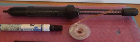

I ran a comparison between a low cost solder sucker ™ (item “A”), solder wick ™ (item “B”) and the 21-19700 station (item “C”) for different component removal.  I used RoHs solder in my test, since the resin-free solder seems to be more difficult to de-solder.  During desoldering, I used a flux pen (as shown) to prep the board before desoldering. After desoldering, I use isopropyl alcohol to clean the board.
The first test used components on a small pad test board.  Each solder joint was made using 1/8” strip of solder.  I then applied flux and de-soldered the components and compared the holes.
The results look very comparative, the pads using the “solder sucker” (A) looked a little worst on the component side.
The second test used components on a large ground plane test board repeating the procedure from test 1
Again the results looked very comparable.
