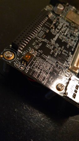

My initial idea was to build a AI vision based project with the Ultra96 board. The project hit a snag when while unpacking the board  I noticed the JTAG switch was kind of smashed at a weird angle.
Anyway , I tried to boot up the board and lo and behold nothing happened. After careful inspection I see that the traces near the switch were lifted.
The switch is connected to the bootstrap pins which define the boto method. If the pins are floating the SOC essentially does not boot up.
I ended up fixing it by soldering two resistors to the pins to the GND pin of the fan. This happens to be slightly dangerous since the pin adjacent to the GND pin the 12 V for the fan.Seems kind of weird that this got past QA.

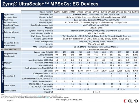

The UktraScale chips are a category apart compared to the common ZYNQ SoC.
.image   image
The Ultra96 uses a xczu3egsbva484 chip. This comes with four ARM-A53 cores and two deterministic ARM-R5 cores as well as MALI GPU.

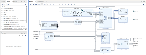

My second program was interfacing an ov7670 camera with the Ultra96. The OV7670 needs a 3.3V power input
so I had to generate a 3.3V from a 5V output. The block diagram is as follows.
At the moment  I still have to tweak the camera settings and revise the VDMA app instead of sending data via UART.
