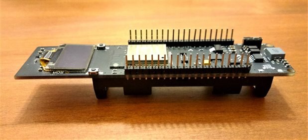

3.3 IoT current consumption
One common challenge of internet of things (IoT) devices is to reduce its power consumption so that they can make the best use of their limited available energy. Many microcontrollers and sensor support different operating modes to reduce power consumption. One way microcontrollers can reduce the consumption is by staying in sleep mode most of the time and only briefly waking up to perform their programmed tasks such as acquiring sensor data, processing it and transmitting it wirelessly. Here I will show how to use the DMM6500 programmatically to profile the current consumption of an ESP32 battery-powered microcontroller board.
The ESP32 is a low-cost 240 MHz dual-core microcontroller with integrated WIFI and Bluetooth support. My ESP32 board also comes with a 128x64 organic LED (OLED) screen, an 18650-battery holder, USB-bridge and battery charging integrated circuits (ICs) and LEDs.
There are many different approaches to reduce the ESP32 power consumption (clock speed reduction, wireless usage minimization, ultra-low power (ULP) coprocessor usage, etc.), but I will only explore the sleeping modes of the microcontroller. The ESP32 provides two sleeping modes, light and deep sleep. Light sleep keeps the current state of the microcontroller and allows it to continue the execution from where it went to sleep, Deep sleep, on the other hand, requires the reinitialization of the microcontroller.
To measure the current consumption, I wrote a simple ESP32 program that sets pin 21 high 5 ms before and after doing any of the following tasks:

I used a power supply at 3.7 V to power the microcontroller battery connectors with the DMM6500 in series to measure the current. Instead of manually waiting for the trigger to detect a rising edge, as in the previous audio experiment, I used the trigger through a trigger model. A trigger model is program that run on a separate processor and coordinates measurements and trigger inputs and outputs. A trigger model can be built either through the instruments interface or programmatically. My trigger model begins measuring current as soon as it detects a rising edge at pin 21 of the ESP32. The code to build the trigger model and its graphical representation are shown below:

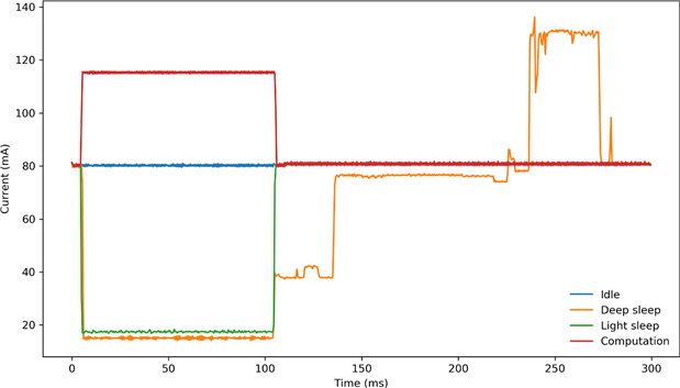

Measurements were repeated 16 times, averaged and decimated to reduce the effect of current spikes in the plot:
The results show that deep sleep consumes the least amount of current (15.1 mA), followed by light sleep (17.4 mA), Idle (80.2 mA) and computation (115.3 mA). It is interesting to note that there is an important difference in the time overhead between the light sleep (0.6 ms) and deep sleep (168.4 ms).
To measure the charge overhead to entering and leaving a sleep mode I measured  the consumed charge for  0 ms deep and light sleep modes:
The plot shows that the net charge overhead compared to idling is almost negligible for both sleeping modes. With these measurements we can calculate when each of the sleeping modes should be used. For my specific board and test firmware I found that for periods shorter than 1100 ms, light sleep consumes less charge than deep sleep, past that threshold deep sleep consumes less than light sleep.
