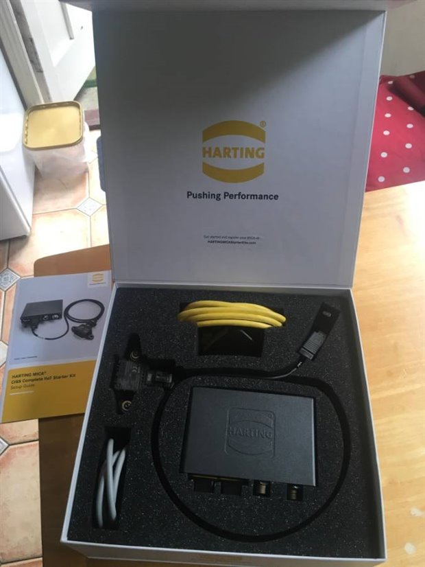

What’s in the boxes?
{gallery} Unboxing
HARTING MICA USB

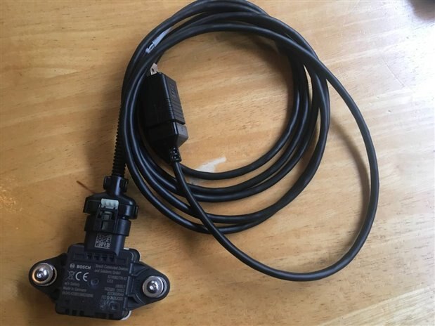

Bosch CISS sensor
As part of the IIoT kit, HARTING have provided a Bosch CISS multi-function sensor, together with a pre-configured LXC container that interfaces with the sensor. CISS is a Bosch acronym that stands for “Connected Industrial Sensor Solution”. Bosch themselves also provide example Python code that reads the sensor data and writes it to a *.csv file. There are also Bosch iOS and Android apps that allow you to view sensor data on a smartphone or tablet.

Mounting the CISS
The CISS has two mounting holes which can be attached to the device under test by bolts/nuts, or by the included magnetic mounts. Nb. To obtain accurate magnetometer readings, the magnetic mountings must be removed and the sensor should be mounted using bolts/nuts.
The light meter is on the back of the Bosch sensor, which means that light level readings are likely to be lower than expected. If required, the sensor could be mounted with the light level meter on top, but mounted that way round, the protective membrane for the sensors could be damaged more easily.

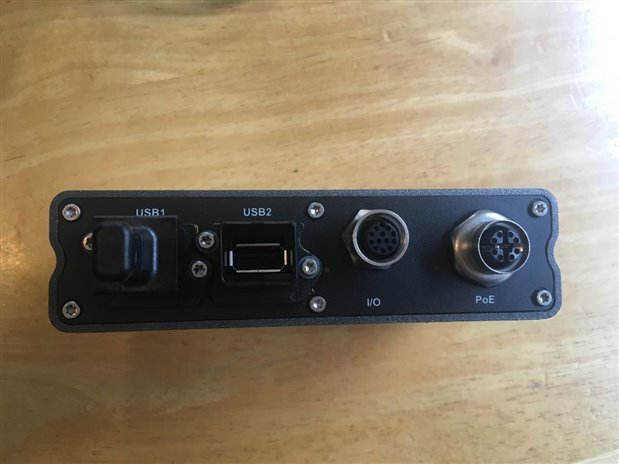

Cables and connectors

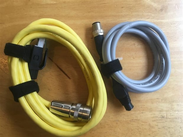

The cables provided with the kit are:
  • A M12 X-coded PoE network cable with a HARTING push-pull RJ45 connector on the other end.
  • A 1m-long 12-core GPIO cable using M12 A-coded connector on one end and 2.1mm centre-positive socket at the other (for connecting to a power supply).
  • A HARTING USB Push-Pull CISS cable for the Bosch CISS sensor. This is a USB connector fitted with a plastic shroud that provides IP67 compliance and a “click shut” latch to hold it firmly in place.
A HARTING Push-Pull USB port protection cover was also supplied to maintain IP67 compliance for the spare USB port. However, there was no protection cover provided in the kit for the GPIO socket (for example if the MICA is powered via PoE), but I was able to buy onebuy one for around £3.00.

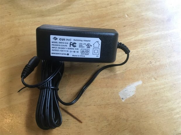

Power supply
Supply voltage for the MICA base unit is specified as between 12v and 24v.
The MICA is obviously intended to be powered via the PoE-enabled network connector. However, you could alternatively use the supplied GPIO->2.1mm centre-positive connector and the 12v 1A switching power supply. Although it is convenient to be able to power the device even if you don’t have PoE, the provided cable has been sealed (presumably to maintain its IP67 rating) and prevents access to the GPIO ports. If you need to access the GPIO ports, you will need to make your own connector.
The supplied power supply (with US plug) did power up the MICA base unit, but it didn’t seem to have enough power to fire up the Bosch sensor as well, so I re-purposed a 12v 1.5A power supply from an old router and this worked reliably. At the other end of the voltage range, I also successfully used a 24v 5A power supply.
Another point worth mentioning is that if you do power the device via PoE, the GPIO pins are unpowered.

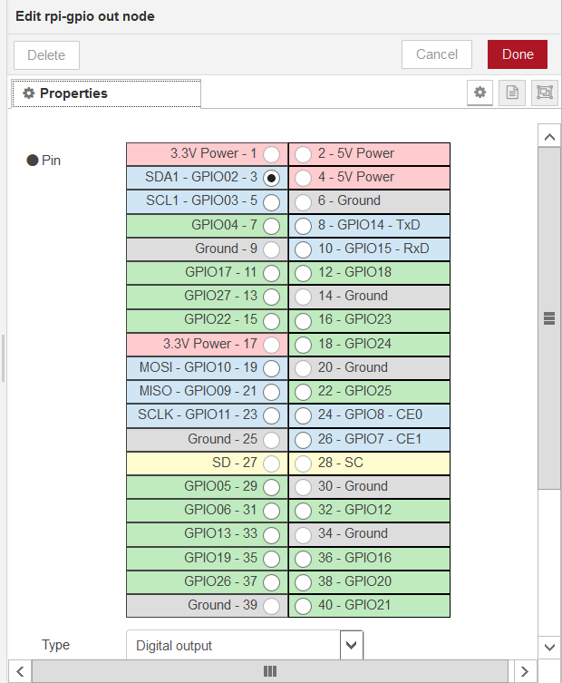

My next test was to install the HARTING GPIO container so that I could try out some automation using NodeRed. As previously mentioned, the GPIO cable provided only has a 2.1mm power socket on the other end – preventing access to the other GPIO pins. Not wanting to mess this cable up, I bought a spare GPIO cable and made my own breakout board. The HARTING documentation for the GPIO connector (contained in the HARTING HAIIC MICA Hardware Development Guide) was a little difficult to follow because the pinouts for the socket wiring were on a different diagram from the GPIO channel assignment. Channels can be configured as inputs or outputs and the GPIO voltage matches the input voltage (shown below as +24V, but can be 12V or anywhere in between).
Also, the pin number addressing in the GPIO container is not the same as MQTT. For example, “pin7” in the GPIO app needs to be addressed as “pin6” in MQTT. I combined them into the table below:
Wire
Colour
Channel
MQTT
GPIO
1BrownLS2/OUT7pin7pin8
2BlueLS1/OUT6pin6pin7
3WhiteSWD1/D4pin4pin5
4GreenHS1/OUT0pin0pin1
5PinkHS3/OUT2pin2pin3
6YellowHS2/OUT1pin1pin2
7BlackHS4/OUT3pin3pin4
8GreySWD2/D5pin5pin6
9RedSWS2/S5
10VioletSWS1/S4
11Grey-pink+24V
12Red-blueGND
This made it easy then to wire up my breakout connector so that each GPIO pin is lined up in numerical order.
Now that I had a usable cable, I was able to connect a switch and a relay to two of the GPIO pins and manipulate them using the HARTING GPIO container interface screen.

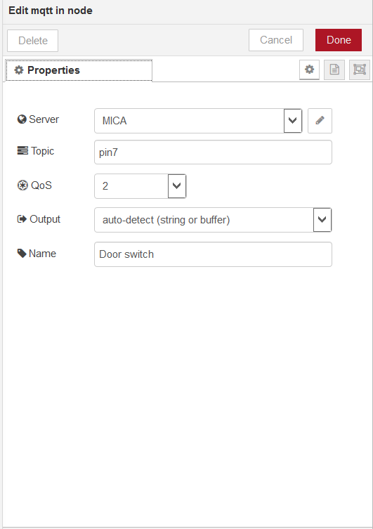

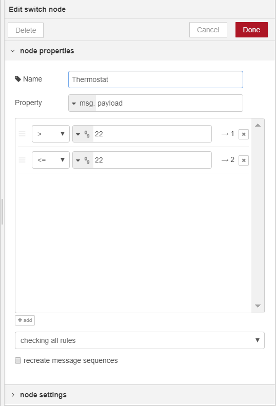

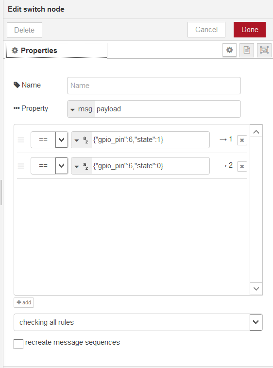

Once this was working, I used MQTT and NodeRed to implement some simple automation.
The first example is to replicate the situation in a factory where a rise in machine temperature triggers a relay-controlled fan to cool the machine down again.
I attached the Bosch CISS sensor to my “machine” (which was actually the Linix motor provided for the New Year’s Grab Bag RoadTest). I created a flow in Node-Red that sets GPIO pin1 high (and actuates a relay connected to that pin via my breakout connector) when the temperature reading on the Bosch CISS sensor exceeds a specified value, and turns it off again when the temperature reading drops below a specified value (in reality, I would allow for hysteresis between the on/off temperatures to prevent oscillation, but that would have made the video too long!).
{gallery} Node-Red
I connected a toy POV  fan motor to the relay to cool the motor.
Surprisingly the draft from the toy fan was actually enough to cool the motor down, whereupon it turned off.
Because the MICA is Internet-connected, the factory owner could monitor this process remotely. This might seem a trivial example because a thermostatically-triggered fan does not need a fancy IIoT device like the MICA/Bosch combination to do its job. However, what this example demonstrates is that the MICA’s hardware is capable of interfacing with other devices, and that those devices can be part of the overall Internet condition monitoring solution.

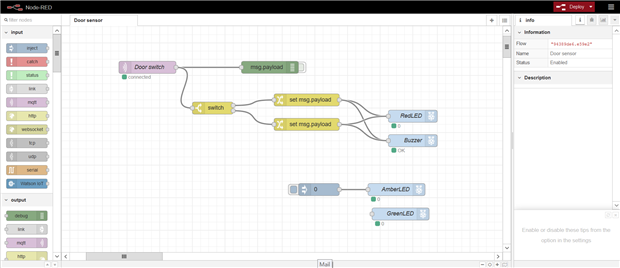

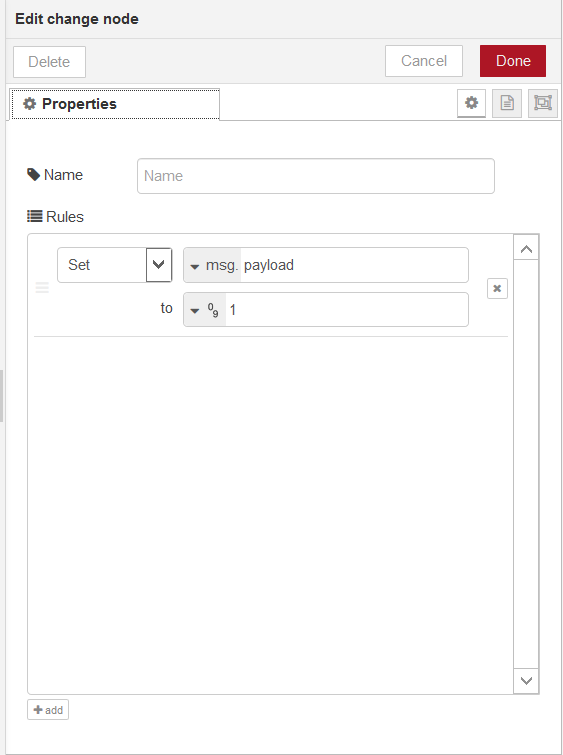

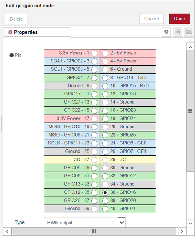

The second automation example is where an open door in the factory triggers an alert over the network (or Internet) that switches on a red warning light on another device (I used a Raspberry Pi) in a different place.
{gallery} RPi Node-Red
Once again, separate alarm systems could be used for this, but it is just an example of how the MICA supports simple-to-deploy automation that is not limited to the hardware included in the IIoT kit.

As an initial test, I took some accelerometer readings from the engine bay with the engine ticking over at 900 rpm and then revved up to 4000 rpm (twice).
For the actual on-road testing, I didn’t want to cause any safety issues, so I made sure that everything was inside the passenger compartment. The most difficult challenge was finding some ferrous metal inside the car to mount the Bosch CISS onto, given the preponderance of plastic and cloth in a cheap Ford interior! I found a reasonable mounting spot on one of the brackets that holds the rear passenger seats in place.
The first journey was a 38 minute stop-start journey across South East London and the second was a 40 minute journey on a mix of roads, including some dual-carriageway (a.k.a. freeway) cruising.
The data from the 40 minute journey resulted in a csv file with over 1.6 million rows (which comfortably exceeds the latest version of Excel’s 1,048,576 rows limit image ) and nearly 5 million data points, but MATLAB handled it easily. I was impressed that there were no obvious errors or outliers in the data collected, even though the boot (trunk) of a car is a bit of a hostile environment for any kind of computer.

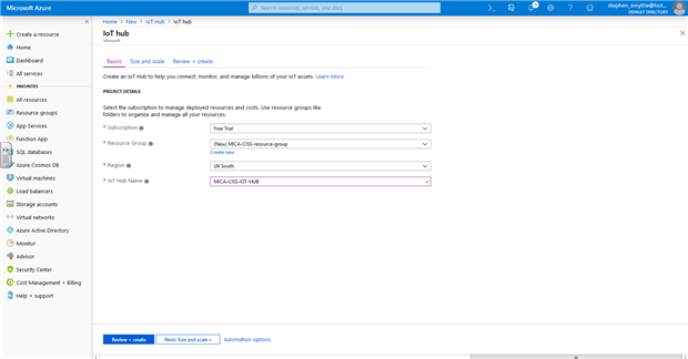

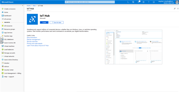

I mentioned above that, as an alternative to MATLAB, you could use Microsoft Machine Learning to help with analysing your data. To do this, you will first need to send your sensor data to the Microsoft Azure Cloud. Assuming you already have an active Azure account (free ones work fine), it is simply a matter of allowing the MICA MQTT container access to the Internet, adding an IoT Hub in Azure and configuring the Azure IoT Hub node in Node-Red with the primary key connection string that Azure automatically creates for you. I worked through these steps and was able to see the telemetry messages on my Azure account moments later.
Having configured the IoT Hub in Azure, you then need to set up a storage account in Azure (I used Blob storage) and a Stream Analytics job to send the data from the IoT Hub to the Blob storage. Now, all the data being sent from the MICA, via Node-Red, to the IoT hub in Azure is being stored in the Azure cloud. The gallery below shows the steps that I used:
{gallery} Azure

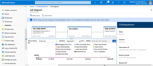

To prove that the data streaming and storage process was working, here is a screenshot of what (some of) the data looks like in Azure Blob storage after I had downloaded it back down to my PC and opened it in Notepad++.
