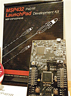

LaunchPad MSP432
The MSP432 LaunchPad allows to develop ultra low-power devices (thanks to the characteristics of the MSP430/2 family), keeping high performance through the use of Cortex M4.
The board has a MSP432P401R that works at 48 MHz, with 256 KB of flash and 64kB of RAM.
We find two user buttons and a reset button, as well as a red LED and an RGB LED.
Finally it comes with 40 pins for the Booster Pack.
The characteristic that is very useful is the presence of a programmer/debugger, accessible via USB. Thanks to this we not only can program and test the code without using additional tools, but also we can measure the total energy consumption of the system.

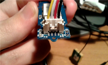

For our application we need a GPS module, which in this case will be the E1612UB (GPS v1 module from Grove System).
We connect the module as shown in the pictures (grey >> GND, violet >> 5V, blue >> TX, green >> RX).
All the sensors we need are already integrated into the board.
