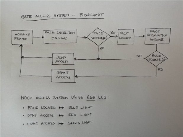

From a functional point of view, the gate access system can be represented by the following functional blocks:
  • image capture
  • face detection
  • face recognition
The picture on the right illustrates how the flow is organised. For sake of simplicity, the gate control block is mocked using the RGB LED available on the board.

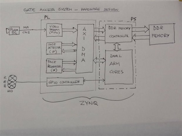

To be able to define what hardware is needed to implement the system, let’s go through our requirements again: the system needs to be able to capture video from the Pcam 5C (input) and make the stream available for processing. For the output, the only must is to be able to drive the RGB LED, although having also a display available via HDMI is a nice to have. For the processing of the image, I’m going to use machine learning algorithms, which can be accelerated in hardware. Xilinx has been very active on the machine learning front, providing many tools and libraries which contain hardware accelerated cores, that can be used “out-of-the-box”.
As starting point for hardware implementation, Digilent has made available several reference model for their boards on GitHub. There are a few repositories for the Zybo Z7-10, but none of them offer support for the Pcam 5C. There is a workshop example platform, which targets the Zybo Z7-10 and the Pcam 5C, which can be used as a starting point. Also, to gain more insight on what IPs are needed to create a working video pipeline, and also to extend the system to include the GPIOs (LEDs, switches, etc), it is useful to take a look at how it is implemented for the Zybo Z7-20 (which include Pcam 5C support).
The picture below shows the high level design for the hardware platform (the control signals are not shown).
Lets explain what the blocks do, starting from the video processing. The VIDEO STREAM block implements the MIPI CSI-2 receiver interface, decodes the data and produces a FIFO data stream. The data stream is stored on the board DDR memory thanks to the AXI DMA (Direct-Memory-Access) block.
This is necessary, as the system will not process real time video stream, but only single frames extracted at specific time.
The processor will initiate the face detection stage and orchestrate the data transfer to the FACE DETECTOR custom IP block. Again, DMA is used to transfer data across. Similarly, if the FACE DETECTOR will signal a positive detection, the FACE RECOGNISER will fetch the frame data to process the recognition using DMA. Finally, the GPIO controller (which will also implement a PWM module), controlled by the processor, drives the RGB LED on the board.
All the blocks are available on Vivado as free IPs, except the 2 custom IP that deal with face detection and recognition, which will need to be implemented. For face detection, I have found a nice implementation, which can be used with Vivado HLS to create the IP from C code. The code can be found here.

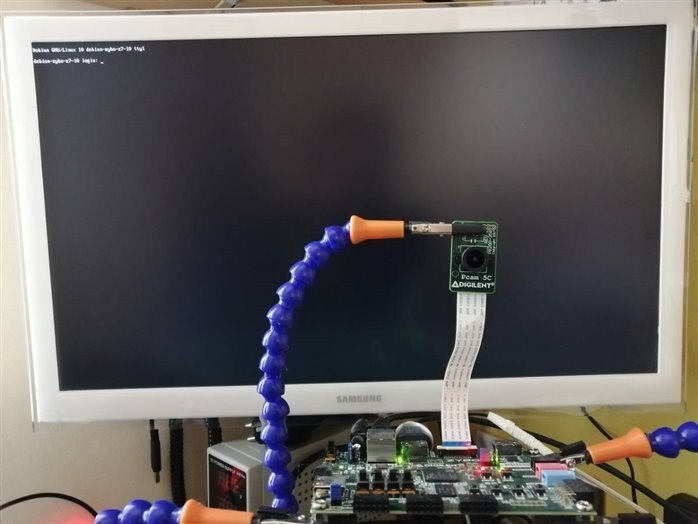

As said, I am not using the Petalinux root file system, but I am creating a Debian Buster based root file system. This link explain pretty well how to "bootstrap" a root file system for armhf architecture (which is our ARM Cortex-A9) from a host platform. The only changes needed are relative to the Debian distribution used (I am using buster and the respective repositories) and the specific information about the system (like the hostname, partitions, etc...).
Once the basic root file system has been created, and copied onto the SD card, such card can be used to boot the Zybo (make sure you set the jumper JP5 on the board on the correct position). This standard build should allow the use of the the Ethernet  and the HDMI output port on the Zybo, which means the board can be connected to a monitor and to the Internet (which is a requirement, in order to be able to configure the system according to the need of the Gateway Access application.
On the right, you can see the picture of the Debian Buster login console on the Zybo.

Putting all together
The video below shows a demo of the face recognition controlled access gate. To test the application, the setup is pretty simple. To make it easier for the demonstration, the camera will detect photos shown on the computer monitor.Side by side with the photos there is a terminal connected to the Zybo, to show the logs on the application.
I am presenting the camera 3 different photos: two are positive match (me and Franco, allowed access) and one is a negative match (Enrico Fermi, not present in the list, access denied)
As can be seen on the video, both the face detection and the face recognition take quite some time (on average face detection takes about 1 second, and face recognition close to 30 seconds). Unfortunately this is due to lack of hardware acceleration, as the 2 ARM cores only run at 667MHz!
Although very disappointed with the time response, I'm quite please with the accuracy of the system, which is well over 90%. In the video, all three samples are correctly classified.
