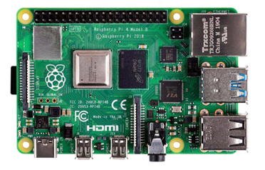

The Raspberry Pi 4 was worth the wait
Rpi 4B 2GBimage
The Rpi 4 is the latest in the long line of Pi's and comes in several flavors. I am reviewing the 2GB version. You can get the Rpi 4 in 1GB, 2GB or 4GB of RAM. This range of RAM sizes opens the door to so many more projects. With the faster processor you can easily use the Rpi 4 for everything from a simple weather station to a network sniffer or a home server for sharing of music, video and files. The list of possibilities was endless under the Pi 3 line and the limits were just pushed back, way back. The specs of the Rpi 4 are at the end of the review.

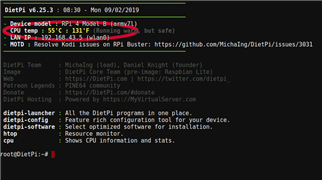

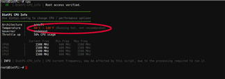

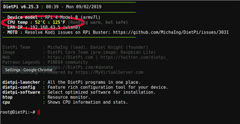

The Rpi 4 runs HOT. I tested my Pi first with no heat sinks (not recommended), with heat sinks and finally with heat sinks and a fan. The numbers are below but it is no surprise that running the Pi with heat sinks and a fan keep it much cooler. Why do you care? First, heat kills electronic components. Keep them cool, they last longer. Second, the Pi monitors the CPU heat and at around 80* C it starts throttling the CPU. So the Pi will automatically slow the CPU to reduce heat. A Rpi 4 with no heat sinks or fan will hit that 80*C pretty quick if it is doing anything.
Temp immediately after a stress test, no fan, no heat sink.      Running with a heat sink and fan. Running cool.imageimage
The Raspberry Pi Foundation released a firmware update to the Rpi 4 to help with the heat issue. I recommend applying that updated firmware it will save you a couple of degrees C right out of the box. Throw in some heat sinks and fan. The case I use comes with the heat sinks and fan and the is virtually silent so no issues there.
Idle temps of the Rpi 4 before and after the firmware update that addresses excessive heatimageimage
