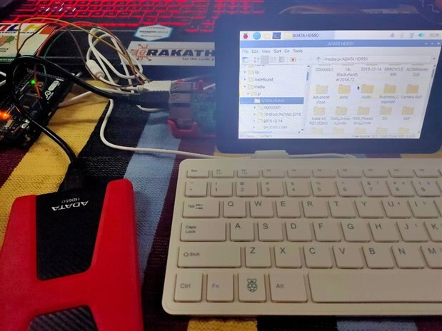

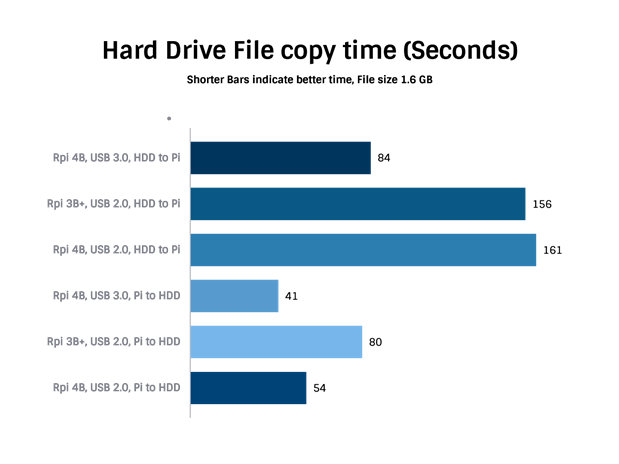

3.) USB 3.0 Real World implications
One thing that stopped the Rpi 3B+ from being a truly great NAS (Network Attached Storage) device was that the device had only USB 2.0 ports. Sure, you could connect external hard drives and USB sticks to the USB ports, and even boot from a pendrive via USB but USB 2.0 is still slow. To find out just how much of a difference it makes in a real world scenario, I tested the Raspberry Pi 4B's USB 3.0 and 2.0 ports and the Raspberry Pi 3B+ by copying a 1.6 GB file from a Hard drive to the Pi, as well as from the Pi to the Hard drive. The results were pretty evident even though the Hard drive I used was a 5400 RPM ADATA 650 USB HDD, so I was pretty far away from maxing out the USB 3.0 spec. The results are compiled below:
The Raspberry Pi 4B connected to a USB powered HDDimageimage
4.) USB Bandwidth and Modifications
Providing two USB 3.0 ports was not the only thing was changed on the 4B, the underlying controller was changed as well. The Raspberry Pi's earlier than 4B used a LAN7500 Series chip, which shared a single USB connection on the SoC between multiple USB ports and the Ethernet controller. Because of this, the Ethernet controller on the 3B+ was bottlenecked. True Gigabit ethernet on the Pi has been a demand for quite a while now, and the LAN7500 chip meant that the speeds never got over 480 Mbps. Using a tool called USBtop, it was easy to visualise the difference between the two boards. USBtop can be installed with the following commands:
$sudo apt install usbtop
$sudo modprobe usbmon
sudo usbtop
The first Image is of the 4B where there are 4 Bus ID's (for the 4 USB ports) while the Rpi 3B+ has 2 Bus ID's with 7 device IDs (one of them being the ethernet port, no doubt). This has very important Implications for the usability of the Pi for applications that require both external storage and a fast Ethernet connection. Now, one will not bottleneck the other. The Bandwidth while doing various tasks (such as typing on a keyboard, using a mouse, transferring files to and from a hard drive) can be seen in the image gallery below:

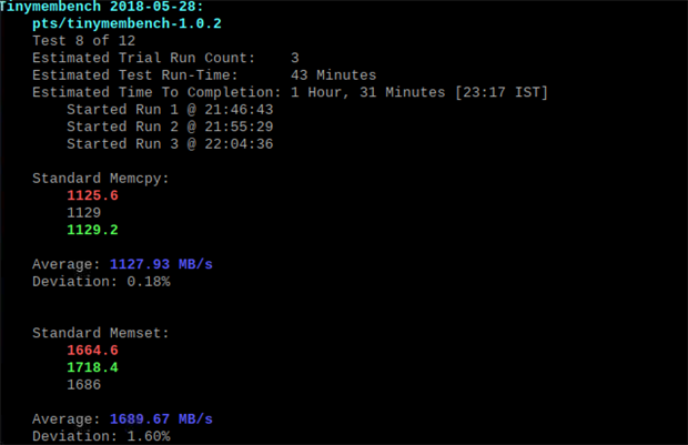

After running RAMspeed SMP, I ran Tinymembench (Github: https://github.com/ssvb/tinymembench  ) which is described as:
This is a simple memory benchmark program, which tries to measure the peak bandwidth of sequential memory accesses and the latency of random memory accesses. Bandwidth is measured by running different assembly code for the aligned memory blocks and attempting different prefetch strategies.
The results of Tinymembench for 4B and 3B+ are given as follows:
Again, the gulf in performance in the 4B and 3B is pretty pronounced, with the 4B being 2X of the 3B+image

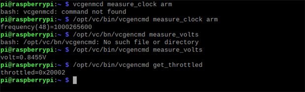

12.) Thermal Characteristics and throttling management
The heat generated by the 4B has been a talking point. It is said to run hotter than its predecessors and for many throttling was a real concern. The Raspberry Pi's now come with a heat spreader, and many people go the extra mile and install a heatsink and fan to further reduce the temperatures. To test out if these are actually useful, or if the Pi throttles under heavy load, I used the following commands:
//To measure internal CPU temperature
/opt/vc/bin/vcgencmd measure_temp
//To measure CPU Clock speed
/opt/vc/bin/vcgencmd measure_clock arm
//To measure CPU Voltage
/opt/vc/bin/vcgencmd measure_volts
//To measure CPU Throttle, if value is not zero something is wrong
/opt/vc/bin/vcgencmd get_throttled
While running CPU Intensive Benchmarks such as Tensorflow, The following temperatures and core utilisation % was observed:
82 degrees Celsius is no Joke, the values of clock speed, voltage and throttle indicated that there was some throttling happening when the temperatures went over 80 degrees.image

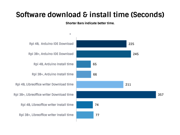

14.) Common Software install times and browsing
To test out real world use case scenarios, I installed a couple of commonly used software and noted down the dowload and install times. I then uninstalled the software, and proceeded to redo the process. The times are given in the graph below:
To check the general browsing experience on both, I opened 6 chrome tabs on both and noted down the RAM usage. Its difficult to quantify but the 4B felt much smoother at switching between tabs, there was less jitter and lag and in general, it made for a more pleasant browsing experience. The free -h command can be used to check the amount of RAM at any given time.image

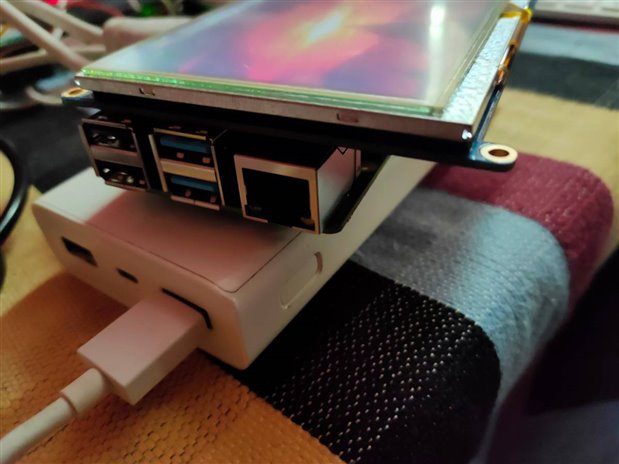

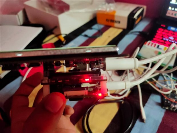

15.) Powering the Raspberry Pi 4B - Powerbank and PiJuice testing and Battery drain test
Due to the increased current draw and overall greater power consumption, I had my doubts over the portability of the RPi 4B. I usually depend on generic off the shelf power banks to run my setups in a portable manner, and my 20,000 mAh Mi Power bank was only rated for 2.4A maximum at 5V. This is noticeably lesser than the 3A at 5.1V supplied by the official power supply. I needed to check the system at full load to know if there was a chance of the Pi abruptly shutting down incase the current was insufficient, but I faced no problems running it from the power bank at even 100% CPU load. This shows that the RPi 4B can operate in a 12W envelope.
I also tested a popular HAT, the PiJuice with a really small 1800 mAh battery. Although the battery drained rather quickly with everything attached (about an hour), the Pi had absolutely no problems running off it. I also had a 5 inch WaveShare LCD display with me, which worked great with the 4B! I used the Pi Power app on the google play store to estimate the run time.imageimage
