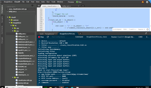

2.4 Cloud9 IDE
You can use any code-editor you feel like, but the free-software Cloud9 is good for everyone.
You can change theme, select comiler, write makefile, etc. And that is out-of-box configuration, simply plug the power by connect USB-C cable with the desktop computer and type 192.168.7.2 in any brower, like Chrome. USB-Net works and brings into the cloud9 UI.

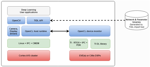

3.4 USE TIDL in Linux APPLICATION
Here is the diagram
Even you are in blank and know little about TIDL or TICL, use of TIDL is simple,
First , create EOP and select DL engine with Vision Engine and DSP
    uint32_t num_eves = 0;
    uint32_t num_dsps = 2;
        if (! CreateExecutionObjectPipelines(num_eves, num_dsps,
                                        num_layers_groups))
            return false;

3.6 Code your program flow , then test and run with
sudo mjpg_streamer -i "input_opencv.so -r 640x480 --filter ./$(TARGET)$(EXE)" -o "output_http.so -p 8080 -w /usr/share/mjpg-streamer/www"
Your project runs as filter to opencv Streamer in there part, as bool filter_init(), filter_process(), filter_free() in the dummy file

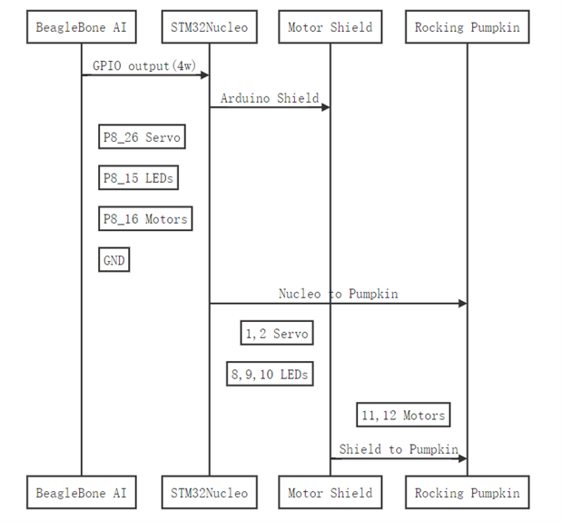

5. Brief of  Reference Animation  Project of Scary Pumpkin
5.1 Using Computer Vision Deep Learning model, camera can detect your appearance and start rocking this scary pumpkin just before the SCARY DOOR.

5.4 Sketch of Thread runs on STM32-nucleo
void setup() {
    // initialize serial communication at 9600 bits per second:
  Serial.begin(9600);
  while (!Serial) {  }
    // Pin Setting
  pinMode(buttonPin, INPUT);
  myservo.attach(9);  // attaches the servo on pin 9 to the servo object
  rockX.attach(11);
  rockY.attach(12);
  pinMode(LED1, OUTPUT);
  for(int i=3;i<9;i++)  pinMode(i,OUTPUT);
