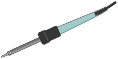

The tool survey was broken into three areas, comfort, construction and controls. In the Comfort section, test subjects were asked to provide feedback on their user experience with the tool. The Construction section was to provide feedback on the physical aspects of the unit. The feedback in the Controls section had the test subjects describe their experience making changes using the controls provided. (*)-indicates multiple responses from test subjects.
Comfort
-nice thin & light pencil handle (*)
-comfortable to hold (*)
-more usable compared to a thicker pencil handle
-handle cool to the touch
-nice flexible cord on the pencil (*)
Construction
-pencil stand and support seems complicated
-wet and dry cleaning on opposite sides of safety rest not convenient (*)
-needed conical solder tip and not wedge tip for printed circuit board work (*)
-solid construction good quality
-convenient spots for wet and dry, being able to reverse the pencil iron holder was of benefit
-pencil slides in and out of safety rest easily
-tip removal to make substitution would be easy to do using the Safety Rest
Controls
-menus easy to move through (*)
-comprehensive controls (*)
-not immediately understandable (*)
-need to some time to become comfortable with controls
-heats fast

The Safety Rest WSR200 provided was for a WTP90 pencil. The pencil provided in the package was a WSP80. The pencil didn’t sit well in the rest because of this mismatch. In addition the tip holder wasn’t compatible with the long WSP80 tips causing it to touch the sponge. These short comings were identified to the RoadTest coordinator before proceeding.
I was surprised some assembly was required to put the unit together. The front and back dry and wet tip cleaning safety rest is not a good design in my opinion. Providing the option to switch the pencil holder placement is a poor alternative at best to having both one one side of the stand.
The manual that comes with the unit has a pictorial that spans two pages to guide the user into using the controls. The supplement manual provided on the website provided detailed descriptions of each control selection. The manual included in the box would be useful if it contained the supplement material.
