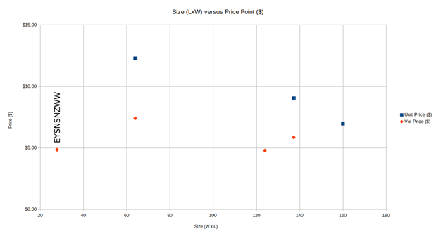

Taiyo Yuden are not the only manufacturer who use Nordic Semiconductor licensed wireless technology. In fact, Nordic Semiconductor provide a list of all the 3rd parties who use their chipsets. There are 74 3rd party modules listed for nRF52832 (although much fewer are generally available via distributors) and there are 12 listed for nRF52811 (although very few are generally available at the moment). As can be seen from the charts below the EYSHSNZWZ and the EYSNSNZWW modules are the smallest in the market and are also competitively priced for mass production purposes.
EYSHSNZWZ (nRF52832)EYSNSNZWW (nRF52811)
To demonstrate that the Taiyo Yuden EYSHSNZWZ (nRF52832) module really is the smallest SiP on the market, here it is next to the ON Semiconductor’s RSL10 SiP module, which would also be considered as a compact BLE module.

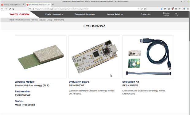

Using the URL give to us on the font side of the paper insert, we are then presented with the complete list, in tabular form, of the Taiyo Yuden’s Bluetooth product range. Linked to every product are two PDF documents (see last two columns in table), namely:
  • A Bluetooth low energy Module Overview (a generalised presentation of all modules available)
  • A module specific “Data Report” which provides you with a detail product specification
If we scroll down the webpage we will see all the Evaluation Boards listed. Alternatively, we can click on the link provided in the product listing (3rd last column), which will take us to the specific product page for the module (as shown below).
On this page we have a listing of all the PDF documentation, which includes user manuals and test reports, and there are also some ready made sample applications available (i.e. a DFU and a Mesh sample application – note that these sample apps were not tested in this review).
The document I found useful to get started with is the PDF document titled "Evaluation Board/Kit Manual". Within this document we are presented with a schematic for the Evaluation Board, a board layout diagrame and a table for the GPIO pin names.
