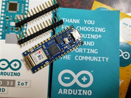

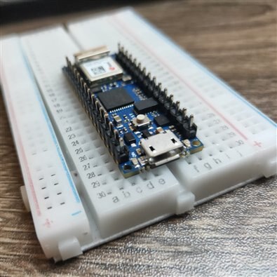

The Arduino Nano 33 IOT strikingly resembles the Arduino Nano 33 Every in make and form-factor. Unlike the regular Nano, the Nano 33 IoT (like the Nano Every) has no components or obtrusive soldering on the underside, making it suitable to be used flush on breadboards, stripboards, and even can directly soldered to projects.  Markings for the pins, like the Nano Every, are on the underside of the board, so make sure to note them down or refer the manual when building a project.
The flat bottom is excellent for rapid testing and prototyping -just pin it down onto a breadboard with the header pins and you are good to go. No soldering hassles. I had no patience (and did not want to mark the pretty board) so I did not solder the pins -and the flat bottom design is a godsend for such situations. It gave me a convenient 'plug and play' option.                image
Despite the similar form factor, Nano 33 is much more powerful than the Nano and Every, thanks to the SAMD21 Cortex M0 MCU on board, which is more capable than the 8-bit ATMega4809 in the Nano. The SAMD21 also has a built in USB port, eliminating any external peripherals for USB-to-Serial conversion. Functionality wise, the Nano 33 IoT is more or less an Arduino MKR WiFi 1010 (without the charger shield) in a tinier footprint. We will look into the other features of the Nano 33 IoT in the further sections.
Out of the box, you'll get the Arduino Nano 33 IoT, two rows of header pins, some paperwork, and a file of cool stickers. (Kudos to UPS for a top notch delivery service.)image

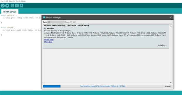

i) Configuring the Arduino IDE to use the Nano 33 IOT:
Since the 33 IoT uses a SAMD MCU, the same must be configured into your Arduino IDE to program the board.
Go to Tools > Board > Board Manager, and search for 'Arduino SAMD Boards' (or just type Nano 33 IoT if you are lazy like me), and install the correct package:image
Once the correct package is installed, you can check it by going to Tools > Board > Arduino SAMD and select the Arduino Nano 33 IoT:
Select the correct serial COM Port, and check the connectivity by uploading the 'Blink' sketch from the example sketches provided. Arduino Nano 33 IOT also uses a regular USB (2.0), so the USB wire from your phone charger should work just fine.
