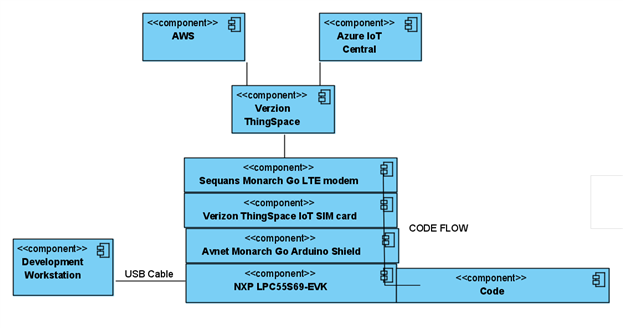

Quick start card Getting Started
The Kit includes these 3 Hardware components
Component ListDiagram
Layer Block Diagram
  1. NXP LPC55S69-EVK
  2. Avnet Monarch Go Arduino Shield
  3. Sequans Monarch Go LTE modem
    • Verizon ThingSpace IoT SIM card (comes preinstalled on the modem)

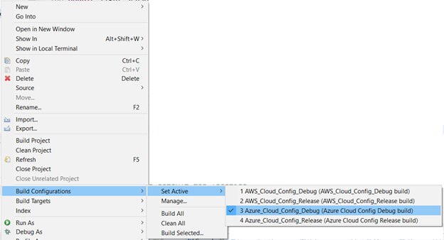

Before you build
the Demo project it's important to perform the following task. I missed this and spent a considerable amount of time trying to Debug the demo.
        • It is very important to the configure endpoint in your code before the build, so that Azure IoT can identify your device. If you get this wrong, no data will appear in your IoT Central dashboard. You will need to do this if and when you create a new IoT Central Device
        • It is critically important that the active build configuration be set correctly! before the build, otherwise the incorrect project will be built. You'll need to set the Azure (Debug) project not the AWS project.
