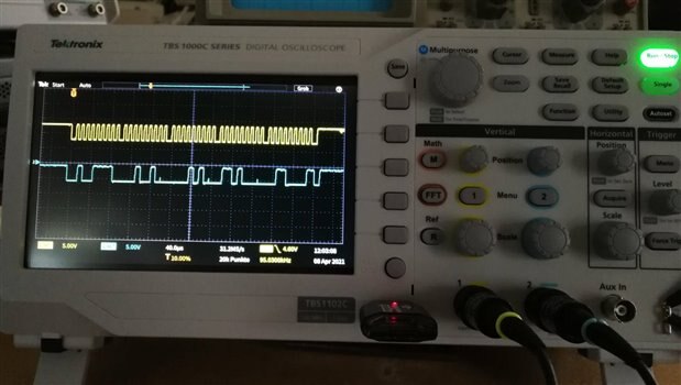

1st measurement with the TBS1102C
TBS1102C_ starting the1st measurement (the probes were adjust before)
All of them worked well.
Application:

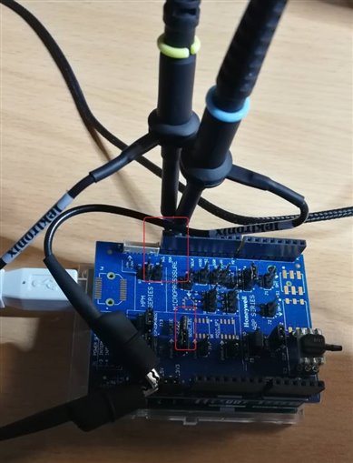

For the application, I used the oscilloscope's test signal and two development boards for simple tests.
On the Microchip Curiosity-HPC I used the PWM generator and on the click board I simply used the 12MHz oscillator.
With the UNO and the Honeywell board I used the humidity sensor with it's I2C port.
This was enough for showing the applications with the TBS1102.

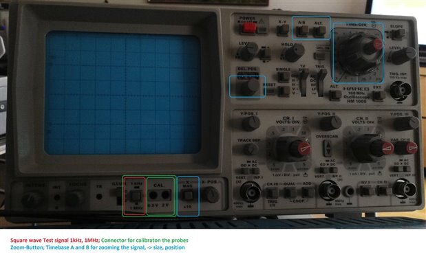

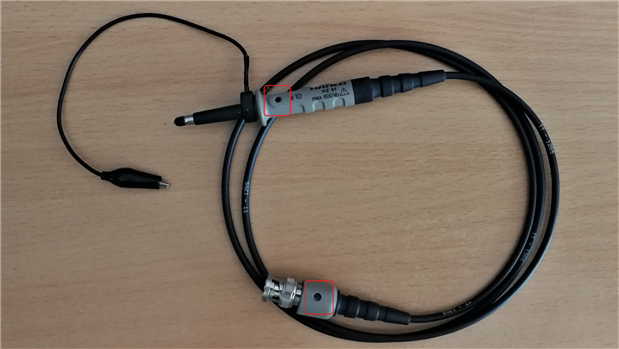

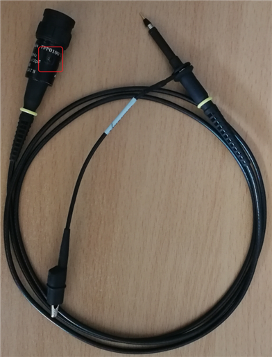

Adjust the probes:
Since each device has its own impedance, nominal 50 Ohm, the probes must be adjusted on the built-in trimmers before use.
The TPP0100 probe reaches up to 100MHz and the BNC connector has a C-trimmer for setting the signal edges of a square wave signal.
As a comparison, I still used my old Hameg O-Scope and used its probe HZ51.
This probe, it reaches up to 150MHz, has two setting options.  The first is at the measuring tip, there is set for the LF edge.
The second is at the BNC connector, there is set for the HF edge (the corners of the square-wave signals will fine-tuned; if wrong adjusting also the amplitude will be manipulated).
More details can be found in the manual and in the help menu.
  TPP0100 - HZ51 Hameg HM1503 used for compensating the impedances of the probes and used for comparing the zoom functions.imageimageimage
How to compensating the impedance of the probes.
Compensation the probe properties to the scope is a standard exercise and always necessary. Finished.
The point I see here is that the test signal terminals are open and could be shorted.
- We know that current/voltage sources should always be designed as a socket.
Here with the TBS1102C, in contrast to the other devices, also from Tektronix devices.
As can be seen in comparison to the Hameg HM1503, these sockets are used, and the advantage is
that the shield line terminates directly at the probe tip and not with a loop wire, which affects the impedance in detail.
The second thought is, as can be seen in the comparison between the probes TPP0100 and HZ51:
The HZ51 has two setting options so that the square edges can be adjusted more precisely,
which is important for the HF setting (as can be seen when switching the test signal from 1kHz to 1MHz).
This is also a point I would like for the TBS1102C - a switchable square wave test signal.
Well, the compensation option for the TPP is in the BNC connector, which makes it easier -
"simply because the cable on the test object is an" extension "of the signal wire".
However, the probe cable always has a different impedance than the test object and it must therefore be adapted.
So I see the advantage of two to three setting options on the probe cable, which is also done with the corresponding
Tektronix HF probes in order to really reduce the repercussions of the supply cable, regardless of whether the measurement is low or high frequency.
So I would like to see at least two setting options for a 100MHz cable.

Application with the Arduino UNO and the Honeywell sensor shield with the humidity sensor
For the next measurements I used the serial interface with the I2C protocol.
The period, burst and RUNT trigger have been examined for these measurements.

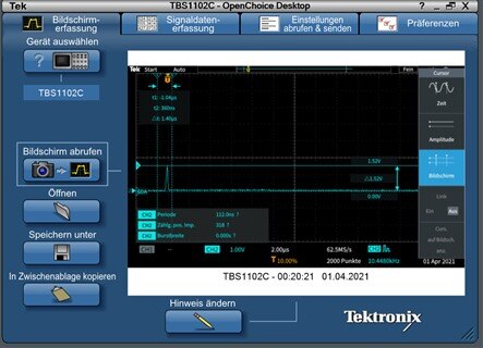

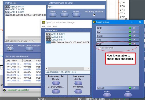

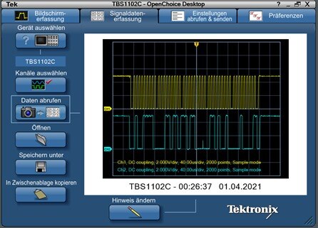

I also used the Tektronix software OpenChoiceDesktop Appliction (TDSPCS1), Kickstart and TekScope.
TBS1102C_I2C_Burst
TBS1102C_I2C_Periode-Burst:
I2C - RUNT trigger:
Software:
Tektronix offers fine, powerful analysis software for the TBS1102C.
These can be downloaded from this website:
https://de.tek.com/search?keywords=TBS1102C&type[0]=type:software
Tek - OpenChoiceDesktop Appliction (TDSPCS1):
Device selector image
"RUNT trigger" / image storingimage
"I2C protocol" / dataset storing image
This software work so far well. But it needs a lot of PC CPU time resources, so about over 20%. Hm... it is a fine image of the front-end, real view of the buttons, may be....

Now after I checked once more the USB also the software TekScope as well as the TekView it looks that the USB connection seems stabile.
One of the possible points. what is to do:
Close all active programs and unplug all unnecessary USB devices from the PC during installing the TekView and the TekScope.
Yesterday I disconnected the Arduino UNO and the TBS1102C from the USB, then I restarted the computer. The keyboard and the mouse stayed connected.
After that I checked the TekView - and yes, then it was possible to check the USB checkbox in the menu item "Search Criteria" .
And then I reconnected the o-scope and the Arduino UNO to the PC and well, all the time until now the USB stayed stabile; no more was breaking the connection.image
TekScope - aquire was succesful

    https://www.tek.com/software/tekscope-pc-analysis-software
    This TekScope can do nothing! Not really. This is my opinion.
    It is a picture book display software. It looks beautiful, and then?
    Measurements are made with the measuring device, but analysis should also be done with the device, not with such software.
    Real-time measurements are very delicate. How long has it been possible to transmit a dynamic process in real time via a USB interface over several meters of cable? Does not work at all!
    I have real problems with the acquisition and readout of the triggered HEX data that run via the target interface I2C.
    Every second the Arduino UNO asks the sensor for 5 data packets, 1 address and 4 data. These data of this humidity sensor are constantly changing, so the oscilloscope cannot freeze them.
    And then I randomly ask for this data with the push on a button. The connection is already hanging because something has changed between two query events. Therefore, even on the PC, which is several meters away, it is not possible to continuously query via USB. It just has to crash.
    Then the PC itself has to do a lot of tasks before that fetched data will be printed on screen.
    That is the problem what I see here.
    Of course, I may be wrong, because I am not Tektronix, nor did I develop this software. Tektronix sure knows why they do this.
    My mind, this software can only used for remote control and checking from time to time once a day or so, looking for if all is right. Or if you have to document something.

    Yesterday I found a possible "bug" - problematic point - (is always forgotten).
    During the installation you have to disconnect the unnecessary USB devices from the PC.
    Even then, before the installation, you should clean up the PC as far as possible, e.g. delete the temporary stuck files, and so on.
    Perhaps best to do after restarting the PC, because then the programs are more or less in their basic position.
    Not every PC is used in a variety of ways. PCs with many applications, for example development environments, that access the same resources would be more problematic.
    But one point:
    Every time the TekScope overwrites the settings in the TBS1102C with values that are stored in the TekScope by default but are not compatible with the TBS1000 series.
    For example that where values for a GHz oscilloscope; giga samples or so by default. Also the probes by default are 1GHz probes.
    - or the horizontal time: the TBS needs 1, 2, 4, 10; and so on... the TekScope does switch to other values per default.
    So my suggestion is that beginners in particular should help:
    When I choose a device like this TBS1000 series, it would be nice if I could already choose the device from a list of supported devices by default. The parameters for this device would then apply and match.
    It is difficult for beginners to program from the beginning after installing the software.
    If you already have such great software, it certainly isn't a big deal to include such a list of devices.
    Querying the data via the USB connection is not easy, however, since this does not take place in real time, since the data packet keeps failing and a complete data packet was not always transmitted. Sometimes worked probably sometimes did not.
    With this settings works mostly (not but all acquire):
