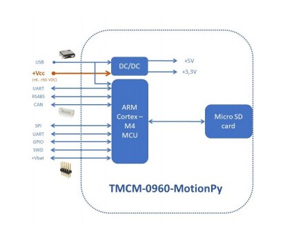

Some of the major highlights with this kit are that the MotionPy board is a single-board computer running MicroPython which opens up possibilities for quick prototyping and control. The board comes with multiple serial interfacing options like UART, RS485, and CAN. The SD card option helps in loading large firmware and also in logging the motor data/parameters directly from the TMCL motion control IDE for analysis and further processing. The coolest feature is with the smart stepper motor which interfaces with the MotionPy board via CAN protocol and provides tonnes of interesting control and live monitoring features which really excited me to go for this RoadTest. It's a simple example of what can be done to a normal NEMA17 stepper motor by adding a magical module in hardware and tonnes of smart processing with the software.

The MotionPy board came with MicroPython pre-loaded and could directly be used by scripting on main.py to toggle GPIOs and control with pushbuttons. It uses an STM32F405 microcontroller onboard, having SD card, USB and serial interfaces. The set of default files included a pybcdc.inf windows device driver file.

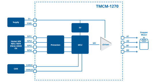

Yikes, now it's time to have the beast on stage. Introducing PD42-1-1270 smart stepper motor. The front part of it is a generic NEMA17 stepper motor and the TMCM-1270 addon module is what makes it smart! The 4 wires A1/A2/B1/B2 comes from the motor coils and is plugged into the TMCM-1270 module. It houses a powerful TMC5130A motor driver with all fancy motion control features interfaced via SPI bus to NXP's ARM® Cortex®-M0+ Kinetis KE06 MKE06Z128V microcontroller having CAN interface. Why this NXP MCU here? Aww,.. I dont know.
The 100ohm resistors with the onboard LEDs made them too bright to bear with and were blinding me out,......haha. Replaced those with 1.2K.
In this setup, I will use the TMCM-0960-MotionPy board as a TMCL bridge for linking the PD42-1270 motor with my PC. The MotionPy board has a TJA1051 CAN transceiver which connects to the two-wire CAN interface in the STM32 microcontroller. The other side, on the motor, the NXP MKE06Z128V microcontroller hosts the CAN port.
Setting this up and invoking the tmcl_bridge/tmcl_bridge_usb_can.py script should get the MotionPy board's CAN interface bridged to PC via USB and the TMCL-IDE should be able to recognize both the hardware interfaced via respective serial COM port. In the same serial terminal which starts the Python command line, invoke this script:
