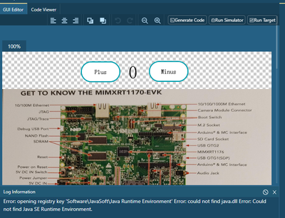

Experiment 3 - littlevgl_guider_cm7
Using NXP GUI Guider -- An HMI Editor
  • For this experiment you will need to have the FREE NXP Software Tool "GuiGuider ", Which you download from here Download GUI Guider
  • Here is the user guide and a great page and video Getting Started with GUI Guider which I followed and was very helpful getting my experiments running.
  • After downloading and installing GUI Guider I ran through the video on the getting started page. I did have a few problems but with the help of the NXP Forum and the User manual I was able to get me through it through it
  • The video  Getting Started with GUI Guider example takes you through
    • Using the editor to design your HMI GUI,
    • Running a simulator on your workstation,
    • Testing your design directly to the board,
    • Generating you code right to your sdk project. so you BUILD and Debug in MCUXpresso

The first problem ...
      • I ran into was, I did not have the JAVA runtime installed
        • I was getting the following error when trying to generate code, run simulator,or run target
        • Error: opening registry key 'Software\Avast\Java Runtime Environment' Error: could not find java.ll Error: Could not find Java SE Runtime Environment.
My Solution
        • The JRE was missing and I only had the JDK installed. I should have read the GuiGuider User Guide... I am no longer getting the following error:
        • What I did to resolve this was to
          • 1) uninstall the 2 versions of the JDK as I wanted a fresh install.
            • I download the follow version.
            • And installed it. The install only installs the JRE because I don't need the JDK at the moment.
          • 3) I then added path "C:\Program Files\Java\jre1.8.0_291\bin" to the PATH System environment Variable.
          • 4) to test the installation from a command I ran the following java command , and it displayed the current version.
