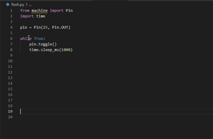

Once all are ready we can run the first program, which is the blynk led. The code and the output is shown in the figure below

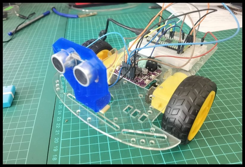

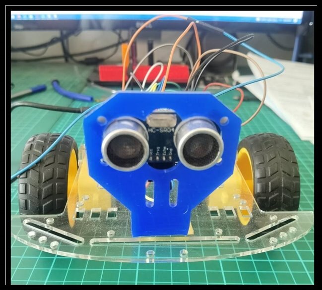

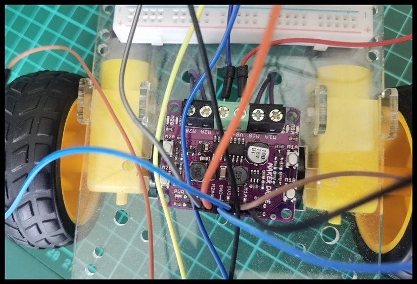

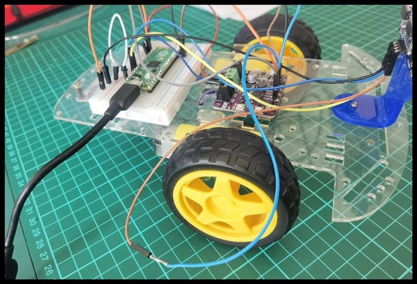

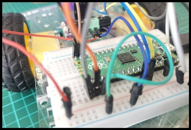

In this simple project, I have decided to make an obstacle avoidance robot. Basically, I have used the Pi Pico, Cytron motor driver, ultrasonic HC-SR04 sensor, and a power bank to power up the robot. The robot is constructed using a simple chassis and a breadboard for the wiring purpose. Below is a picture of the constructed robot.
