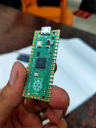

I received a big box from UPS containing the Raspberry Pi Pico for this Roadtest. After ripping through two boxes, I found my Raspberry Pi Pico -no boxes, no manuals, no neat sticker file to adore my laptop with (remember, I have been a long time Arduino user). Just the board, inside one of the files for the spool that Raspberry Pi ships them into to vendors. This lack of anything other than just the board is a little disappointing, at least to me. I know the price is reasonably low, but including header pins would have made this a really comfortable device.
                                                                                                              The Pico arrives in a file from a larger spool. No fancy packaging.
                                                                                                                                                            The familiar flat-bottom design of the Pico.image
And right off the bat, I was greeted with a familiar design. Flat bottom –no protrusions at all. Very reminiscent of the Arduino Nano IoT that I recently reviewed. But the two couldn't be any more different, and we'll discuss about it later.
