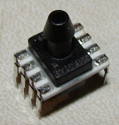

The sensors are packaged in a nice clean hard plastic shell that provides good protection during shipment.  The sensors themselves look and feel sturdy and appear to be able to handle small vibrations and shock.  There are a wide verity of mounting and tube connection types as well as 3.3 or 5 volts. They are available in Analog, I2C, or SPI digital communication.
Both sensors I looked at use the SPI Bus for communications and are 5 volts powered. Note that I was not familiar with the SPI bus before this evaluation, I thought I had requested the I2C versions – but that’s OK. I learned something new as well.

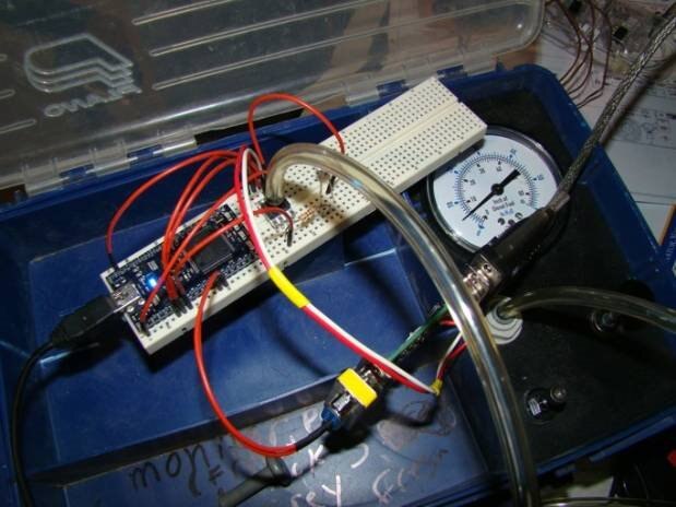

After spending a few hours gathering the needed information about how to program the needed SPI interface, I constructed a small test bed to test the sensors.
Basic Layout:
This image shows the Sensor connected to my small hand pump and analog mechanical gauge. This allows me to slowly apply pressure to the sensor and I can verify the pressure with the gauge against the sensor. The LED allows me to verify that the device is being selected, as the SS line goes low when reading data from the device.

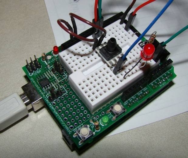

Arduino Hook up
At this point I have to admit that my evaluation failed. The reason for this is unclear but I could not get the device to produce the proper information. This might be due to the fact that I’m too unfamiliar with the SPI interface, or possibly I am missing a key bit of information about the Honeywell SPI interface. I spent several hours talking to others and discussing the data and programming on other forums and after trying several things, everyone has run out of Ideas.
I want to post my results here for anyone else thinking about using these sensors so they can see everything that I have tried. Hopefully Someone here (or possibly from Honeywell) can spot the problem. Most likely I am missing something in the hookup or programming and the device operates just fine.

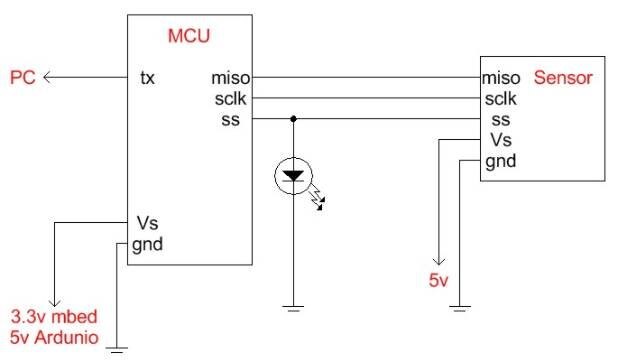

One issue I thought sure was the problem was the fact that the mbed MPU is 3.3 volts and possibly was not putting the proper voltage on the SCLK line. This is why I switched over to the Ardunio MPU. This uses 5 volts instead and should produce the needed 4 volts on the SCLK line – However as you will see the results were the same.

    I just came across your review and read it as I am looking into the arduino platform and have a background in pressure sensors, although most are analog ones that I have used. That being said I noticed a couple of things that I hope might help.
    First, are you sure the SPI phase and clock polarity are correct? Usually when I observe the same data, over and over, it is usually related to clock and data phase settings not being correct. I noticed in your arduino code you don't specifically call out a function to set this up. Perhaps the defaults are OK as I mentioned, I'm looking into the arduino platform but actually have never used it.  I have used lots of SPI devices in the past however. The on line doc's don't mention what the default would be so I would assume it's the chips default state.
    In looking at the (sensor) datasheet, and I hate datasheets that aren't clear, it would appear you would need to set the SPI to mode 3. The datasheet mentions, " ... that data on the MISO line will transition during the falling edge of clock pulses. This means that the data on MISO should be sampled by the master device during the rising edge of the clock pulse."   This could be either Mode 1 or Mode 3 depending on if the initial bit is placed on the MISO line when the SS drops. The diagram ("
    Figure 2. Example of a 1 Byte SPI Data Transfer with Honeywell Pressure Sensors") shows a low clock when initiating, and a high clock when completeing which is the 'clarity' issue I mentioned in the beginning.  From the wording, I would try Mode 3 and see if your data changes and reflects a more accurate picture.
    <comment> In your data, you mentioned temperature is 'close',  but have you tried heating the sensor to see if your data changes? I would expect even a warming with the touch of your finger should show a change in your data. If it does not, then I expect the SPI phase/mode is not correct </comment>
    So, lets assume for a moment that your raw SPI data *is* correct. I think your calculation assumes a 14 bit part per the Honeywell SPI doc you linked to, and further, you assume ideal 0 -100% measurement in your calculation. To go one step further, the part datasheet link you included actually specifies a 12 bit part and therefore I think your data calc should be a bit different ...
    Outputmax = 3686 counts (90% of 2^12 counts or 0xE66)
    Outputmin = 409 counts (10% of 2^12 counts or 0x199)
    Pressuremax = 5 psi
    Pressuremin = 0 psi
    Pressure = pressure in psi
    Output = 1668 counts (from your data listed above  0x684)
    should yield a pressure of ....  p = ((1668-409)*5) / (3686-409) = 1.921 which is quite different than your printed pressure.
    My final comment would be that the device datasheet appears to say that the device will work with either 3.3 or 5 V and I would expect the sensor to respond to either voltage. You mentioned your data was the same, and this I would expect if the device operates at both voltages.
