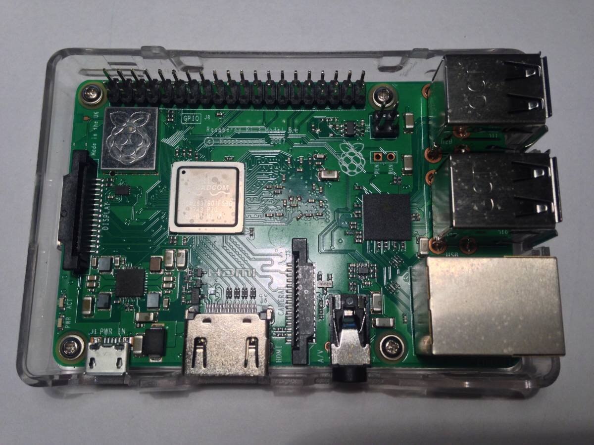

The first thought that comes to mind is the question of differences with the previous model.
At first glance I noticed two metal coated chips
Broadcom  BCM2837 instead of plastic package appear in the metal now.
Another metal object with full -size raspberry icon embossed on it is screening shield covered wireless device: IEEE 802.11.b/g/n/ac wireless LAN 2.4GHz & 5GHz integrated with Bluetooth 4.2, BLE
The ceramic chip antenna is replaced by resonant PCB one now.
The big change is replacement of LAN9514 with LAN7515 contained 10/100/1000 Ethernet and USB 2.0 hub.
There must be impart the new module is Power-over-Ethernet (PoE) - ready.

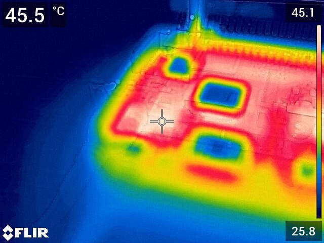

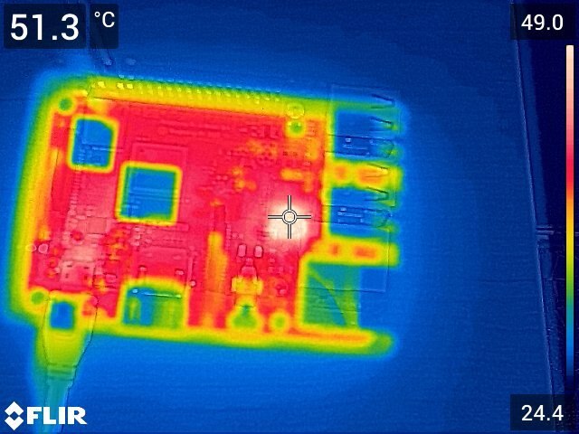

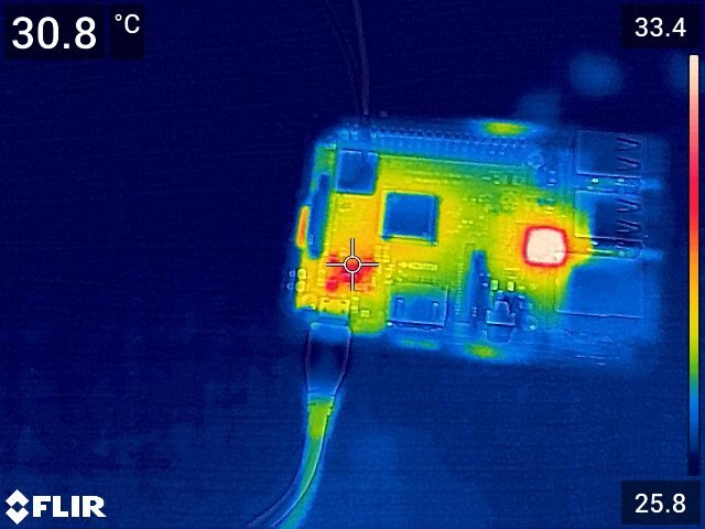

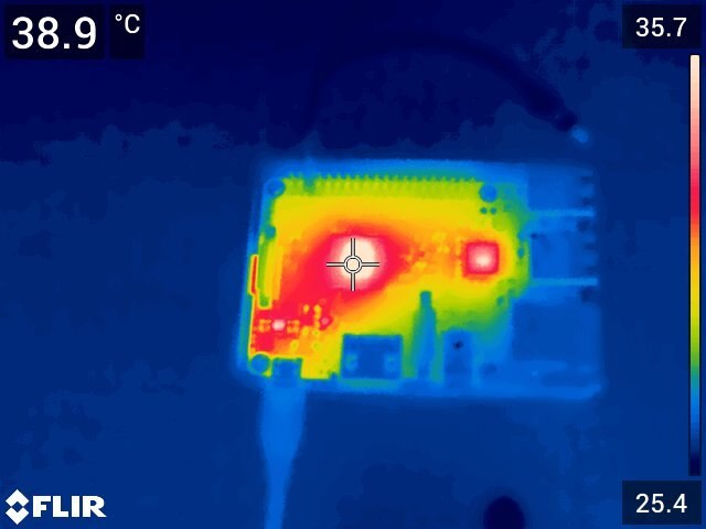

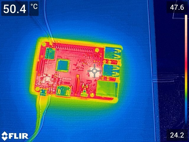

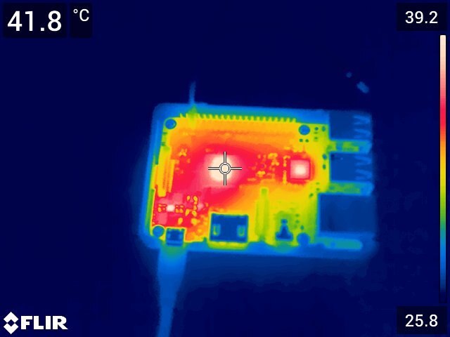

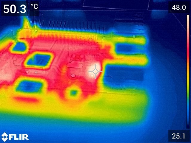

Thermal issue
As declared in my application I conducted some comparison tests with previous RPi model.
The first most interesting question was check of the energy dissipation issues and working temperature.
With precise Flir thermovision equipment that task was quite simple but instructive
first - take look at Raspberry 3B model:
warming up few seconds after start.
3 seconds later:
and after half an hour of normal work
focused not perfect but larger picture
here the measurement of the temperature of the USB module:
and supply conditioning area:

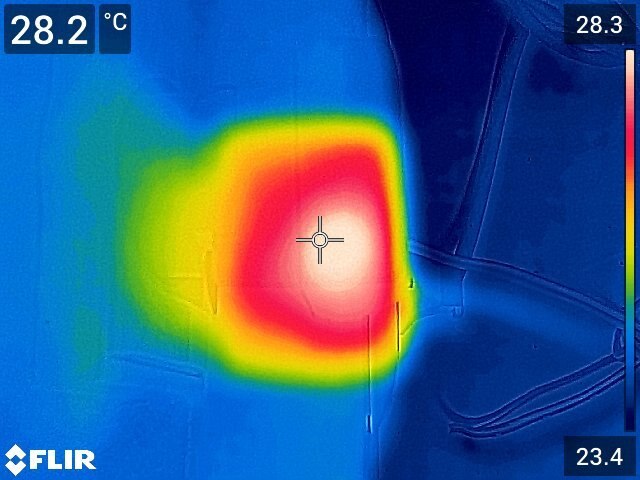

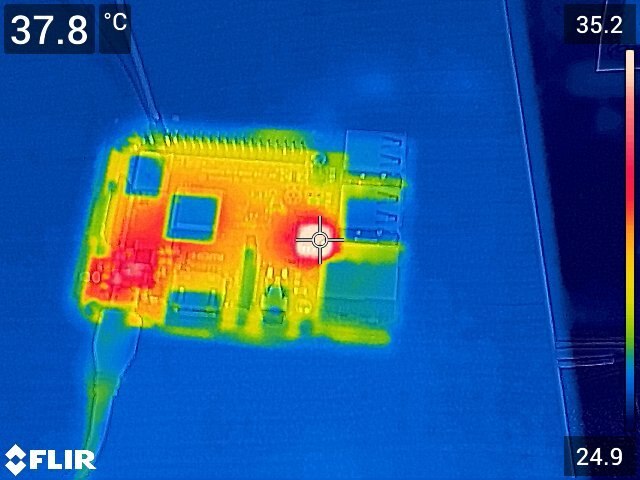

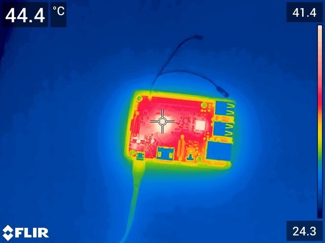

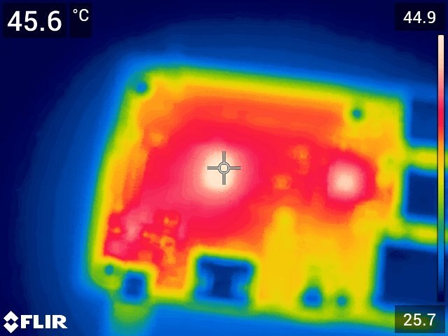

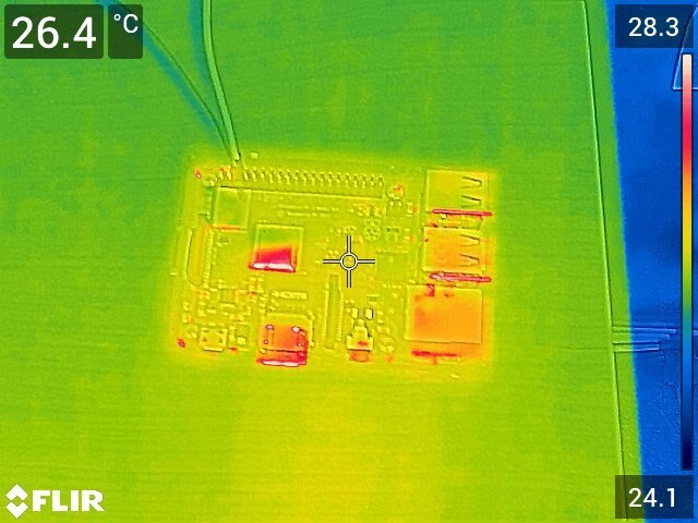

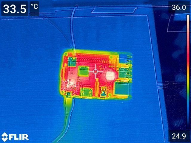

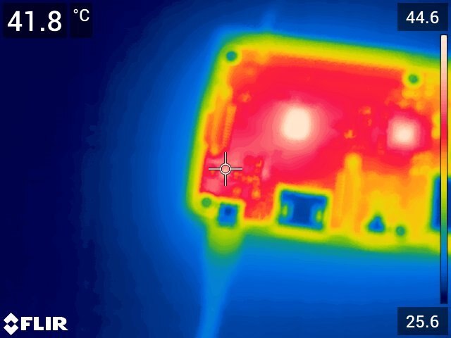

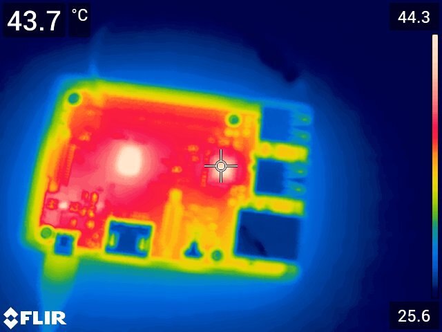

now hot photos of our new Raspberry:
unpowered RPi3B+ below:
and just after the start
module:
temperature groth 1 sec later:
10 min:
20 min
supply unit:
Now let me summarize above pictures in short words.
First I must inform, that measurements were taken with open cover. (the bottom base remained)
At average work conditions there are no significant difference in heat transfer in the board and temperature levels. Nevertheless model+ looks few degrees warmer.
(is that the reason for this sign?image)
You can see the problem with catch the real temperature of metal covers of chips. Shiny surfaces are nightmare for thermography.
On the other hand, such cover ensure better radiation as well as heat transfer (dissipation) at all
