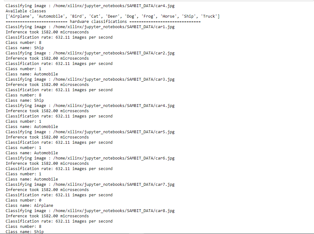

Okay, so element14 gave me a Pynq Z2 and I tried running some simple applications on it to see what is all the hype about.
1) CIFAR 10 using pre-trained binary neural networks - I use my own images and change the code a little to see performance comparison between hardware accelerated inference and software inference:

Here is the output:
Problems:
1) As you can see in the code:
        im_name = '/home/xilinx/jupyter_notebooks/SAMBIT_DATA/car' + str(i) + '.jpg'
        print("Classifying image : {0}".format(im_name))

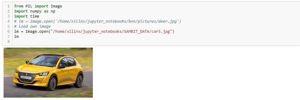

        im = Image.open(im_name)
        im
I expected this to first show the image that I am classifying and then show classifcation result. But, the images are not displayed.
The code seems to be correct since it is just an adaptation of:
This works, but in the loop, it does not.
2) The accuracy is just above 50%, as can be seen in the output, only 4 images were classified correctly out of 9 (the last output is not visible here).
