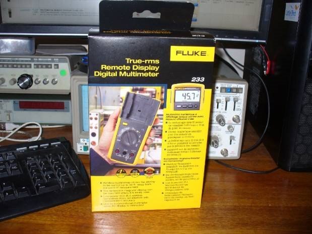

Upon opening the shipping box from Farnell UK the bright and detailed Fluke packaging stood out nicely:
Made in the USA. First class. Another solid Fluke design, clean lines, and a great fit and finish. Futhermore it is of a good weight, so you could always bang in a nail with it, or the pointy-head boss. The exterior has the rubber-moulded housing which is not removable, however this would be recommended for the target market - this would be more of a field work than a test-bench instrument. However, if you do sit it on the bench with the tilting bail, you can still operate it with one hand as it has enough friction to stay put. It is also good to see that the box and packaging are cardboard which is easily recycled.

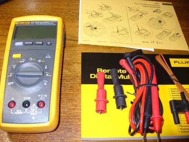

The contents of the box are as follows:
  • The meter itself
  • a long (~1.2m) pair of Cat IV leads with very sharp points
  • matching insulated alligator clip adaptors
  • a K-type thermocouple
  • a printed Getting Started manual, and the complete manual on CDROM
  • a single, universal getting started sheet - explains how to remove battery isolation tabs
  • No case! I was expecting one, for an Au$550+tax meter.

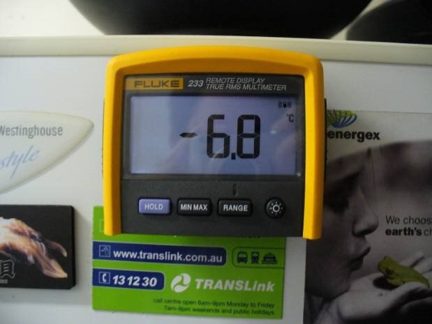

As others have said, if you have one of these meters the manual isn't necessary apart from checking the specifications, and the same applied to myself. Thankfully the meter is supplied and fitted with 5 x AA Duracell alkaline cells, three in the meter body and two in the display unit. After flicking the meter on the first thing to do was remove the display, plug in the thermocouple, and toss the body into the freezer:
Even with the meter in the freezer, I could still move the display around 1.5 meters away and it still received the data signal. Notice how the display is on the freezer door - it is magnetic. Immediately the benefits of the remote display come to mind. You can always have the display right where you want it, and the meter where it needs to be... it's win-win. After showing it to my auto-electrician friend, she didn't want to give it back. The ability to set up a meter in a less than perfectly safe environment and take the display away is almost priceless. Furthermore, the backlight is a nice even blueish colour, and times out after around forty seconds.

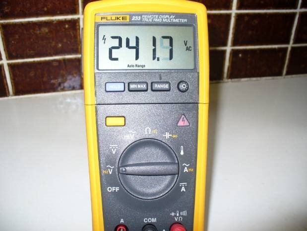

Using the meter in general is very simple, you can hold it in one hand and select all of the functions with your thumb. Having the yellow shift key makes changing between associated readings very simple, for example after reading AC voltage:

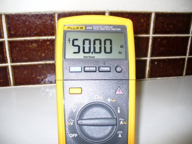

Pressing the shift key changes to frequency:

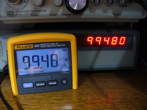

Even though the 233 specifications claim frequency is 50kHz, we got it up to just over 99 kHz:
