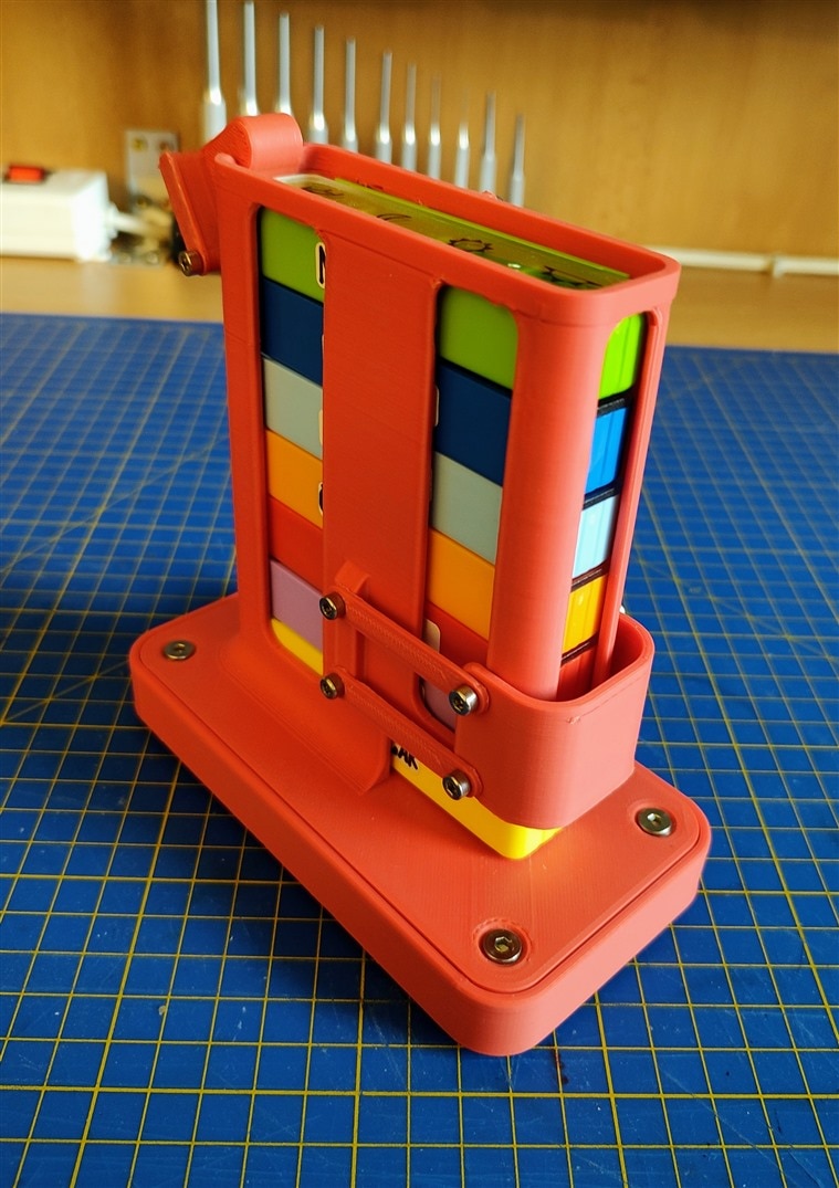

I wanted to have a box-like shape at the bottom that can be filled with something like sand to weigh it down, and I wanted the boxes to be stacked on top of each other where you can pull out a box for the day on the bottom of the carrier as it's shown in the picture. This would be a straightforward approach and it wouldn't have taken a lot of time to design and print, but seemed kinda boring. So I decided to keep this layout, but with a bit of a flair with a small 3D printed mechanism attached to the body of the carrier. My idea was to design a mechanism that would allow you to take out a medication box only when all of the boxes are inside the carrier and it would restrict you from taking another medication box if one is missing at the top. Sounded like a pretty fun challenge so I drew some designs and took some measurements, in the end, I ended up with this.
I designed the carrier first as I've described above, then started adding additional components. The mechanism works by having a small spring mechanism that puts the cover over the bottom medication box if there is a box missing at the top. Once you put the box back at the top, it activated a few levers through a pivot that lifts up the cover so you can take out your medication box. To demonstrate better how the mechanism works, here is a short animation.
The mechanism is designed to be used with small M3 screws that you can either try and screw in the plastic together so that they cut their own thread, or use a tap to cut a thread beforehand which is what I did so that there's a smaller chance of messing some of the parts up.
4. 3D Printing
With the design over it was time to print all of the parts on my Creality Ender 3 Pro. I printed all of the parts using PLA. Unfortunately, even though I try designing all of the parts without needing any support material, some of the parts here required a bit of support material, but nothing too much. All of the parts can fit on a single build plate of an Ender 3 Pro (220mm x 220mm).
The parts should be oriented on the build plate as shown above. The main body will need some support material and the upper arm on the left of the build plate as well. All of the other models can be printed without any support. If you wish to try out this model yourself, I've uploaded all of the 3D models, both STP and STL on GitHub and you can find them here: https://github.com/MilosRasic98/MedicationBoxStack. You are free to download and modify the files however you want, enjoy!
5. Testing
Now we come to the fun part of testing out the design! As mentioned above, to assemble this I needed to use a couple of short M3 screws. I could have just forced the screws into the plastic so that they cut their own threads, but decided to rather go the slower route and cut the threads first using a tap. There is a smaller chance of messing up a part, and considering that the main body, which needs a lot of tapped holes takes quite a bit of time to print, I didn't want to take any chances. Besides that, I also needed to use a small spring. I left a few holes for adjustments when it comes to this so that various springs can be used here. Here is what the final thing looks like!
I am thrilled with how it turned out! While it maybe isn't everyone's taste having a visible mechanism, it's what I love about it the most. The design process went surprisingly smooth and easy, I only had to redesign one part, the top arm that pushes against the top box, so it works a bit better. Everything else worked on the first go. As for how the mechanism performs, take a look at the videos!
The mechanism turned out extremely reliable and honestly, really fun to play with! I keep it at my desk and play around with it from time to time. I didn't even have to fill the base with sand/screws, it's pretty stable as it is with just a bit of movement when pulling out the boxes, they slide really easily one on top of each other. As for putting the box back in, it's just important to go from the front so that you push back the arm properly and it works every time. This is the reason why that arm is oriented on the print bed as shown above so that the box doesn't drag on the layer lines when it is pushed back in.
