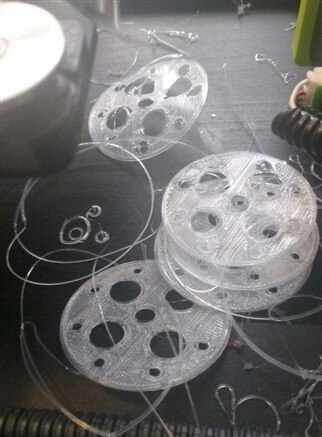

I have successfully printed out many things using PLA, including one last night.
Today I tried to speed the production up and cloned my article several times but it was soon apparent the first layer had roughed up, the head caught and other layers failed until two of the clones came away completely....I stopped the print.
I cleaned the bed, trying several things like pure spirit and washing up detergent. Still the print failed to stick. Bed temperature was 60 degrees C. I tried to slow the initial layer down but again it failed to stick on the initial run leaving a trail that snagged and ruined the later layers.

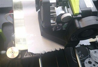

At this point I had a read online and there were solutions and glue sticks suggested. Not wanting to wait I decided to try something different. I taped a piece of plain printer paper to the bed and it appears to have accepted the first layer very well: no snags and the pattern looks great.
My question for discussion is, what could go wrong with this approach and why is this not a more generally used technique?

    dougw over 6 years ago +3
    What material is your bed made of?

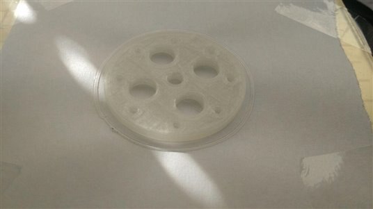

    It has finished printing and I can answer my own question. It looked great at the start and the end of printing:
    But as soon as I started to remove it from the paper I realised it wasn't right. The disc is warped as there is nothing to hold the paper down to the bed and restrain the cooling plastic image. Maybe I need some glue as suggested. I'm going to try a thin layer of PVA/water to see what that achieves.
    Actually for the intended purpose it will still be OK to use.
  • 14rhb
    14rhb over 6 years ago in reply to dougw
    Hi Douglas,
    It's glass with a slightly matt surface finish, and heated if that helps. The Lulzbot Mini from the Sixth Sense Challenge we both participated in image
    The watered down PVA (not PLA glue as I incorrectly mentioned above) seems to be working really well as we've been making bits all day here and the initial laydown seems good each time.
    Not sure what happened this morning when I posted this blog for help; I probably ended up getting grease on the bed.

    I use pure Isopropyl alcohol on mine and it works really well (btw, farmacy alcohol is kinda greasy/leaves residue, it doesn't work well). The trick for me is finding good paper napkins that don't leave any residue (I use Bounty and those are good, I even clean my glasses with those, no problems). I believe by judging at the pictures you might own a lulzbot, if that is so then your bed is PEI (I own a lulzbot mini), after some point that material gets spoiled. If cleaning with alcohol doesn't work, chances are you might need the following - it's from Lulzbot support:
    "There are a few ways to take care of this. The best way is to get a spray bottle and mix up 10% alcohol and 90% water. Get some 1200 - 2000 grit sandpaper. Get a sanding block.
    Spray some of the 10, 90 mixture on the bed (get it nice and wet). With the sandpaper on the sanding block, wet sand the entire bed until you see a slight whitish film, then stop. Clean the bed good using the same mixture with a clean cloth.
    This process will last a good while. I know this sounds a little strange but it does work really well."
